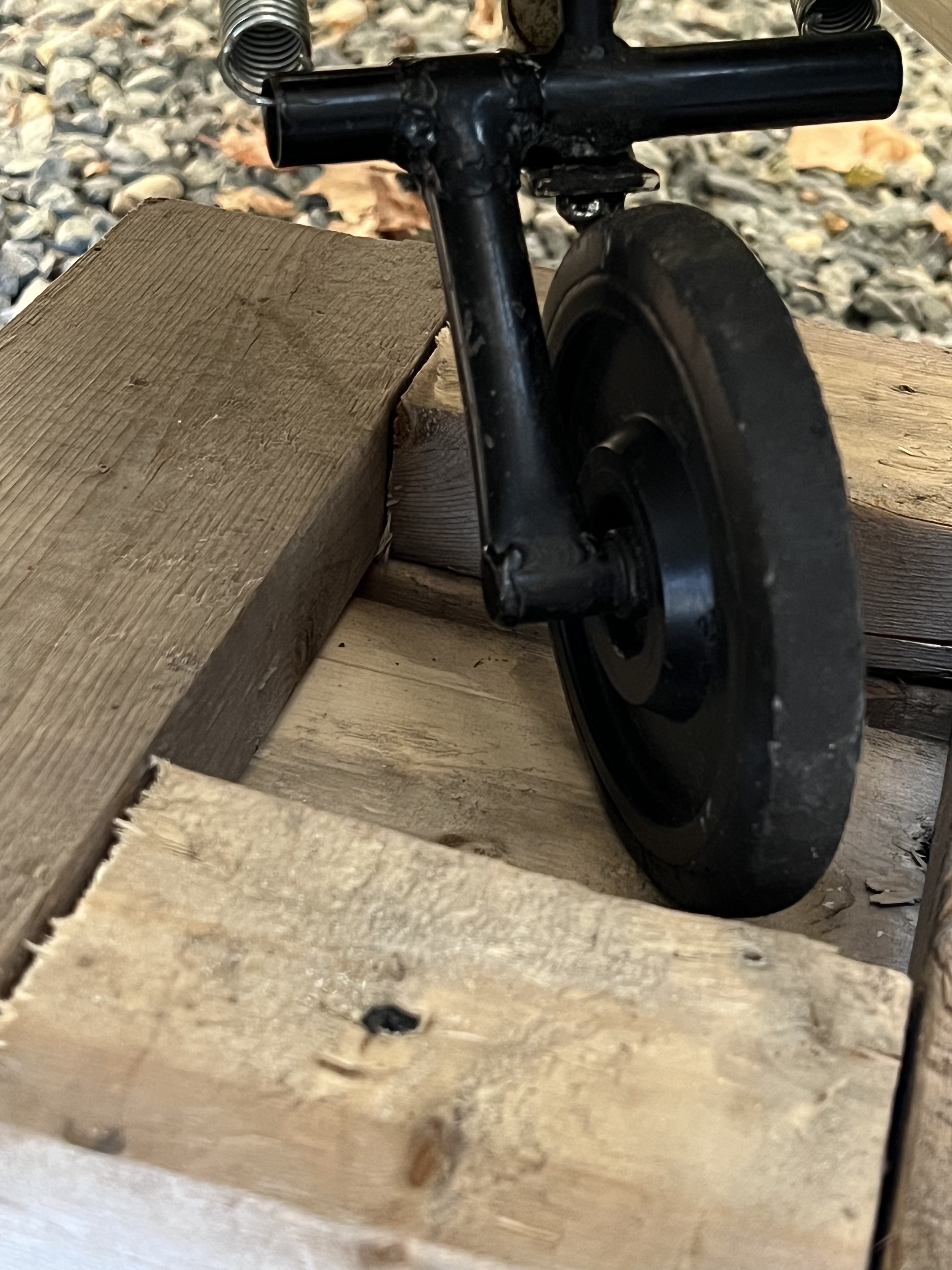

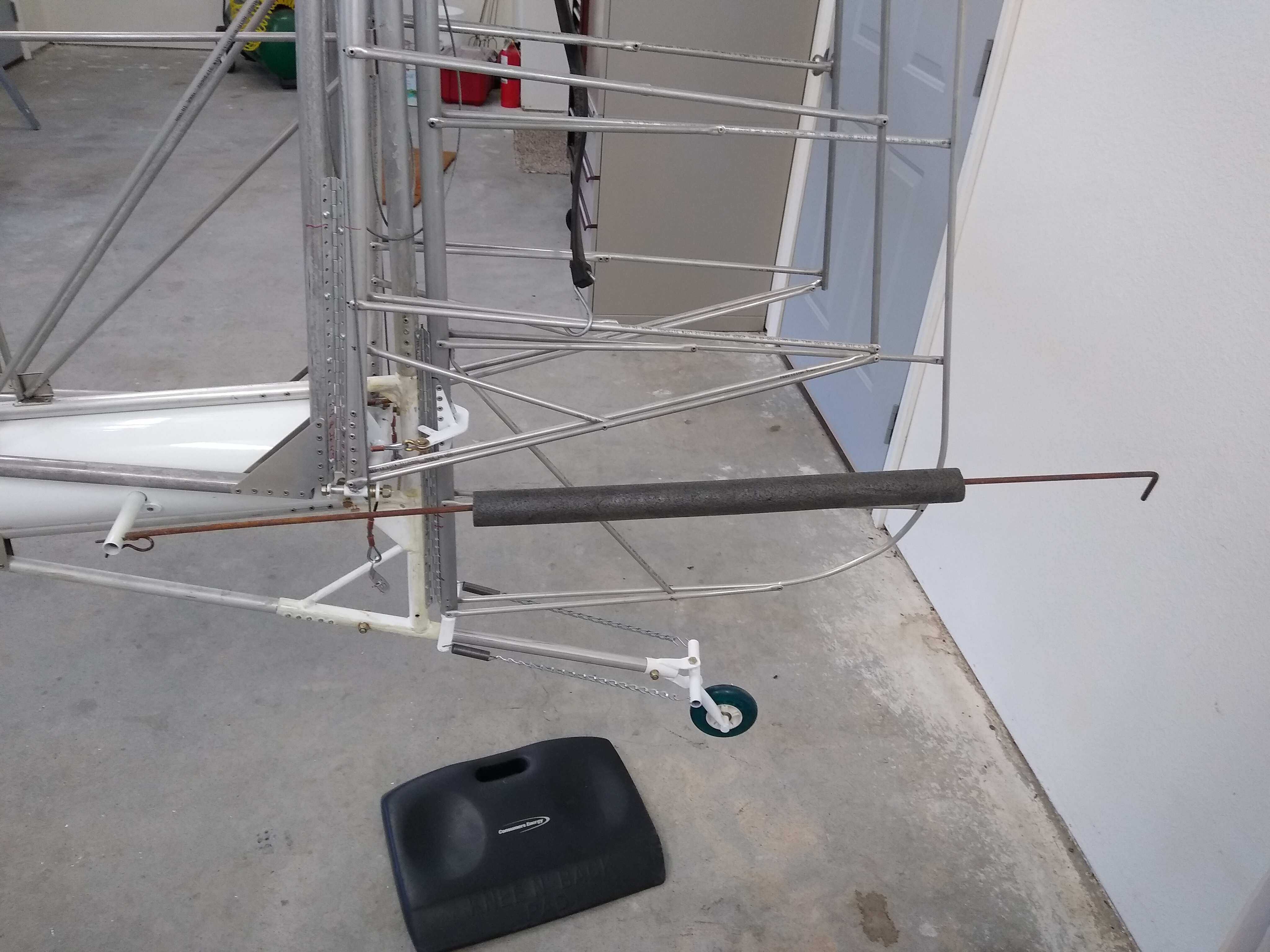

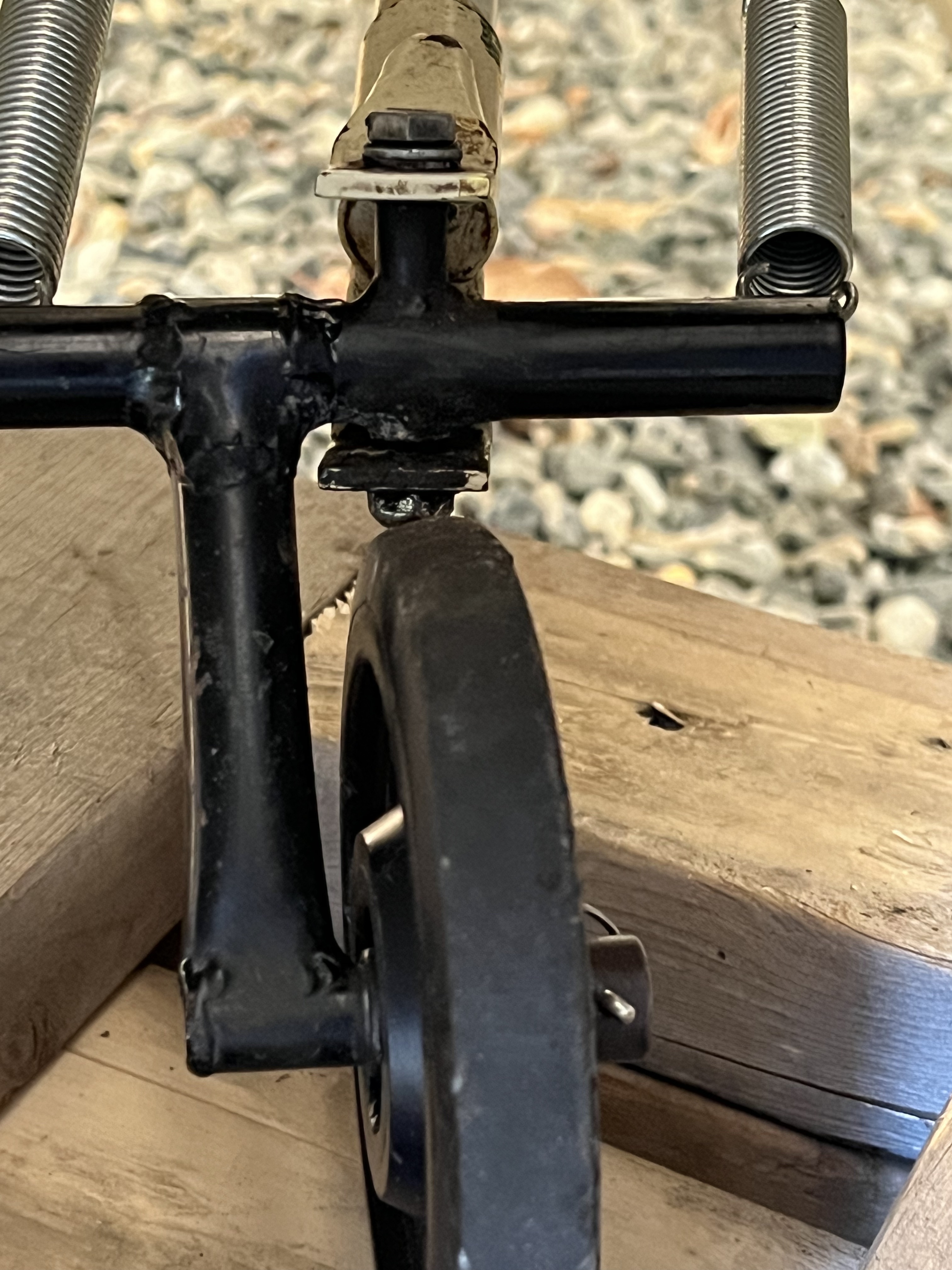

PostPosted: Mon Dec 19, 2022 10:25 am    Post subject: Re: Firestar KXP Reply with quote

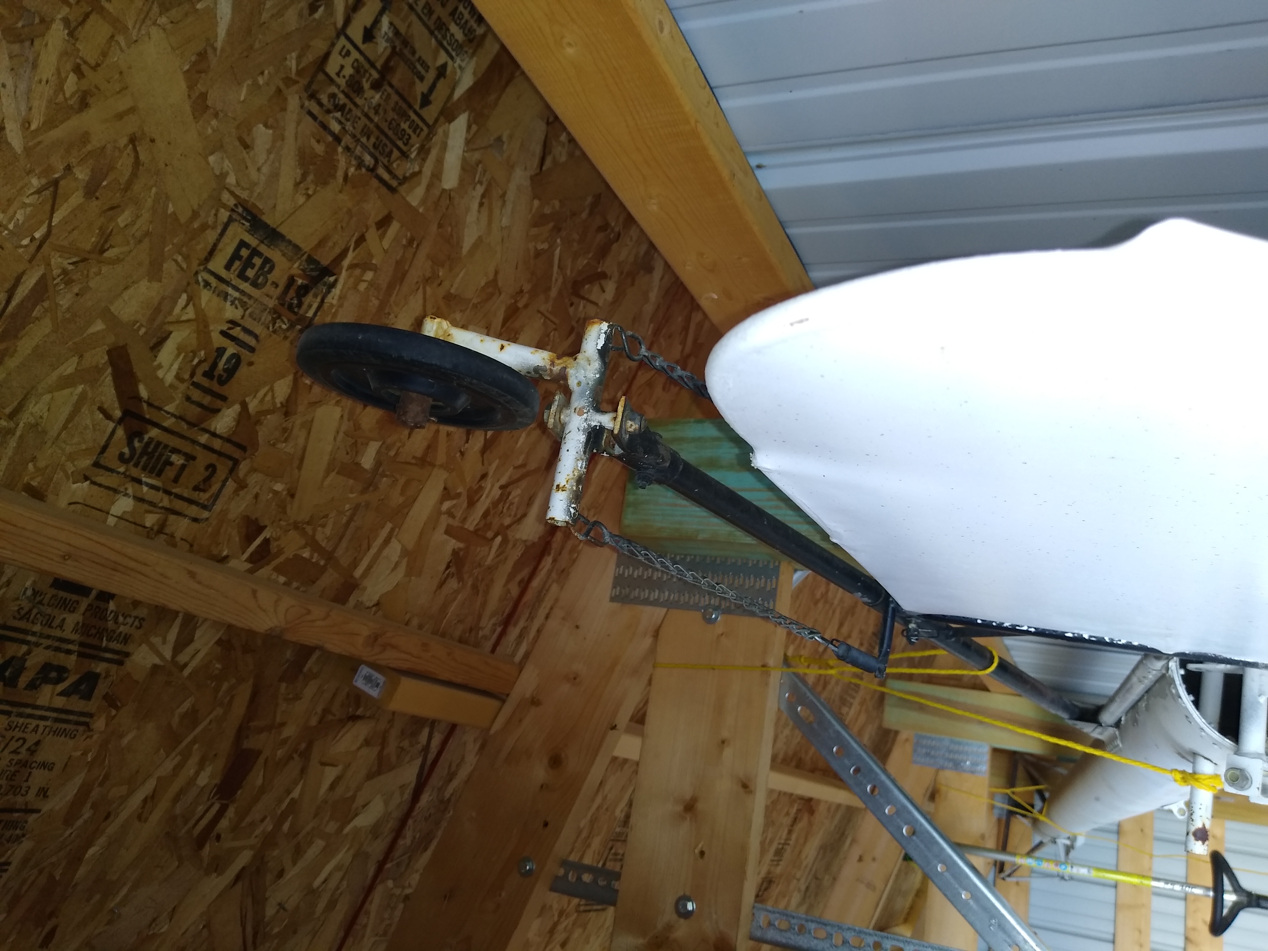

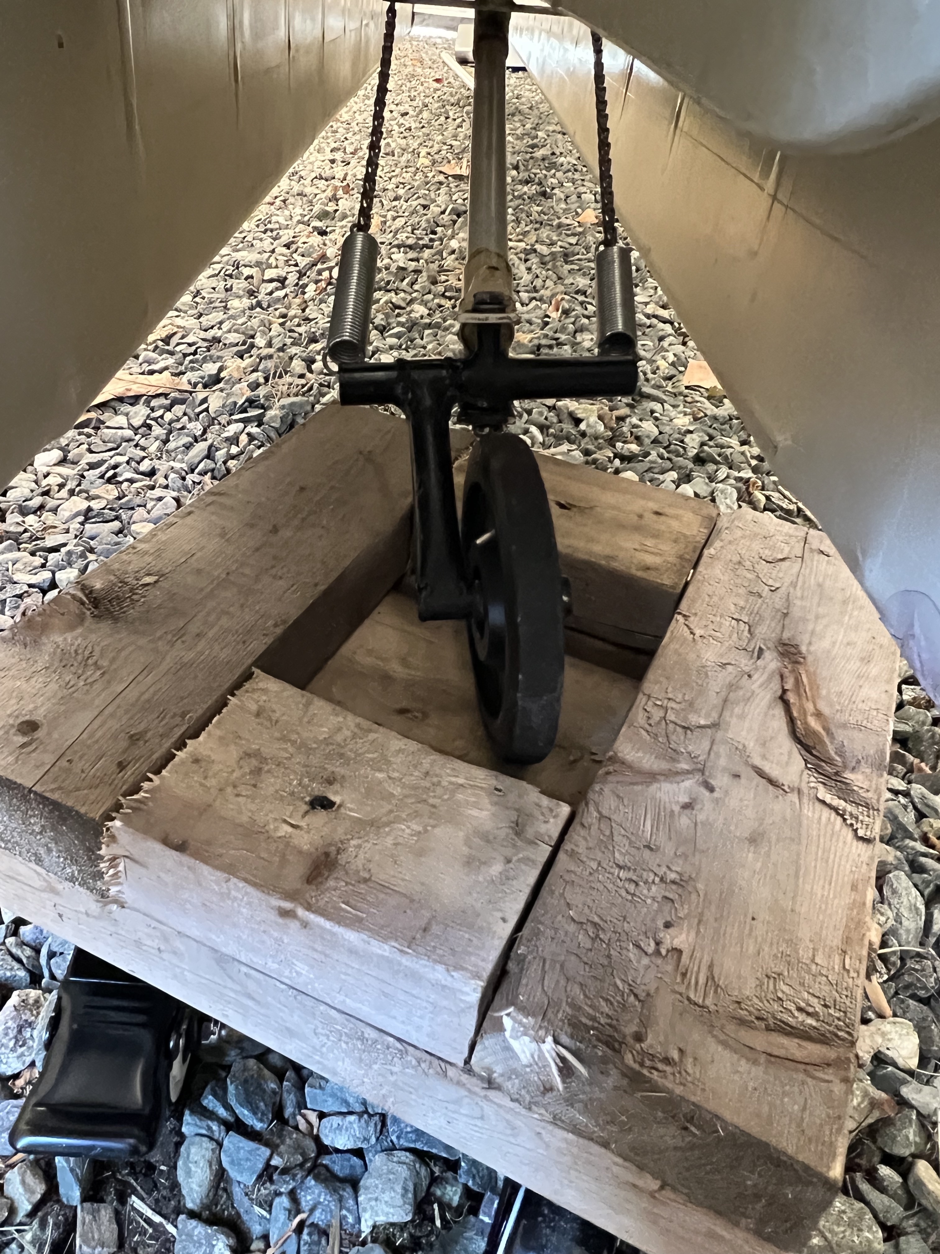

Does this tailwheel look like an issue? I've been trying to come up with a way to move the plane around with the wings folded, but haven't found the right solution. but when I was moving it around on the platform in the picture, it seems like the the whole wheel and support is moving a lot on the tail bar coming from the plane.
it looks like the piece that the wheel is attached to and it the pivot point needs some added support. I looks like it could fold over if there was enough side loading.
anyone have pictures of their tailwheel attachment point to see if my setup is wrong or how to reinforce it.

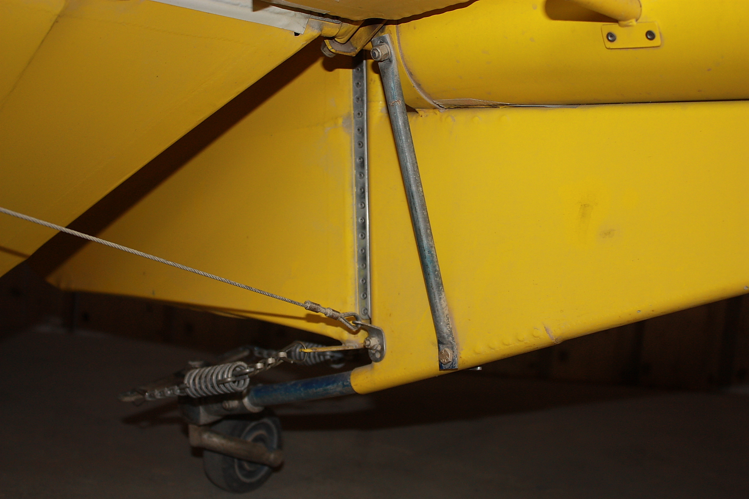

PostPosted: Mon Dec 19, 2022 11:05 am    Post subject: Firestar KXP Reply with quote
I know you said you don't have any manuals and nobody has mentioned it but you probably should know the wing folding posts on the under side of the wings and the tube at the tail are not meant for transporting the craft that way. They are only meant for moving the plane around by hand such as into and out of the hangar and for storage. It's not heavy duty enough for much bouncing without damaging things. Same goes for the tailwheel when transporting. One needs to support the boom at the tail as well as the leading edges of the wings for transport if the wings aren't removed completely.
I know I just installed and drilled my post the other day to 1/8" dia hole so I'm assuming a 1/8" pin or smaller. I'll try to get a photo of the pins and their dia later when I work on the plane this evening. I'm not sure as to what you are referring to as 1'8" but perhaps that is an extension for the pin? The first Kolb I bought had a coat hanger or welding rod welded to the pins to make them longer so you could insert and remove them easier from back by the rudder. I'll try to get a picture of that too. I might be able to run over there during lunch.
Jay

Thank you very much for everything. I guess if I plan to trailer the plane back and forth to the airport, I'm going to have to come up with some other support system.
Thanks for the pin recommendation, I have some wire hangers that I could use as a pin when moving it around and such.

PostPosted: Mon Dec 19, 2022 11:49 am    Post subject: Firestar KXP Reply with quote

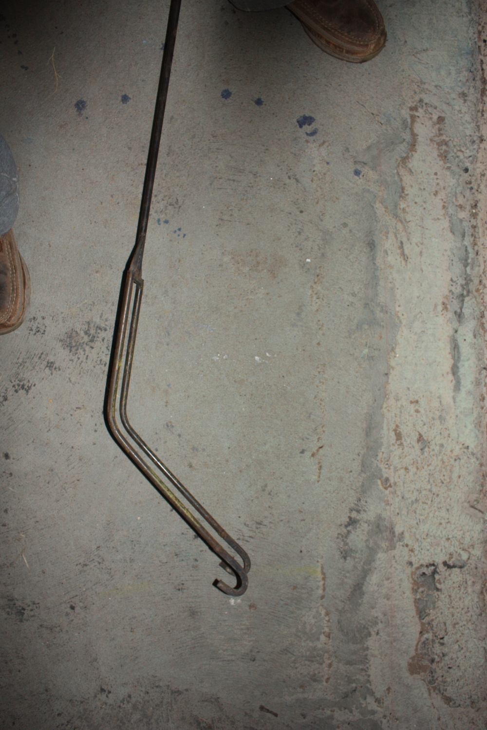

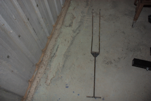

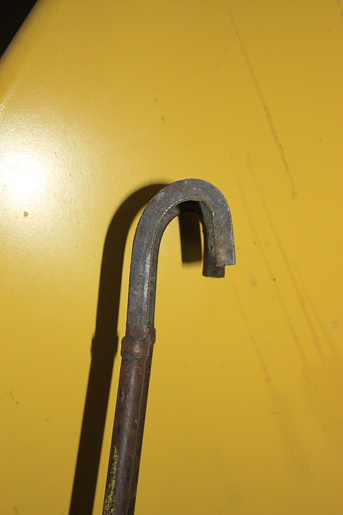

Here are the photos I just took. The pins are 3/32" dia in my kit that hold the folding wing stubs (mounted to a plate on the main wing spar) into the tube that goes perpendicular through the boom tube near the tail. The one photo shows the tailwheel assy of my first plane which looks just like yours, the 2nd is of the one I am building with the pin and rod from plane 1 on plane 2. The rod is much more substantial than I remembered.
Jay

thats a great pic of the pin system, did you weld the rod onto a pin?
I really like that idea.

PostPosted: Mon Dec 19, 2022 12:36 pm    Post subject: Firestar KXP Reply with quote
No, that pin and rod welded to it were from the builder of the first Kolb I bought. I like the idea but the pin is 1/8" and stiff to get on the tube and the rod is heavy. I might adapt that to the 3/32 pins that came with my kit and use a lighter rod like a 1/8 steel welding rod then paint it all.
As for moving the plane around I was thinking about doing something like you would use to move a trailer around by hand called a trailer dolly. Harbor fright sells one but it would need adapted for the tailwheel instead of a ball or you could easily make one using lawnmower wheels and some steel but the idea would be the same. I would guess someone on the list might have made one and could get a photo out.
Jay

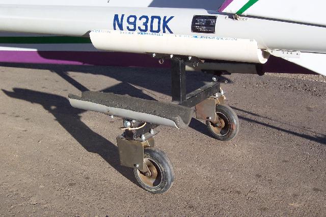

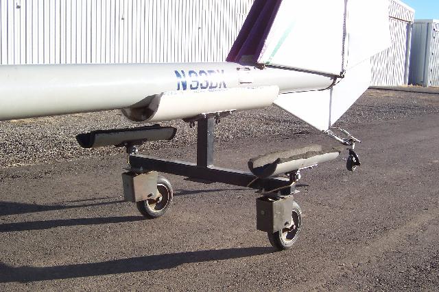

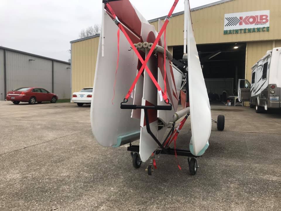

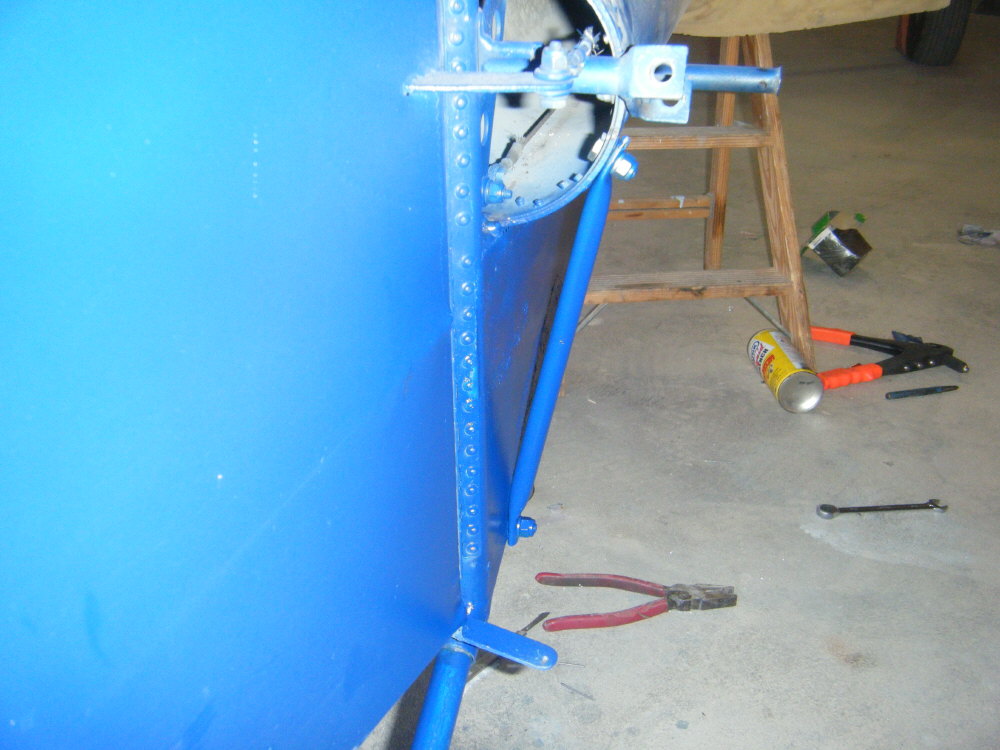

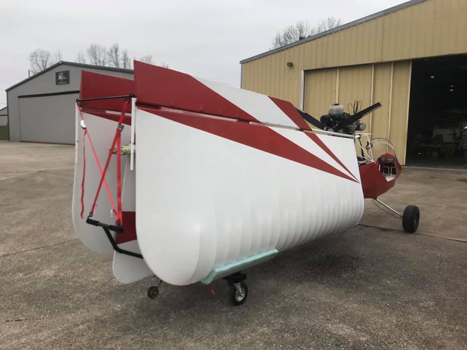

PostPosted: Mon Dec 19, 2022 1:50 pm    Post subject: Firestar KXP Reply with quote
If all goes as planned, I've attached a couple images that I have saved around.
I think these originally came from Kolb themselves (probably are on this list already, but I couldn't find them with a quick search), it's definitely nothing I've built, but I was considering it when I was storing on gravel also.
I usually just picked up the rear by the tailwheel, but that really wasn't all that much fun!

Everyone has chipped in to try to ease your path forward, past things
that have plagued us all. I'm afraid that I had decided that the list
was mostly gone. I am pleased that apparently that isn't so.
I have dug through some pictures that I had that will show you some of
my solutions to various problems that you are facing now. One of the
weak points of the Kolbs is the little tail wheel. They worked for
Homer, as intended, but some of us have different challenges. My
tailwheel post snapped off as I was taxiing for takeoff. John Hawk
helped me put braces on it after repair. You will notice that I
installed the steerable tail wheel as well. I also made a handle to
pull the Firestar out of the hangar with. The tail is light enough
that you can lift it over if necessary. Some scrap steel and a welder
will handle the problem quite nicely.
luck
Larry
On Mon, Dec 19, 2022 at 2:38 PM kolbflyer <j-lauer(at)live.com> wrote:
I looked at those and they all seems to have an issue with the steerable tailwheel in that if you need to swing the tail to one side or another, you can't pivot around the tailwheel itself. the dolly would have to have some type of castor on it also that would allow the tailwheel to stay inline and the dolly wheels to pivot in the direction you need (like a lazysusan with a slot the tailwheel would fit into.
the bigger issue is that I have it in a pop-up garage that is on gravel. Nothing moves well on gravel with that tail wheel size.
If I plan to keep. it in this popup garage, I'll have to make some type of boomwing support on larger wheels, which will take some engineering to clear everything.
thanks everyone for all the feedback, it's much appreciated.
http://forums.matronics.com/viewtopic.php?p=509738#509738
The older I get, the less tolerant I am of those who are intolerant of others.
If you forward this email, or any part of it, please remove my email
address before sending.

kolbflyer
Joined: 12 Dec 2022
Posts: 23
PostPosted: Mon Dec 19, 2022 3:59 pm    Post subject: Re: Firestar KXP Reply with quote
Larry,
thank you so much. for the pictures and the support. Glad I was able to bling a little more life to this site.
I do have a question about the vertical support to the tailwheel under. the boom, does this provide additional strength to the tailwheel? Is there a way to build a more robust tailwheel. or maybe differential braking that would allow a casting tailwheel and easier to move around on the ground?
I've seen that full boom\wing support in other searches and that will take some manufacturing and supplies to see how to make it. I think I found the original plans to build it also.
Thanks and I look forward to keeping this alive for others to use.

PostPosted: Mon Dec 19, 2022 11:23 pm    Post subject: Firestar KXP Reply with quote
When my tail wheel post broke, the entire thing collapsed onto the
ground. The front attachment is only to keep it in line with the boom
tube.
In my opinion the way that the tail wheel is set up is the only weak
spot and it is that the strength of the rudder is limited to the spar
that is dependant on one single flat weld. Much as if you were to
stand a two by four on it's end and glue it vertically to a flat
board. Then apply side loads to it. Enough turns where the tail
(cookie cutter) wheel is skidded rather than rolled. Failure is only a
matter of time. The brace can be even a flat alum bar, or in my case
a bit of left over 1/2 inch round with the ends flattened will perform
wonders. If you notice on the yellow picture there is a breakaway tail
wheel mounted back there. As I recall I got my first one from Kolb,
but Aircraft Spruce has them as well.
https://www.aircraftspruce.com/menus/lg/tailwheels_homebuilders.html
This is the one that I have. I see they have gone up in price, imagine that!
I did find it necessary to change the moment of breakaway to a point
that almost full deflection was required to get it to break when
landing.
The weight is about 12 lbs, but other than when I lift the tail
manually I have not noticed any adverse effects.
Larry
