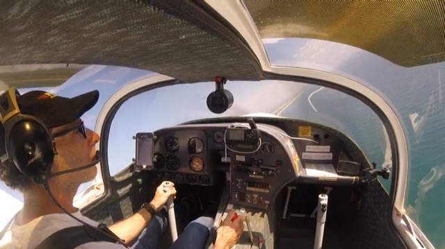

Did what is supposed to be done with a europa; got in it and flew the thing... flew it three days out of seven and enjoyed every minute of the near perfect conditions this week for a fly up and down the coast and around the caldera.
Also was fortunate enough to get a ride in another well built europa that turned up while drinking a cup of tea, and enjoyed that too!
What's next??? .... Fly it again!!!
Such joy...

I think you have your headset on backwards - the ear cups tilt back at the top; they are marked L & R...
HTH,
Paul

Sometimes i like the mic on the right side, and sometimes its on the left :)
Depends what the first morning coffee is like :)

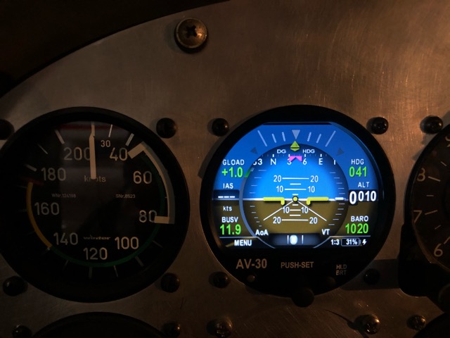

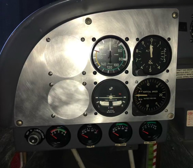

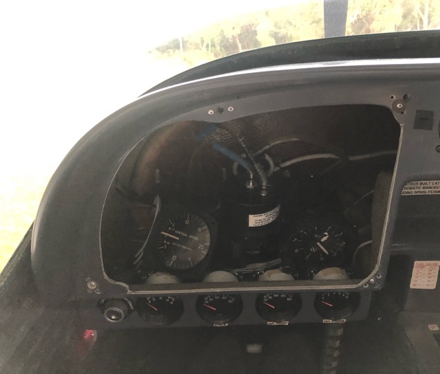

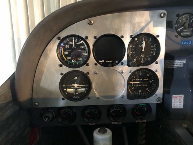

After a bit of fluffing around turning a $19.95 pair of crimping pliers into a $700 pair the week has ended with the AV-30 beaming forth its presence from the instrument panel upon the eve of the mighty festival of light! It was a journey with a few mutterings of demonic praise against the included antiquated Milspec RS232 connector solution (can we please get rid of this shit standard of solution, it is 2022 already!!)...
Calibrated and ready for flight testing!!
