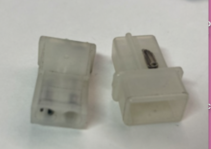

Can the brains trust give a part code for this connector and the M and F pin inserts?
I think it’s an AMP part; it’s the connector on the pea lights inside various analog flight instruments.

Does it have a latching function?
I have a couple similar that have a latch in them to keep them from coming apart...they came with my Reiff pre-heating system...

No latch, just a push-click resistance.
I have about a zillion of the Molex equivalent (.062 and 0.093 sizes) but I can’t track down this one. I believe it falls under the umbrella of TE (or AMP) Mate-n-lok but there are hundreds of different sub-types under that brand and I can’t disambiguate this one.
Those are VERY old AMP-Inc products.
\ I think these are what you're looking
for.
https://tinyurl.com/8by775x

I think those are the ones - thank you.
