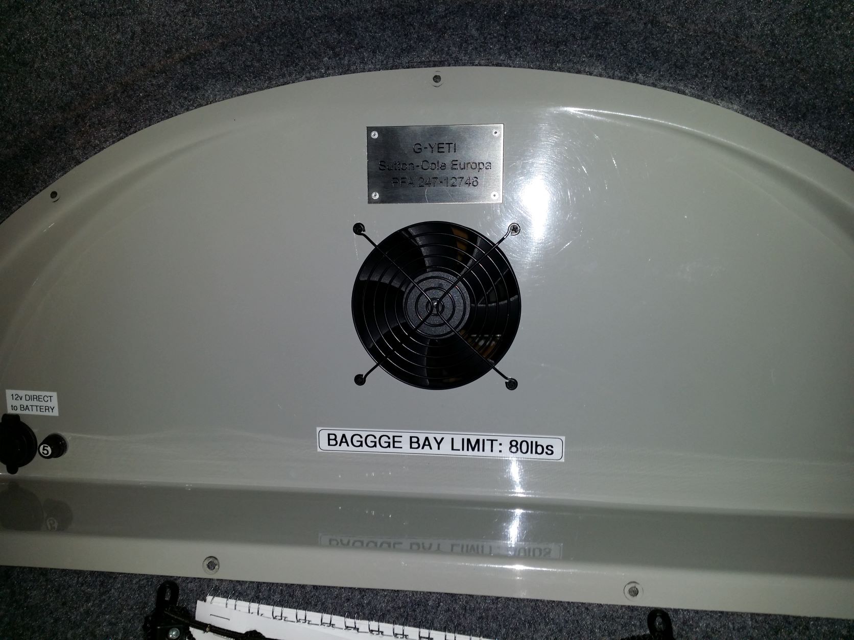

Hi Arwel, your assumptions on the need for a generous cockpit exit air vent are are bang on correct. I did just this on my aircraft and put a 120mm dia 12v computer fan behind the panel as well to force airflow when the aircraft is stationary with the doors closed. My inspector signed this off as a Trivial MOD that was then declared to the LAA (a pic attached). I made sure a CO monitor was in the cockpit at the same time.
On incomer/directional air vents, are you aware of MOD12871? Mike Wilde fitted rotary vents of the type that are now made by Trevor Poulter into his sidewall (at build, NOT replacing the factory NACA vents) which you can perhaps do as a repeat MOD - suggest you check with Andy Draper first [you are in the UK?]
Hope it helps
Clive

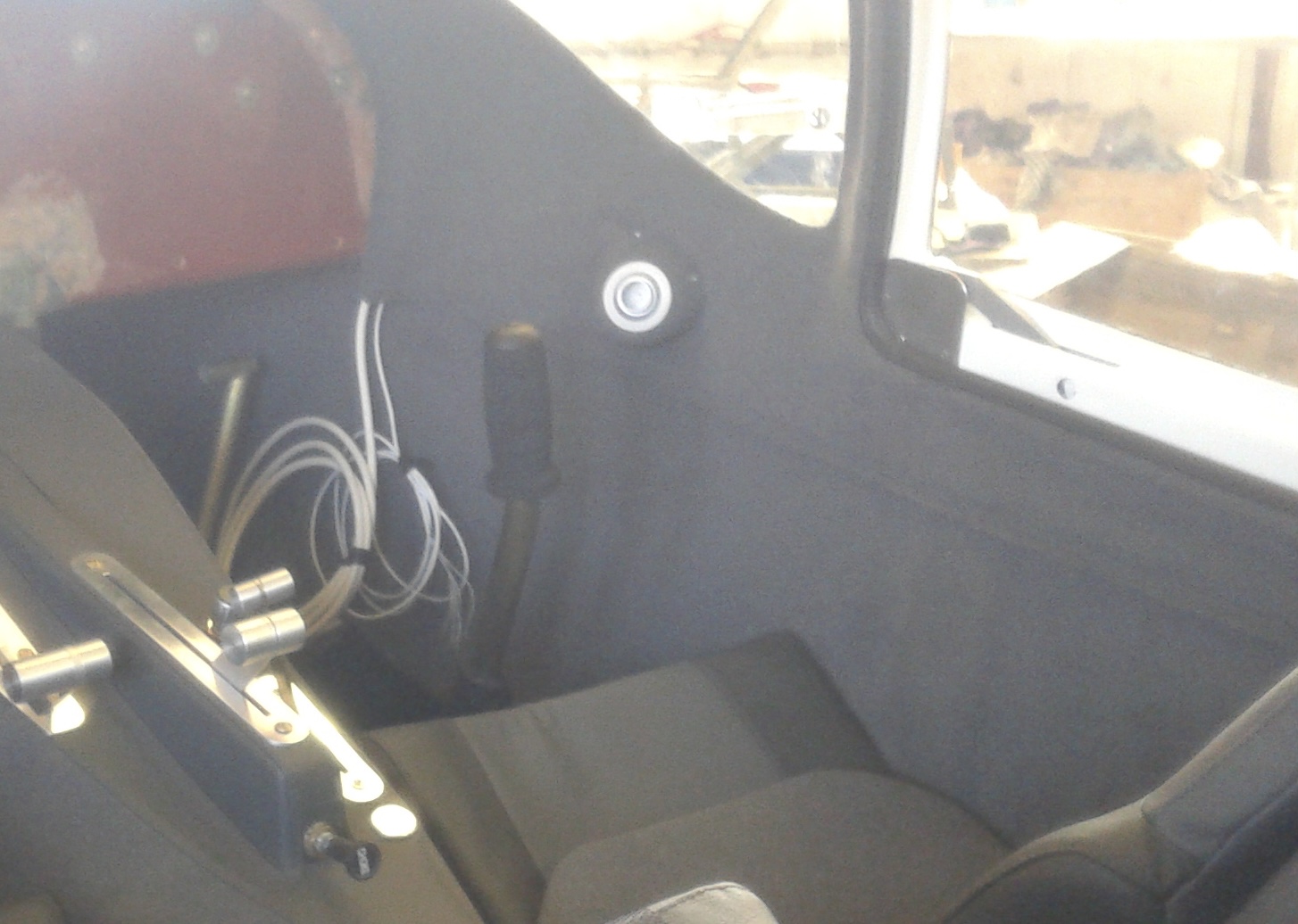

PostPosted: Mon Nov 21, 2022 10:25 am    Post subject: Re: Cockpit ventilation Reply with quote
Aveo make some lovely brushed ali eyeball vents ( https://www.aveoengineering.com/lsa-experimental-ul-kits-and-gliders > Misc and Accessories)
…which I used in the “standard” vent extension - I believe the Club has the molds for these (I made mine while demonstrating composite techniques at the LAA Rally - the reward was I got to keep the parts I made 😁)
I removed the screw mechanism and superfluous plate, much like Rowland did - they can be closed to block all air entering. This photo does not show the stbd one well, but you might get the idea.
HTH,
Paul
