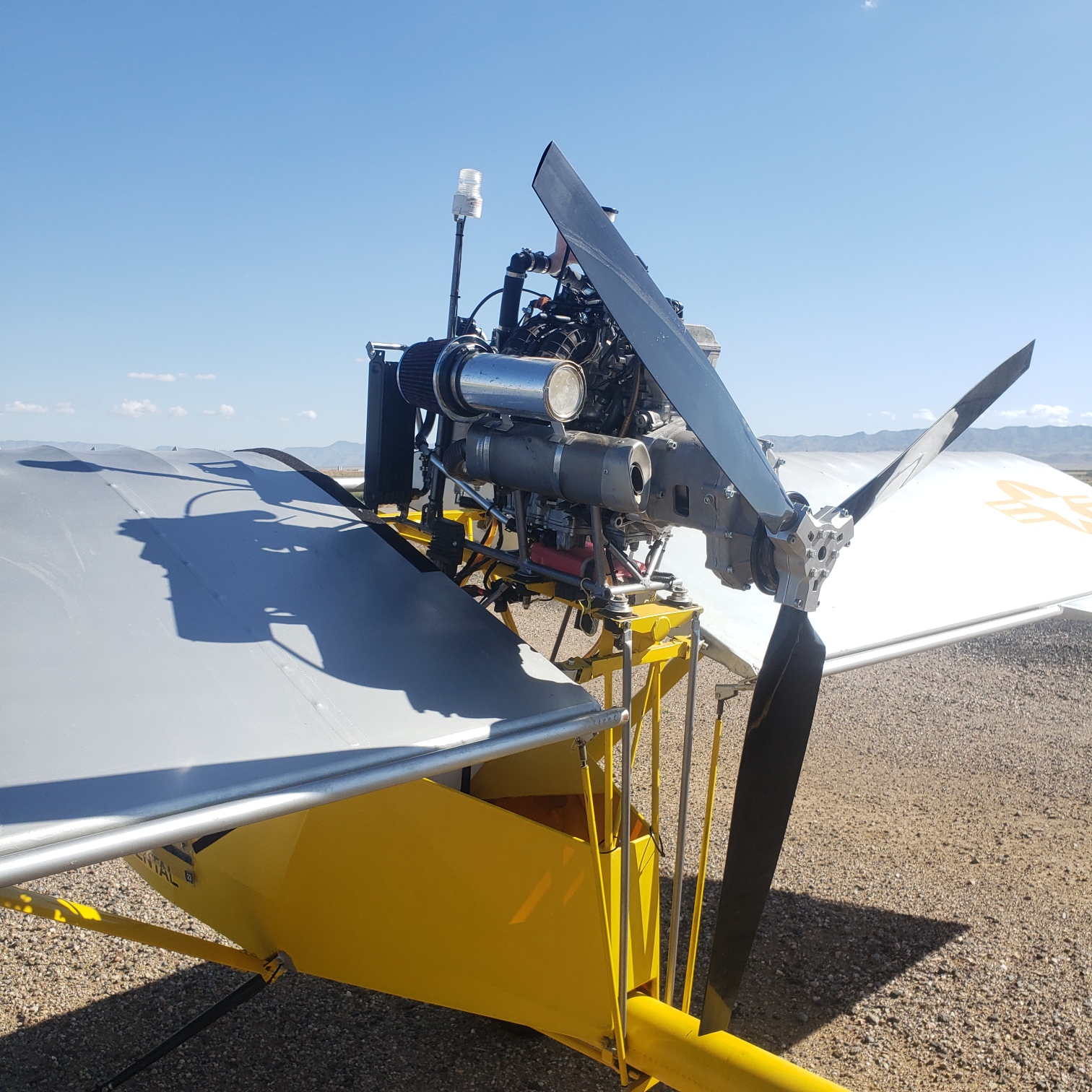

Sorry Guys, Shortly after my post on 9 July I suffered a detached retina in my left eye and havent actually had a chance to get her off the ground yet. Took her to Kingman airport twice to fly it and both times 40-50 degree crosswinds gusting 20-25 mph and didnt want to do first flights under those conditions. Soon as I get the eye straightened up Ill put her in the air and let you know how she does. Here is pic of SPG4 gearbox on my rig. I will take some closer pics and post here tomorrow Chic

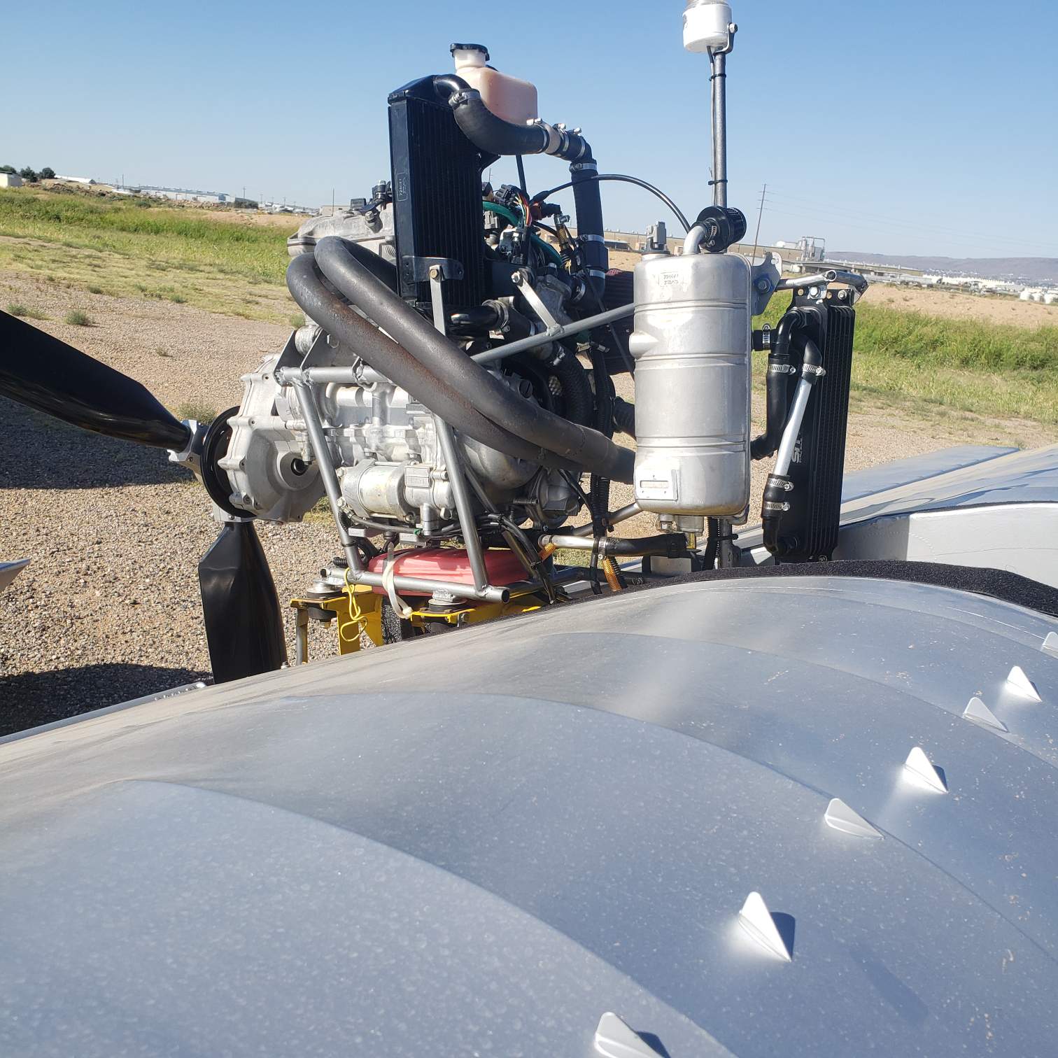

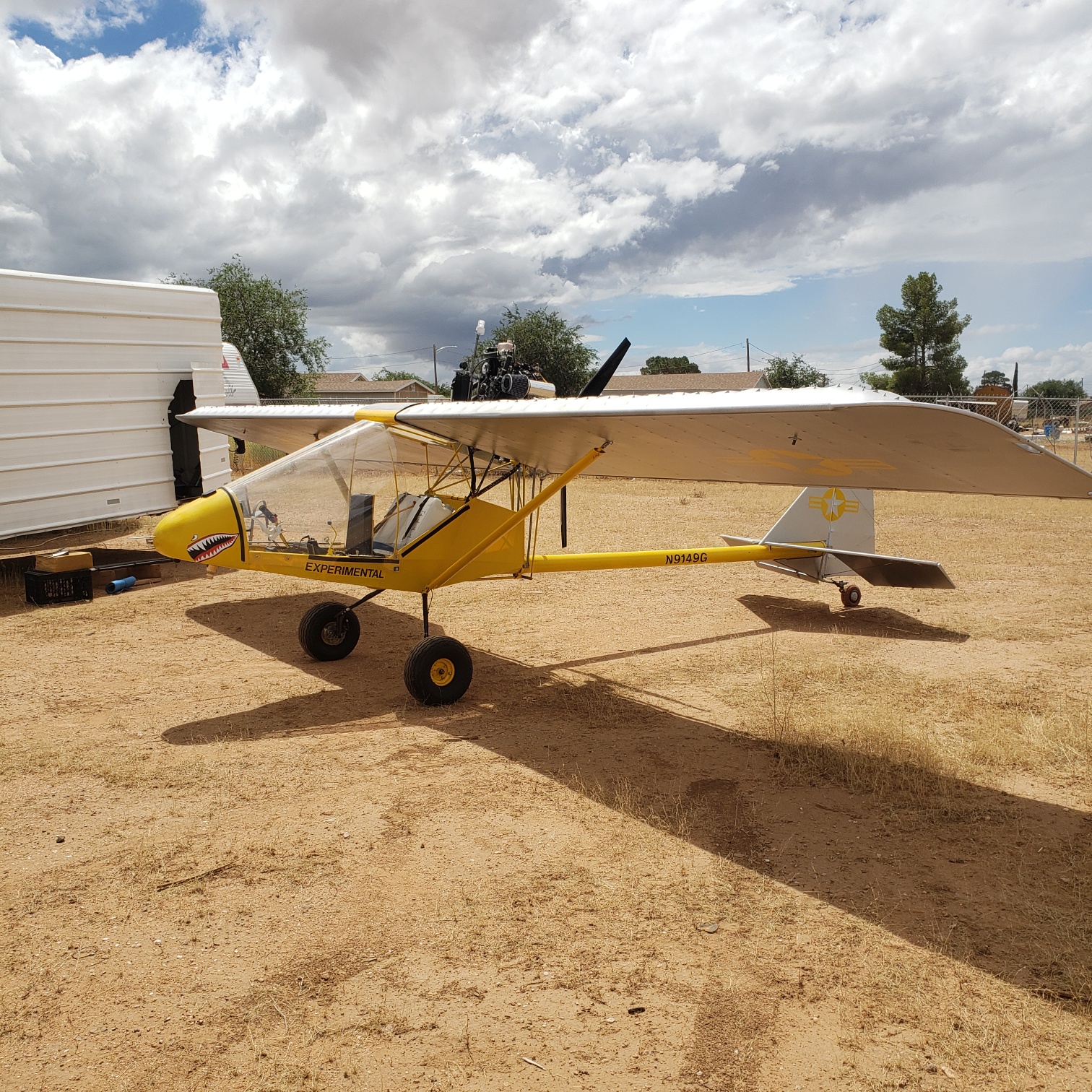

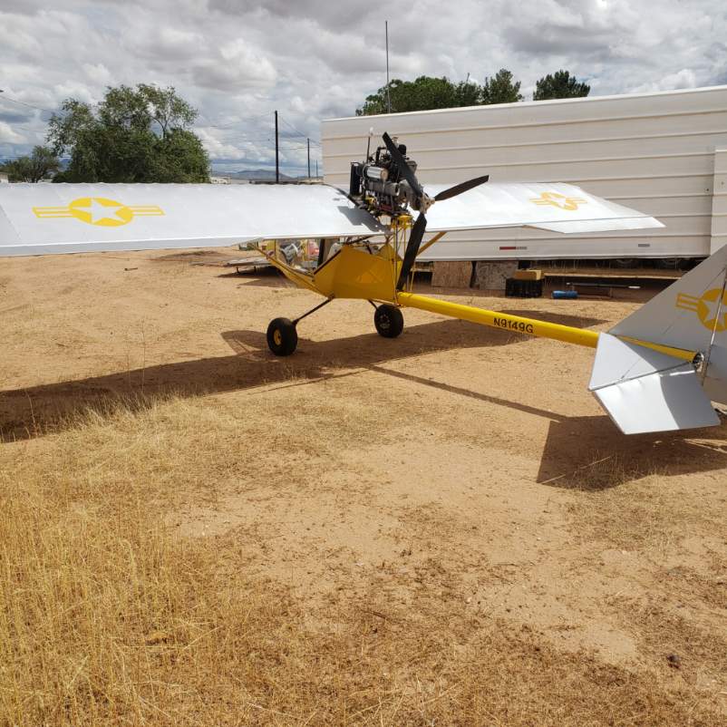

another pic

Nice!
Can you refresh my memory? did you have to make your own adapter plate for the redrive, or did it come to you ready to bolt on?
Charlie

PostPosted: Fri Oct 07, 2022 5:26 pm    Post subject: Re: Phazer conversion for Firestar 2 Reply with quote
The SPG4 came as a package out of Russia. Paid $2400 for adapter, clutch and gearbox. 3.0 ratio with 68" Powerfin. Engine has a 12,000 rpm redline and has a 1.43 to 1 internal reduction. Most guys are proping them to 9500-10,000 engine rpm. At that, with my 3 to 1 box it will give me a wide open prop speed of around 2335 rpm.
