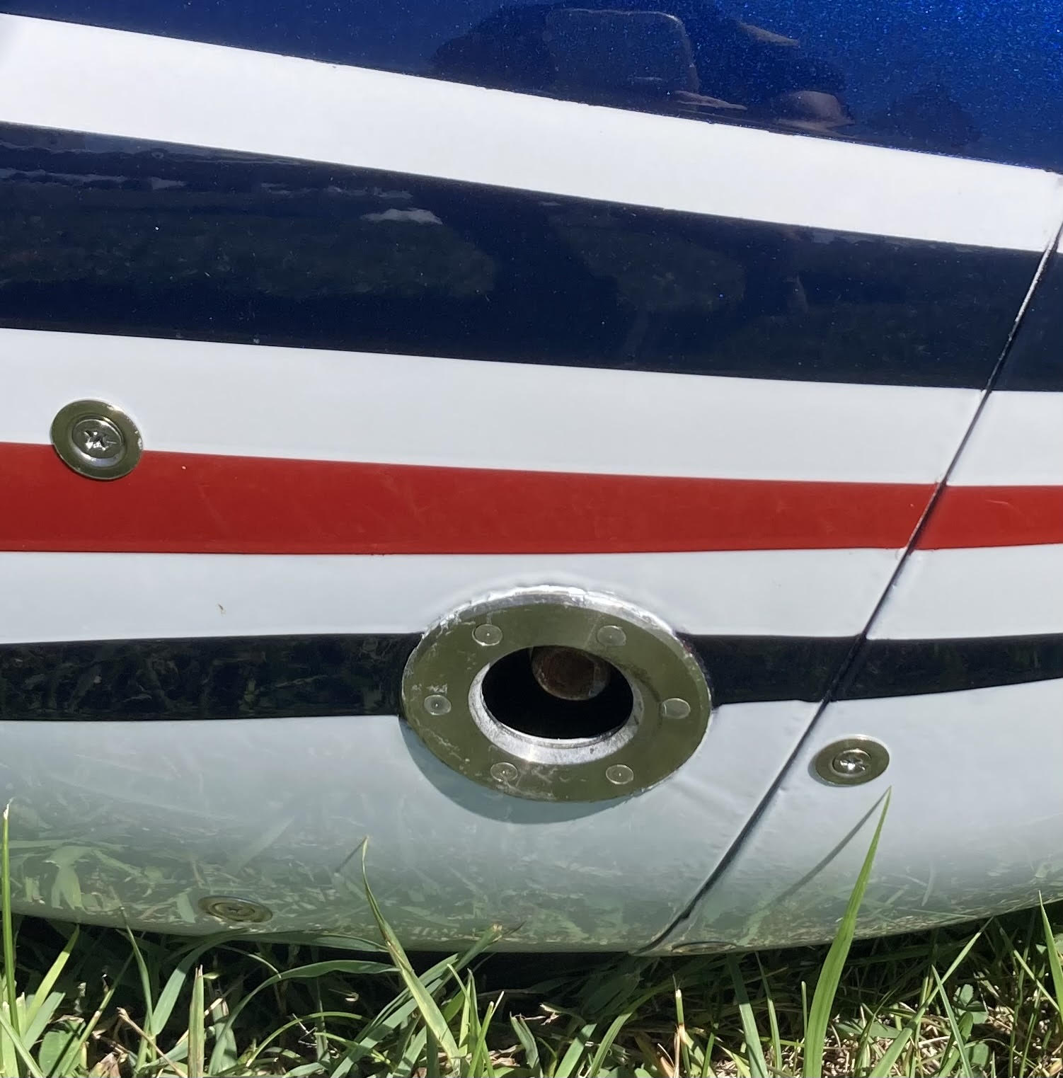

 Can someone please point me to the vendor for these?  Thanks!
[img]cid:ii_l8gd24lt0[/img]

https://flyboyaccessories.com/

These are home made.

If you are very, very careful with your towbar, you will not need these.
Translation: Better get a pair; you will need these.

Or as I have done on several nosewheel pants, use a longer capscrew bolt, with a fender washer between the head and a spacer so that the towbar stud is outside the pants with the washer flush with the pants surface. The washer prevents the towbar from ever entering the pants. Works, even for tow jockies not familiar with RVs. I got tired of repairing fiberglass ripped by the towbar not being on the stud.

I have something similar made out of aluminum that a friend with a lathe made for me. I just bonded them on to the the wheel pants with structural adhesive. There was a short tube turned into the inside as part of it and I set that into cotton flox on the inside to make a metal tube that the tow bar goes into. Stainless would probably be better because it is more scratch resistant.

I can honestly say I haven’t had any on/off problems with the Bogart tow bar - once I figured out a trick, which is to use one of your legs as a fulcrum so you can fully control the bar while you slowly close the jaws. Now, what line boys do once out of my sight, I cannot say!

I did try leading edge tape.  It's no match for an angry Bogert.
We use the Bogert bar and an electric tug.  The tug is really the culprit as it's pretty unwieldy.

Similar, but obviously not always successful:  I open the Bogert then clinch the lever arm open against the fork with my right hand.  Then I put the opposite side of the bar on into the fairing nice and snug.  Then (one very) carefully relax the levered side so it engages.  Works 95% of the time.
On Sun, Sep 25, 2022 at 1:41 PM Bob Turner <bobturner(at)alum.rpi.edu (bobturner(at)alum.rpi.edu)> wrote:
--> RV10-List message posted by: "Bob Turner" <bobturner(at)alum.rpi.edu (bobturner(at)alum.rpi.edu)>

Exactly how I do it. Works every time once you accustom yourself to the
over-center "snap" of the jaws.
When I get too feeble to control the Bogart Bar it's time to hang up the
spurs. Wink

Nah, when you're too feeble to do the Bogert Bar, it's just time to
order yourself a Best Tug A3. Smile Those are magnificent!
