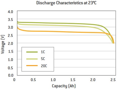

Actually Ken, the same rated LiFePO4 battery will deliver 80% of its charge at a relatively flat Voltage profile before the BMS protects the battery, but the same rated Lead Acid can only be discharged to 50% before charge is necessary or permanent damage can result.  No matter what tech, we often get what we pay for, hence Odyssey Lead Acids have a good reputation and some LiFePO4s (like Invicta) do as well.  Unsure if LiFePO degrades in high-heat conditions the same way Li-Ion does … if so, firewall forward wouldn’t make much sense, but either way they have huge energy density and can’t be extinguished with a typical fire extinguisher (because the degrading cathode liberates oxygen inside the case), so there's safety issue to consider in that too.
Kind regards, Stu [quote] On 30 Jun 2022, at 2:15 am, Ken Ryan <keninalaska(at)gmail.com (keninalaska(at)gmail.com)> wrote:
I'm not sure the 20% cut off number is accurate; I suspect that it is not. But putting that aside, there is another way of looking at this--all batteries have a limited capacity. Lead acid batteries will happily discharge until they are dead or badly damaged Lithium batteries with a BMS will stop discharging before they are ruined. How can this be a bad thing?
It's bad only if you are relying on the advertised capacity number to size your battery. Bob has taught us all that we cannot rely on the advertised capacity number, rather, we should do annual capacity checks to verify the actual capacity. It's just a matter of factoring in BMS behavior when you decide on the size battery you need.

Ivan, you are correct. There are a lot of examples of LiFe batteries being used without incident. Millions and millions of examples in everything from motorcycles to jetskis to bicycles to, yes, airplanes. Everyone I know with an experimental airplane is now using a LiFe battery (admittedly that's not a large sample).

I agree with your comment regarding a BMS override switch. Just thought I would throw it against the wall. I'm glad it's not sticking because I see no need for such a switch.
With regards to the capacity issue, I cannot make the case more plainly than this: If you are comparing a LiFe battery that provides x watt-hours of energy (regardless of what is left after the BMS shuts it down) or a lead acid battery that provides 0.9x watt-hours of energy before things quit working, obviously the LiFe battery will keep things running longer. I was only addressing the previous post (and now your post) that indicated that because the LiFe batteries still have energy left when the BMS shuts them down, that is justification for rejecting the technology. I disagree, based on the above logic. FWIW

A typical LiFePO4 discharge profile will look something
like the attached plot. This is a plot published by
A123. Their cutoff for the plots was at 2.0 Volts.
In either case, note the slope of the plots just below
2.5 volts . . . nearly gone and fading fast. The
BMS cuttoff Voltage may or may not be specified by
the manufacturer of your particular battery . . . but
if not, you should ask 'em.

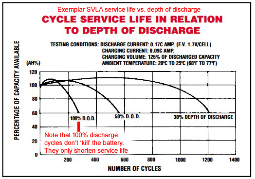

Actually . . . not so. SVLA is rather tolerant of
total discharge as long as you can live with
a reduced service life. The CycleLife profile
attached shows the expected reduction in cycle life
for discharge depths of 30 to 100%
It only takes about 10% of total battery capacity
for pre-flight checks and cranking a Beechjet's engine.
So as long as the generator comes on line to support
cranking the second engine, it's no unreasonable to expect
a rather long cycle life.

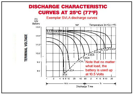

The DischargeCurves plots show expected energy
delivered for a discharge to essentially zero
percent on each cycle. This is called 'deep cycle'
service and is not something the battery cannot
routinely handle.
When one cap-checks an SVLA battery, a known
load is applied until terminal voltage drops
to 10.5V. For a LiFePO4 with or without BMS,
I would still terminate the test at 10.5 volts
or BMS trip out . . . which ever occurs first
For BOTH technologies, remaining energy in the
battery will be very low on the order of 5%
or less.
