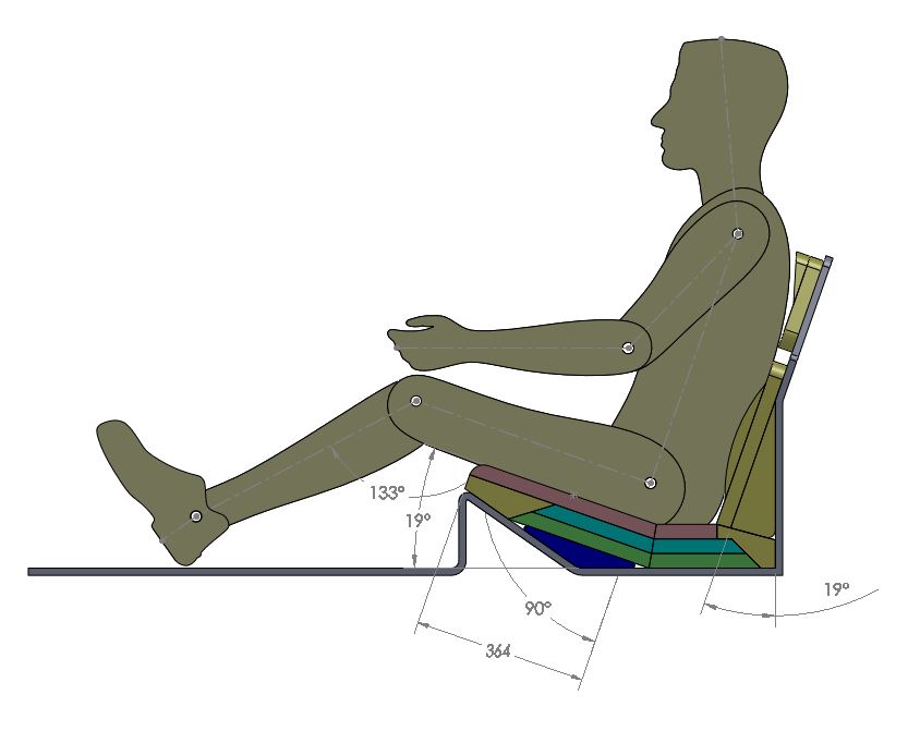

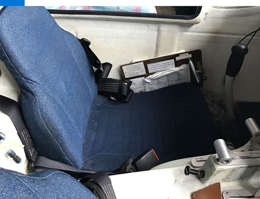

Here goes another of my silly questions:
I spend quite a bit of time designing my seat cushions (as always, I overthink some things and spent quite a bit of time trying to create the perfect seat).
Despite the effort the result is not quite optimal. After half and hour in my new seats, my tailbone starts to kill me.
I attach an image of my seat cushions. The only difference between this image and the final product is that I didn't use the top layer of pink (soft) memory foam. I only have 1 inch of hard (green) and 1 inch of medium (blue) foam. The yellow stuff is regular PU foam).
The angles are all based on white papers (the best one being: http://mreed.umtri.umich.edu/mreed/pubs/Reed%20Seating%20Literature%20Review%202000.pdf) that go deep into the design of ideal vehicle seats.
My suspicion is that I need more thigh support (because the high feet position and short distance to the pedals forces the thigs up and away from the seat) although the theory is that thigh pressure should be minimal as it causes discomfort and it is best to concentrate most of the weight on the tip bones at the buttocks (ischial tuberosities for those inclined to use fancy names Smile ).
I will experiment with a little more thigh support but wondered what experiences people out there had with the Europa cushion design.
One of my biggest questions has to do with the seatback design. As you an see form the picture, mine tries to provide reasonable back angle, but that also reduces the distance to the pedals, causing the thighs to move up.
The good news is that I haven't covered the seats yet. Just modified some pillow covers to protect the foam for now.

Hi Chris
I haven't flown with seat cushions yet. As purchased from Europa they would not have worked very well. Mind you we have long wings too, so back has cut outs for teleflex spoiler cables.
Anyway we modified cushions a little, added foam and balsa backs and blue foam base. We have 2 different thickness of bases, my partner is smaller than I.:
http://www.europaowners.org/gallery2/v/Begin-06-2003/album228/
We spent a lot of time making them feel right and giving us a good view over nose, but not so high head will hit with headsets on. Amazing how a small amount of change makes such a big difference.
Ron P.

PostPosted: Mon Feb 14, 2022 6:42 pm    Post subject: Re: Seat cushion question Reply with quote
Good info Ron.
Well, I have to say not happy with my cushions (lots of work dumped on them but at least I didn't spend the money to cover them yet, something I would recommend new builders, experiment before committing). I wish there was some info on a basic design to get started with but I guess we "don't do things because they are easy ...." Smile
But I have a feeling that increased thigh support will help.
My seat back looks like yours, just not how it was built. But angle yes. Just a theory but maybe the excess angle on seat back pushes you forward, raises your legs and puts too much pressure on tailbone. I'm going to try removing the back cushion and placing a flatter piece of temporary foam. Sounds counter intuitive but will test my theory. If that doesn't work I will add some additional thigh support.
My conclusion is that the Europa seat is a bit narrow (that coming from a LongEZ owner, but that airplane is the ultimate in comfort, my opinion) and your arm touching the door sill makes you lean sideways which contributes to some discomfort.
Will report.
Chris

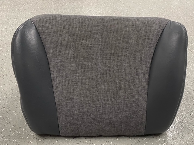

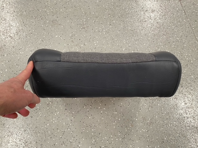

Chris…Here are (first) a couple of photos of my back rest…note that I used a couple scraps of blue & green foam to form a lumbar support which I’ve found to be very effective.
I am 6’-1.
For the seat cushion, I too felt that I was not getting sufficient thigh support; note that although I extended the blue and green foam forward of the vertical face of the cockpit module, initially I had not extended the plywood seat frame enough and had to go back and add to the frame so it aligned with the foam.
BTW, Beneath my foam seat assembly, I have two thicknesses of 1” rigid insulation.
It works well for me…am just now in the process of having ultra leather covers sewn up for a little “pleat and roll” job which wraps around and is stapled into the plywood frame…frame is 1/8” mahogany plywood with edges doubled up for staples

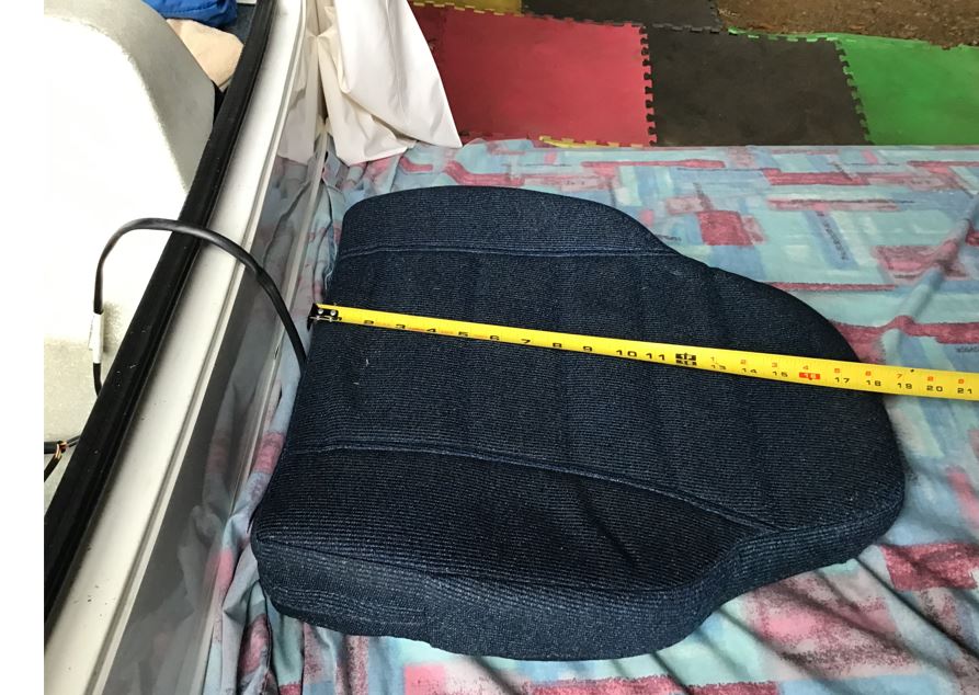

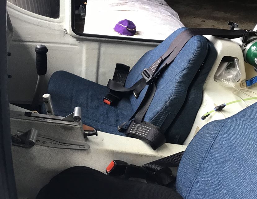

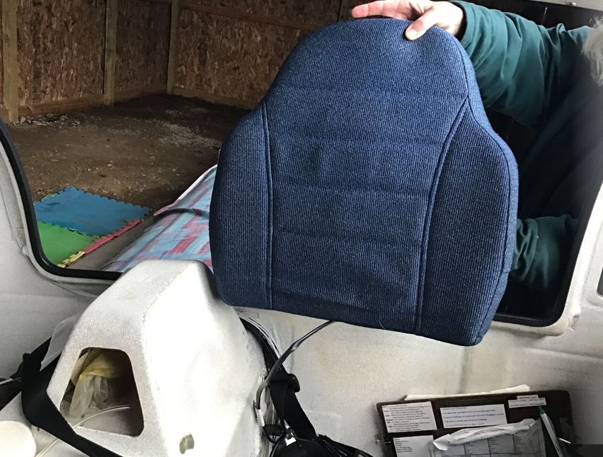

PostPosted: Wed Feb 16, 2022 10:35 am    Post subject: Seat cushion question Reply with quote
Chris,

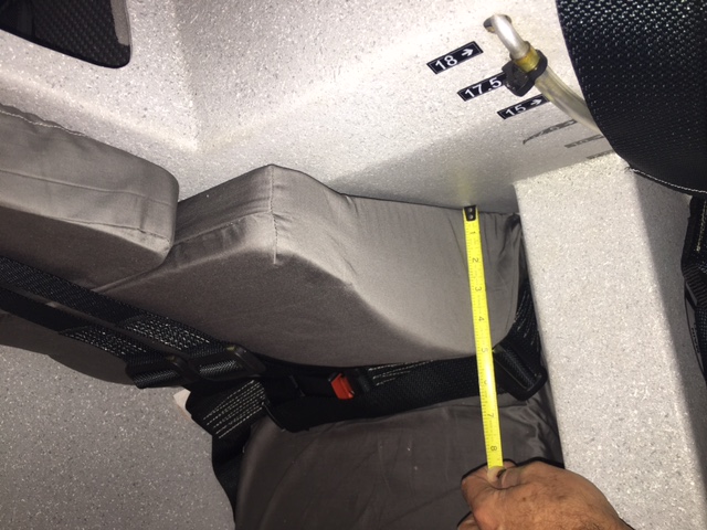

Like others have mentioned, I too found lumbar support to be critical. I made my own cushions using temperfoam (one layer of green and blue) for the seat bottoms which I cut to shape and reattached to conform with the cockpit module seat pan. See picture.
For the seat back, I used a seat cushion from an old Jeep Cherokee that my neighbor donated to the project. I sculpted it to follow the seat back (same angle as the head rest. The cushion is approximately 1” thick at the top and 5” at the bottom providing excellent lumbar support. When installed in the aircraft the upper portion of the the seat back is up against the upper part of the cockpit module (the same surface that the head rest attaches to. This creates a pocket behind the cushion as the cockpit module transitions to vertical. I fill the space with a roll of paper towels, window cleaner and rags, fuel tester and a few other tools. The front of the seat back cushion contacts seat bottom cushion just few inches from the crease in the lower seat as it extends forward. Hope that makes sense. See picture.
When I am seated my rear end and tail bone is on the inclined portion of the lower seat cushion. I must say it is very comfortable. I fly over 5 hour legs when I travel cross county and no discomfort. Don’t get me wrong I am ready to get out of the plane at this point. Five hours sitting is a long time no matter how comfortable the seat. BTW, I am 6’1” tall.
Erich

Thanks to all for the postings. All this information sure is helping understand what you are doing out there.
The good news is that it seems my seats can be improved.
Martin, please send me the info for the gentleman that makes the seats or covers. Never hurts to have the information.
Erich, I understood your explanation. I like your idea of leaving the space between the vertical section of the cockpit module and the back of the seat back open to store some items. Very clever and sure simplifies dealing with the wing attachment pins. However I have a question about that: What keeps the bottom of your seat back from sliding aft?
My seat is similar but differs from two points:
1.- I have a small piece of blue Styrofoam (seen as dark blue in my posted CAD image, at the intersection of the two angles at the seat bottom) that extends the seat thigh support.
2.- My seat follows the headrest and small portion of cockpit module angle plus two inches of foam thickness. Then there is the lumbar support. I think that Erich's backrest sits much further forward at the bottom than mine. The bottom of my seat is quite thick but it is all foam. It's 5 inches but that is from the cockpit module vertical wall. Erich, could you please measure the distance in your seat as I did in mine? See picture.
I think I am going to experiment with additional thigh support first. Then I am intrigued by the way you did your seat back Erich. Much simpler and I like the storage space idea.

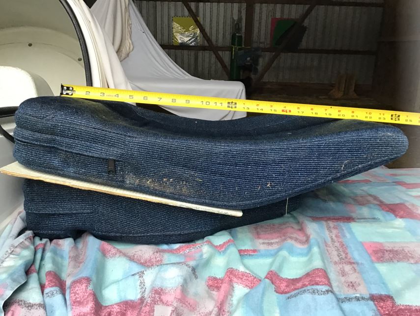

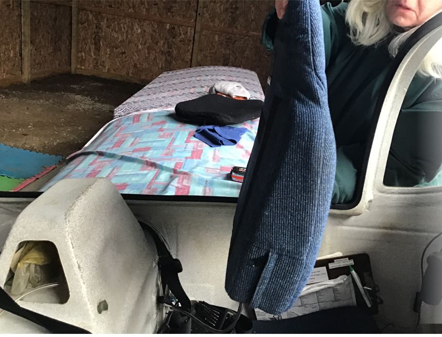

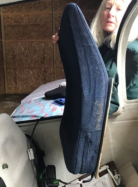

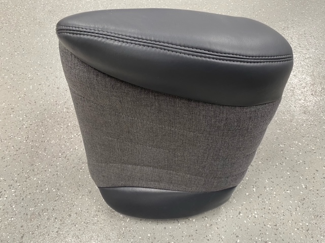

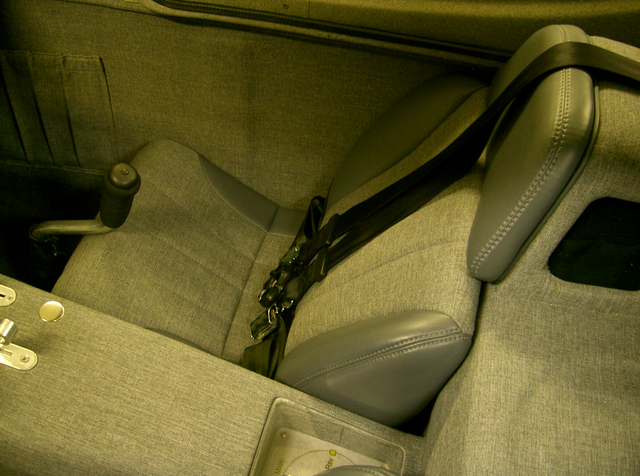

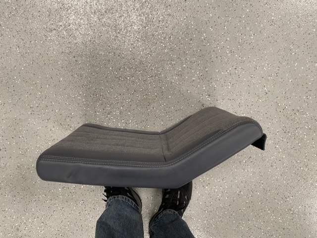

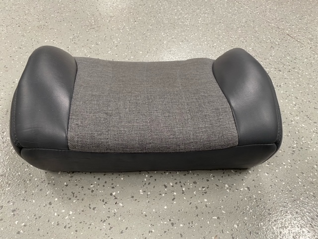

Here are some photos of our Oregon Aero seats.
Jim & Heather

I measured the distance from the vertical surface to the front of the seat cushion and it’s approximately 8” which jives with the 3” cavity I have behind the 5” thick cushion.
A 3” spacer prevents the cushion from sliding aft.
Let me know if you have any more questions.

One aspect that new builders could forget it to enable the seat cushion to pivot up against the backrest for entry and exit.
To get in from the front or back side of the wing means you end up with your butt sat on the headrest and your feet on the seat base.
To avoid getting the seat base cushion messed up it needs to be lifted and rotated against the backrest.
The cushion is restored to its rightful place as you slide in.

Back in 2005 we paid $350 for each pair of cushions and $1200 for upholstery, which is just blue fabric.
Today I looked at the website and bare cushions for Lancair 360 and others similar to Europa run $400 to $500 per seat (2 cushions). Upholstery is extra.
There is a new set of RV8 cushions on VAF that are upholstered in leather and the asking price is $6000, supposed new price is $6900.
Jim
