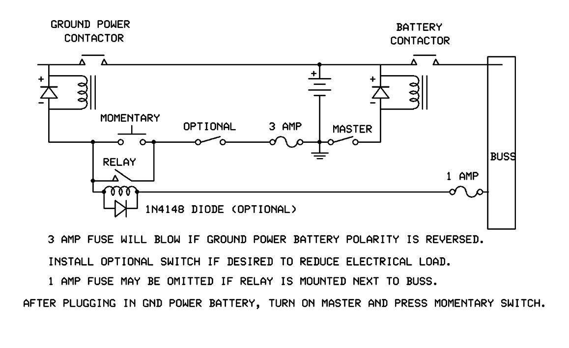

Attached is a circuit that will shut off ground power contactor when master switch is turned off.
 Filesize:  22.05 KB
 Viewed:  5615 Time(s)
Joe Gores

PostPosted: Thu Feb 10, 2022 6:45 am    Post subject: Re: ground power deep discharge of battery Reply with quote
With my circuit, both the master switch must be on and the momentary switch pushed in order to energize the ground power contactor.
Installing an indicator light would be easier, but the light could be overlooked.
Regardless, a fuse should be installed in series with the contactor coil to protect against reverse polarity.
There is a 50-50 chance of the ground power battery being connected backwards.
If the polarity is backwards, the diode that is across the contactor coil will conduct a large current and blow the fuse that you are going to install.
Hopefully that will happen quick enough to prevent damage to expensive avionics.
