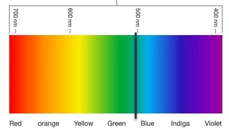

For very low levels of intensity ([url=https://urldefense.com/v3/__https:/en.wikipedia.org/wiki/Scotopic_vision__;!!GobTDDpD7A!b0MsBE1O43Fg51pf9MDAxNo7Uje4DPIh5n0XWzuA8lYEQtVWtzpSh_s5vIvBtr76$]scotopic vision[/url]), the sensitivity of the eye is mediated by rods, not cones, and shifts toward the [url=https://urldefense.com/v3/__https:/en.wikipedia.org/wiki/Violet_(color)__;!!GobTDDpD7A!b0MsBE1O43Fg51pf9MDAxNo7Uje4DPIh5n0XWzuA8lYEQtVWtzpSh_s5vJEW0yn5$]violet[/url], peaking around 507 nm for young eyes; the sensitivity is equivalent to 1699 lm/W[url=https://urldefense.com/v3/__https:/en.wikipedia.org/wiki/Luminous_efficiency_function*cite_note-Kohei2004-16__;Iw!!GobTDDpD7A!b0MsBE1O43Fg51pf9MDAxNo7Uje4DPIh5n0XWzuA8lYEQtVWtzpSh_s5vCHuzVAD$][9][/url] or 1700 lm/W[url=https://urldefense.com/v3/__https:/en.wikipedia.org/wiki/Luminous_efficiency_function*cite_note-Casimer1998-17__;Iw!!GobTDDpD7A!b0MsBE1O43Fg51pf9MDAxNo7Uje4DPIh5n0XWzuA8lYEQtVWtzpSh_s5vD7eMj-A$][10][/url] at this peak. (wikipedia)
For low light illumination ideally we would illuminate with a source of 507 nm.

If you're looking at a color map or page of information in multiple colors
you will need white light to illuminate all colors on the object . If you
were to use monochromatic light, say red, then any area on the page in red
would disappear as it will absorb all the red light and thus appear black
and if the red is on a dark background it will disappear into the
background altogether. This is a reflected light scenario. If you are
backlighting a gage then blue green light will produce the greatest visual
acuity with the lowest level of luminous intensity. It appears some
automotive dashboard lighting has incorporated this piece of spectrum for
illumination as it provides good visual acuity without flooding the field
with excessive illumination that then forces the iris of the eye to
contract and reduce the amount of light entering the retina.
