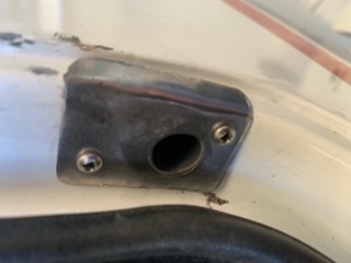

Hi John,
Just measured shoot bolt length. Average total exposed length 22mm.
Average total exposed non-tapered length 12mm.
I installed a stainless steel plate to door frame to guard against fibre glass door frame damage. See photo. They cover the extra DL07 installed in the door frame. Distance between DL07 (door and door frame when closed 1-2mm). Don’t believe there is a remote chance of the shoot bolts being forced out, without using the door handle.
Cheers,
Tim
