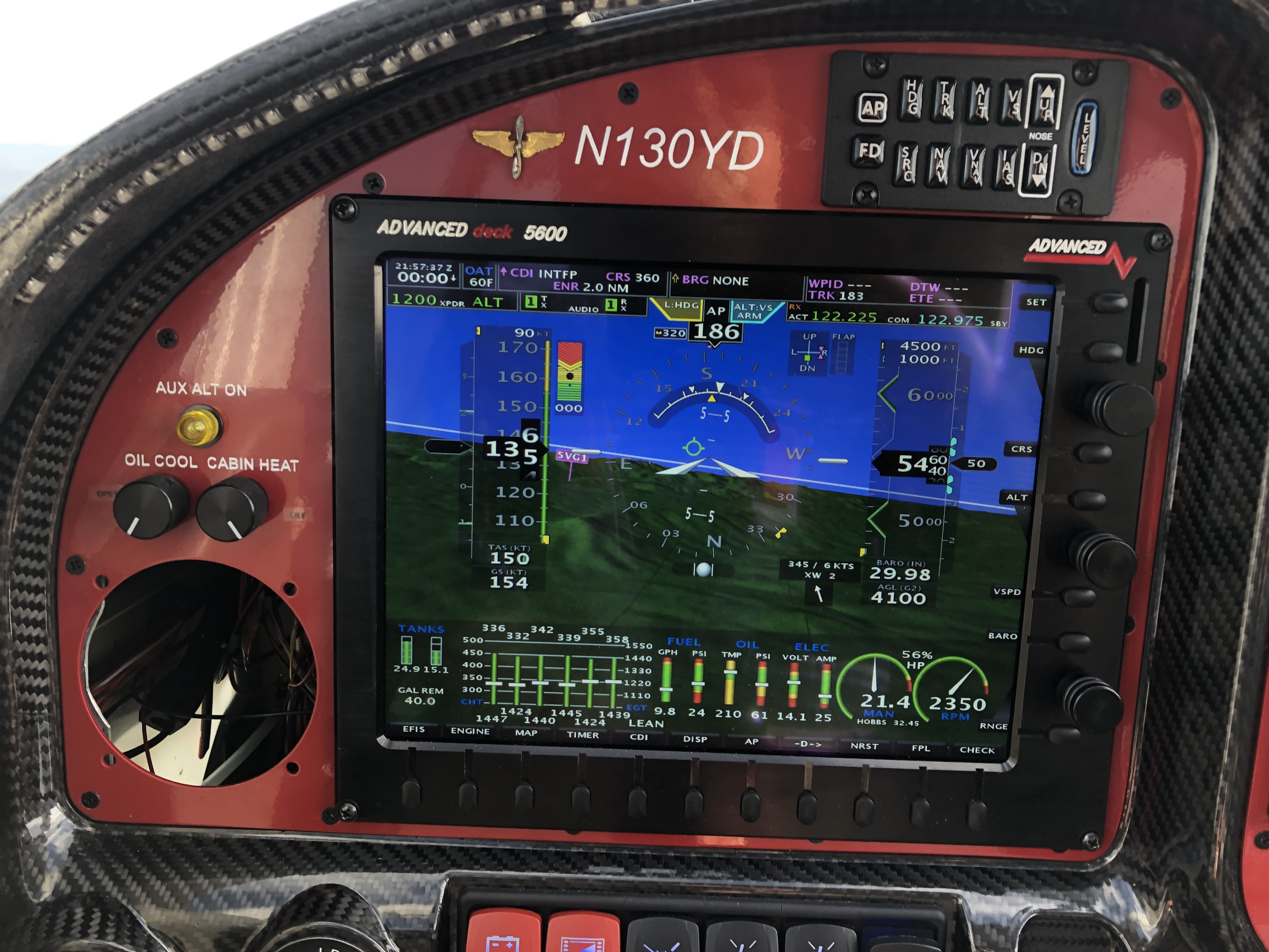

I have a spare yellow incandescent light from B&C designed to be used with their regulators.  I used a pair of these regulators for my two-alternator design, and have the low voltage warning light powered only by the regulator for the backup alternator wired so that it extinguishes as long as the main alternator is online, putting out its higher set voltage.
If you are using B&C or similar regulators, this bulb might be just what you need.  Yours for an SASE if it can be of help to your project.
Should show ok in this pic.
-Bill B
