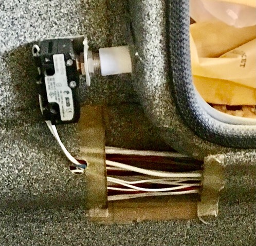

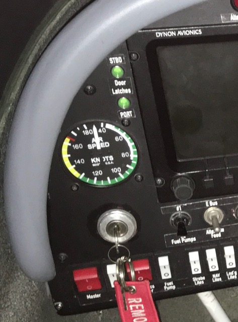

In our discussion of ensuring that the rear shoot bolts are in their proper location, I’ve been struck by the comments about checking by nudging with the pilot’s left elbow to “feel” whether or not the door can be pushed outward (or not). If that is the common manner to assure oneself that he/she is safe to fly, I’m not surprised that some Europas have lost a door, nor am I surprised that LAA has imposed a fix.
While I understand the term “mandatory” as it applies to aircraft registered in the UK, here is a solution which I used to eliminate the risk of losing a door in flight which consists of 3 elements:
1. I fashioned a tab from a scrap of 1/8” foam, and glassed it to the doors in alignment with the seat back/head rest,
2. I installed microswitches, located so as to contact the rear shoot bolts when the door latching mechanism is closed,
3. And I installed 2 green LEDs on my panel.
I’m indebted to Raimo Tolvio for the electrical components basic design.
When closing the pilot’s door, I reach with my right hand and pull the tab inward, while my left hand shoves the latch handle forward. If I have a passenger, before instructing him/her to shove their latch forward, I reach with my right hand around the back of the passenger’s seat back/head rest and pull inward while the passenger shoves the latch forward.
I think of this featherweight little tab as the most important component. The ability to pull the door inward eliminates racking of the door, prevents the shoot bolt from marring the exterior finish, and ensures that the door is properly closed.
The microswitches and the 2 green LEDs on the panel were selected and wired in the simplest fashion in order to eliminate false positives…2 green lights confirm that the door is properly closed...if I don’t have 2 green lights, it’s a no-go.
And of course I use a checklist...

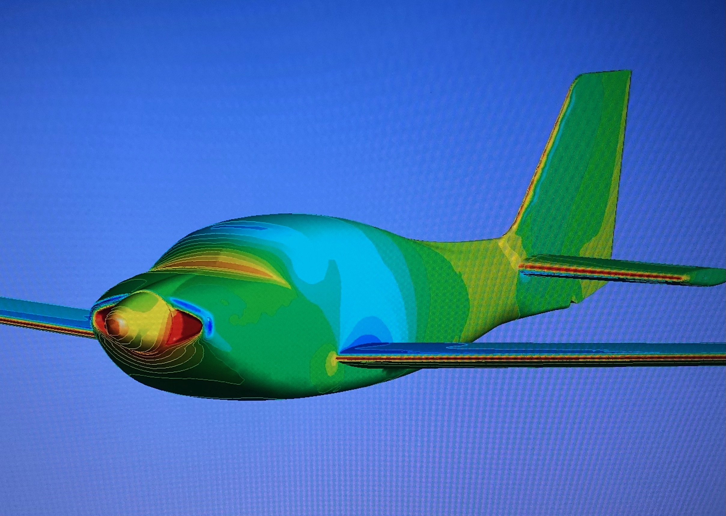

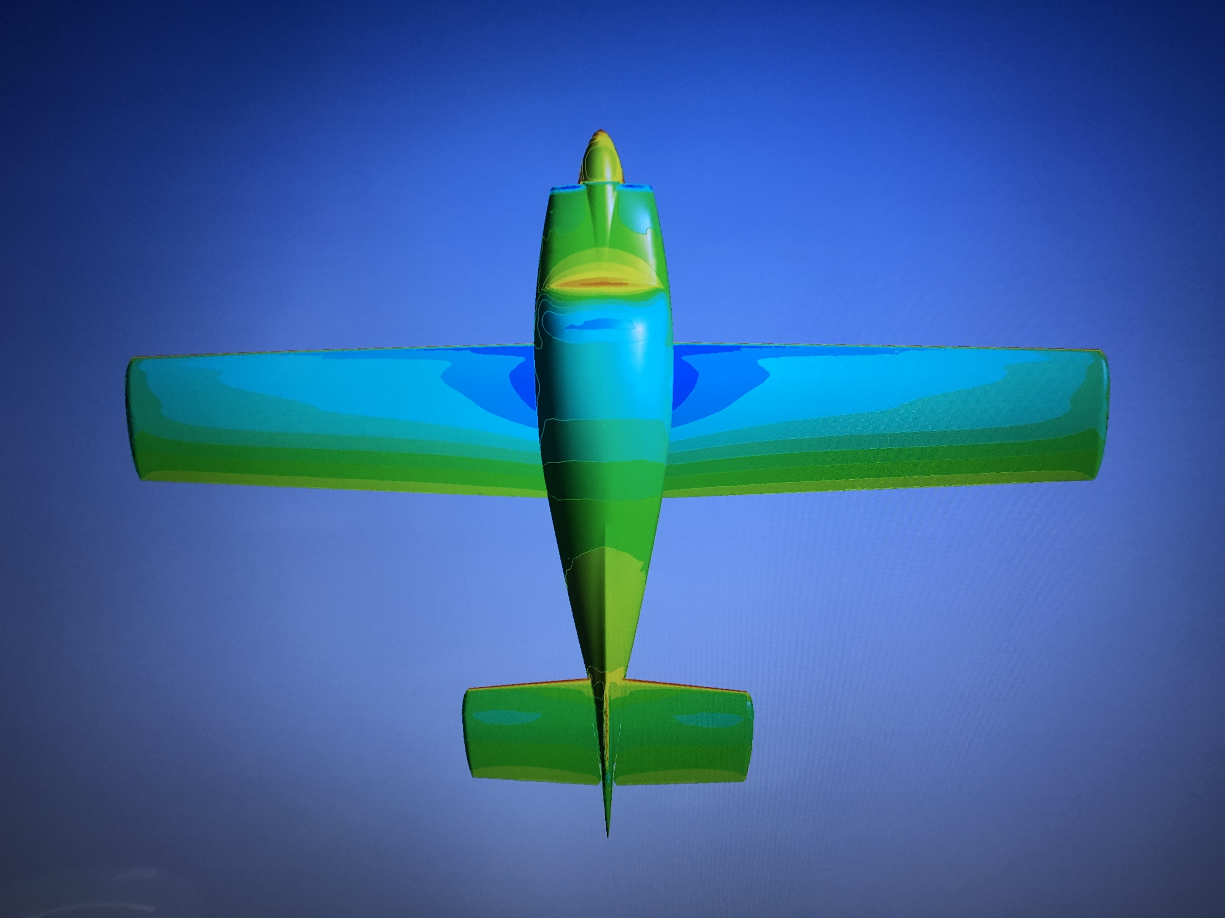

Graphical answer to why europa pilots need to ensure doors are correctly locked before getting airborne and to refrain from opening them in flight... firstly they are positioned in a constant low pressure area trying to tear them off, and secondly once they have departed the airframe about 30% lift is no longer available to maintain altitude...
 Filesize:  1.91 MB
 Viewed:  17319 Time(s)

Graphical answer . . .
Really interesting graphic, could you post the same for a side view of the aircraft please?
Can i assume its is for a 'clean' Monowheel and for approximately what speed is this?
Thanks in anticipation,
Clive S.

I think simple CFD is great but think it unwise to distribute snap shot s as they can be taken out of context. The Europa fuse and canopy Are classic in form and will generate a range of differential pressures depending on speed, alpha, beta and altitude.
The net lift on the door can be calculated using data from a full sweep. But that just tells us what we already know - that doors do depart the aircraft if the front pin disengages from the front socket.

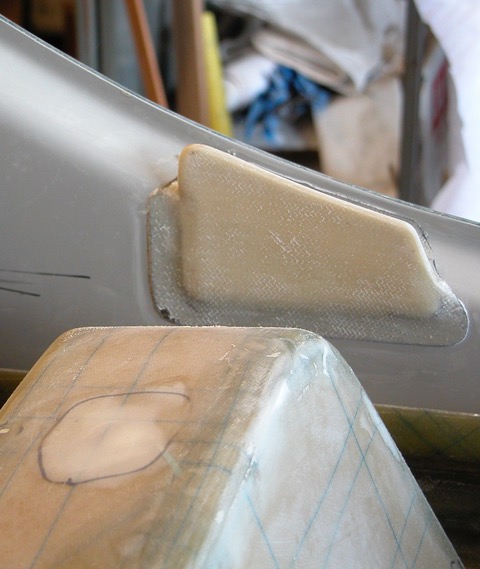

Following on from my last post I reacquainted myself with the build manual sections 34 and 35.
The part DL07 is the guide mounted in the door, this gives the shoot bolt an axis to follow - hence it needs to be aligned accurately such that DL06 (shoot bolt) and the operating rod DL11(F and R) do not bind.
Doing the above should ensure the shoot bolts protrude equally and follow a longitudinal axis.
Drilling and opening up the door-side holes is covered in manual 35. It states:
"In this step you will be cutting the holes in the door rebates to accept the shoot bolts, but first reinforce the area where the holes will be by applying 4 plies of ‘bid’ 30 mm x 30 mm at the back of the door rebates (unmoulded side).
Once this layup has fully cured apply a small dab of wet ink, or paint to the very end of the shoot-bolts. With the door fully pushed home, move the door handle towards the closed position until the end of the bolt strikes and, hopefully, leaves a witness mark on the door reveal.
This is your starting point; drill a 1/4" hole and then with a round file carefully open up the hole just enough to allow a shoot bolt guide to fit in the door recess, so that when the shoot-bolts are fully extended, the doors are fully secured and flush with the outside of the fuselage. Use dabs of paint on
the shoot-bolt each time you want to enlarge the hole so that you can see which areas need filing. Shorten the shoot bolt guides so that they protrude only 10 - 12 mm (3/8" - ½") through the door frame and, ensuring that there is a gap of only 1 - 2 mm between the guides in the door and the frame, bond them in with Araldite 420 and flox."
I would suggest that there should be another bush (like DL07) that goes into the doorframe moulding. This could be CNC machined (or 3D printed in a durable material). The initial opening would 'collect' the DL06 shoot-bolt taper and guide it into the new bushing.
An enlarged flange on this new bushing could be made to act in a similar way to the UglyMod moulding - i.e. preventing the shoot-bolt from moving rearwards if misaligned.
In summary
1. There seems to be a wide tolerance on shoot-bolt length.
2. Physical examination of Europa shoot-bolts suggests that the end taper and radius of the bolt is highly variable.
3. The locking mech in the door has a nice bushing/guide.
4. The shoot-bolt on the doorframe locates into a plain hole that has no dimensional tolerances (ref build manual 35). The dimension given has no datum and may be open to misinterpretation.
5. A doorframe mounted bushing - correctly designed, should enable more accurate engagement of the shoot-bolt.
6. Are the shoot-bolts installed in aircraft sufficiently long?
Discuss.......
