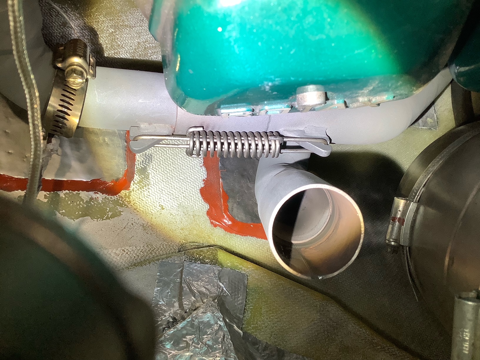

My fine classic was missing one of its exhaust springs, and ive been having a hard time sourcing (been using regular springs as a stop gap).
Any suggestions?
Thx!
Pic is what i’m looking for.
 Filesize:  885.92 KB
 Viewed:  7001 Time(s)

Sorry, can't help with replacement springs but a couple snapped on my CKT exhaust. After replacing them, I copied what someone else does to cut down high frequency vibration. First put safety locking wire through the spring centre as usual and secure it around the spring attachment hooks, to prevent broken springs falling onto Scotland and perhaps choking cows.
Wrap another piece of locking wire right around the exhaust header tube to include and bisect both springs on either side, so that tightening the wire causes both springs to bow in slightly towards the exhaust tube. Then smear an approx 1/4 inch wide streak of high temperature silicone along the length of the spring, on the side furthest away from the exhaust tube.
So far this plan is working for me, with no broken springs in over a year.

Try McMaster Carr, they are great for any hardware.

Look to motorcycle supply sources or shops. The Classic and XS exhaust is prone to exhaust spring resonance fatigue, corrosion, weakening and failure

Buy quality stainless springs that will pull about 1/2", put a 1/4" bead of high temp silicone to dampen vibration, run a .040 safety wire loop just snug to retain pieces and prevent components from failing to seal and also to prevent damage and dropped objects.

Mounts were/are good.
I will check the torque tho.  I guess the inference is that there should be movement possible against the head port?  I find that idea to be concerning…..with the aluminum seat expected to be quickly wearing.
Thx again!

On 19/11/2021, at 7:33 AM, Pete <peterz(at)zutrasoft.com (peterz(at)zutrasoft.com)> wrote:
Hi Tim,
My sentiments as well.
912S?  Very Encouraging data, but makes me wonder why mine have cracked. Engine is running smoothly, and prop dynamically balanced.
Cheers!

On Nov 18, 2021, at 1:04 PM, timward <ward.t(at)xtra.co.nz (ward.t(at)xtra.co.nz)> wrote:
I have always been perplexed by the need for springs on the original Europa Classic exhaust system. Due to the design the exhaust can neither move forward or aft nor up or down. Number one and two cylinder pipes counteract the up and down, and the number three and four cylinder pipes counteract the forward and aft.
I have had no problems with my system for the last 20 years and 900hrs. The springs remain in place but to me, they are useless.

On 19/11/2021, at 6:42 AM, Pete <peterz(at)zutrasoft.com (peterz(at)zutrasoft.com)> wrote:
Thx Bud etal,
Nuther question:  I’m repairing my second cracked clean off exhaust flange. Sad. Im surprised the heavy classic muffler is not suspended from the engine-side frame. Anyone else see these failures?

On Nov 18, 2021, at 11:31 AM, Bud Yerly <budyerly(at)msn.com (budyerly(at)msn.com)> wrote:
Look to motorcycle supply sources or shops.  The Classic and XS exhaust is prone to exhaust spring resonance fatigue, corrosion, weakening and failure.
See my troubleshooting guide.
