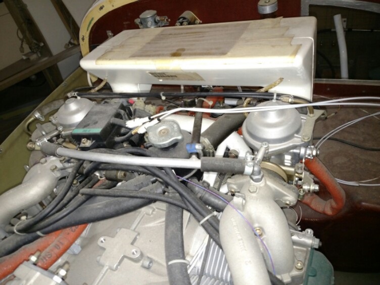

Kevin see attached image, hopefully this will help.

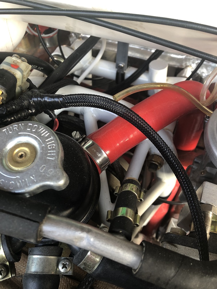

PostPosted: Tue Jun 22, 2021 3:51 pm    Post subject: Re: Coolant Hose Routing Reply with quote
Kelvin,
I've never had a great deal of difficulty but as you are well aware, we all have to adjust things around to get everything to fit. It is a game of fractions of inches.
In installing the ring mount, I modify the angles on the water pump inlets from cylinders 2 and 4. I personally run them through the V. I do a considerable amount of preplanning before I mount anything anymore. Blindly following instructions in a hope it all fits has never worked out for me on any of the homebuilts I completed. I'm not a mechanic, I'm a dumb old pilot with an engineering degree that has learned almost everything the hard way. Take notes, take your time, trial fit everything. I use many 3/32 clecos to keep the holes small when fitting.
On the one inch hose coming from the top of the spider to the port side cooler inlet I do the same for the 912S as the 914. I carefully measure and mark the hose from the spider to the inlet area of the port carb and airbox. I install the 1 inch hose after cutting so the hose lies right on top of the ring mount. I slip on a piece of hose to the M10 bolt threads attaching the ring mount to the engine frame to prevent chaffing. I normally do not bolt up my duct until I run the one inch hose down to get the clearance I want from the engine and firewall studs. Once I have the hose planned, I fix the duct where I need the nipple to fit. I then fit my duct. With the duct all clecoed final in place, I then cut my hose.
I have one 912S aircraft that required me to take the hoses off the spider and slightly elevate and twist the spider to fit the 1 inch hose exactly where I wanted it to go. Alas, I had to buy a short piece of 17 mm hose from Rotax as I needed #3 upper hose to be a bit longer. I did not put a block under the spider tank. It hangs on the hose and has worked for many years. I'm attaching a photo from a complaint I had with my painter on that particular plane. Rather dusty engine with a lot of overspray which I later made him clean but it shows the upper hoses and how it laid. See attached.
Finally a technique on hose access. I make my side supports that hold the duct up with holes on both sides for easy access to the clamps. I actually modify the port brace to allow the duct to slide up and down past the muffler for a quick duct drop if needed. Of course, nut plates everywhere in the firewall/footwell. That makes for much more comfortable duct removal.
I have made modifications to the rudder return spring holder bolts to protect the rubber down pipe where they interfere. Normally an acorn nut on the end of the threaded bolt for a smooth surface touching the hose if it is only close. If really tight, because the duct is placed too far aft, I fashion a piece of aluminum as a protective buffer. If the duct was moved too far forward or back, I sometimes just repair and move it. It happens.
Best Regards,
Bud Yerly
 Filesize:  123.1 KB
 Viewed:  5927 Time(s)
