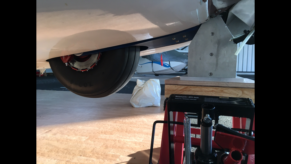

I jack my aircraft using an ATV jack that can be purchased at a reasonable price with custom made jig that takes the weight of the aircraft on the LG01 frame. A rubber strip ensures no damage is done to the paint.
I have since cut away the front side of the jig to allow room for the cowl flap that I added and the lower cowling can be left in place during jacking. Best to place trestles under the wing to avoid lateral tipping of the aircraft.
I found jacking the aircraft under the wings requires about 20kg to hold the tail down and the underside of the wings are not reinforced like the walkways.
I should make a jig for use when traveling though!
