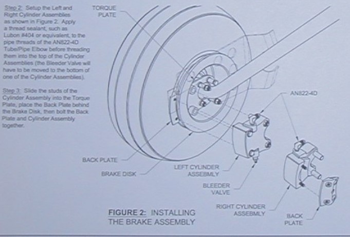

Let's see if this helps.  Looks like AN822-4D  It's off Tim Olsen's site.  If not I can probably get a picture from the manual tomorrow.

I did find that, but that's the AN elbow fitting. I am pretty sure the bolt is an AN4 but don't know the length. I'll be able to find it when I go to the hangar, hopefully tomorrow.

Just sent Dave the plans section. An AN822 is a fluid fitting…
