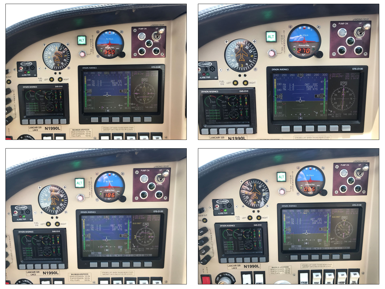

Here's a really weird one that occurred recently. Flying on a North-Easterly heading the PAI-700 panel mount compass informed me I was heading West. This is a new problem and the photo taken some years ago shows the relative positions of the instruments with reasonable agreement between the panel mount compass and the Dynon EFIS.
Taxiing around a circle without the Dynon EFIS D100 in the panel gives good compass readings. With the EFIS in place the compass reading remains between South and West. I took the compass and EFIS to the compass manufacturer, Precision Aviation, where they confirmed that the compass is OK and the EFIS magnetization too strong for a mu-metal shield to help.

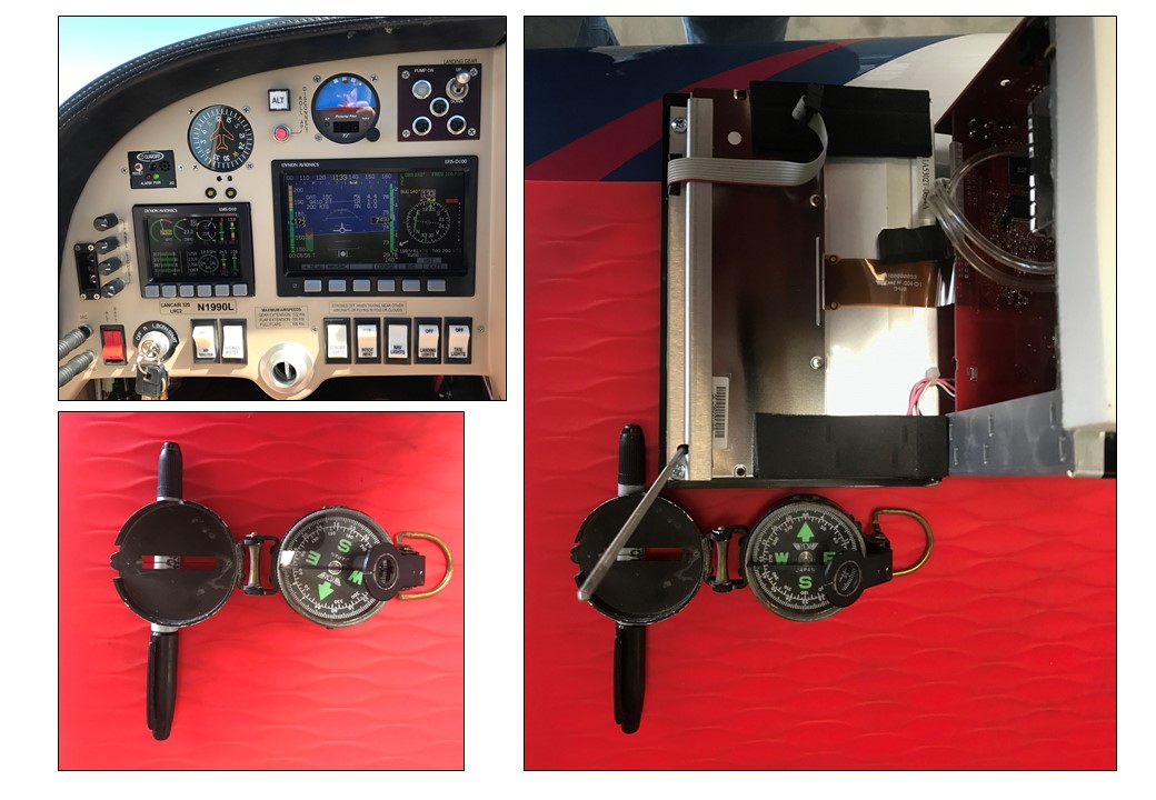

The next photo below shows a compass correctly pointing North and the second shows it after rotating to point to the EFIS display, folded out from the box of electronics and sensors. The magnetization appears to be concentrated halfway up the left side of the display.
Dynon Technical Support deny there is anything wrong and my eventual request to buy a replacement display went unanswered. This led to a google search for a demagnetizer that found many plausible devices for up to a few hundred dollars that's no doubt less than a new display. Can anyone advise if it's feasible to demagnetize a display screen and offer any tips, or ideas as to how the display became magnetized?
I understand that a standalone magnetic compass isn't required if you have an remote electronic magnetometer but I appreciate the redundancy and the units did after all coexist harmoniously for some years.
Thanks in advance!!

This is indeed very odd. The D-100 case is made of alum, I think.
Anything inside could possibly be a power-supply coil, but that should
not be a permanent magnet. Long shot -- try to remove the battery pack.
How old is the D-100? Still under warranty?
I would be tempted to carefully use a simple demagnetizer. Radio Shack
used to sell them for something like $20. Tapehead demagnetizer.
Finn

Thanks to all for the quick replies. It's not the battery -- I removed it and checked. Nor is it the aluminum carcass that I also removed before partially disconnecting the display and folding it down so the face rests on the bench. The photo shows the compass pointing at the display with the back side up.
I'm as certain as I can be that the magnetism is "something" at the edge of the screen. The Dynon unit is over ten years old and had 300 hours of faultless performance behind it before this happened.
I've had excellent service up until now from Dynon--several issues with the EMS were dealt with promptly and effectively. And the 360 degree taxi test with and without the EFIS in place was suggested by one of the Dynon guys on the stand at Sun-n-Fun.

Chris,
Just a thought here - have you tried to place the D100 near other compass
indicators to verify that the D100 is indeed magnetized? (The compass on
your iPhone (if that is what you have) is apparently not affected by a
nearby magnet!). Did you move it around and rotate it to see if the
apparent magnetism is localized at some point in the D100? Is it possible
that you had a steel screw or nut to secure the unit in place? What would
happen if you removed both units from the panel and positioned them in
various arrangements in magnetically benign area?
Just thinking out loud!
Doug Windhorn

Is that a steel rod holding the display in place?
Anything steel or iron, if removable do so.
Then simply demagnetize it.
Actually, the D-100 has a remote compass, right?
If so I don't see any reason you couldn't demagnetize the D-100. Others
here may give good reasons why not.
Finn

Today I positioned a hand-held compass near my 10 year old D-180 screen.
The compass swung 130 degrees as it neared the left side of the screen, just
like cskelt's. Luckily my plane has a remote magnetometer, no panel mounted
compass. The master switch was off during the test. My instrument panel
does not have steel parts, just aluminum.

Thank you Joe Gores as a 10 year old D180 and D100 of similar vintage presumably share a screen type, so this isn't a unique phenomenon. What Joe's data point can't tell us is whether his magnetism was always present or occurred recently, like mine, after years of non-magnetic functioning.
In reply to Doug Windhorn's post, I removed the compass and D100 from the panel, opened up the D100, and folded out the display to persuade myself that the magnetism was in the display, not the electronics in the carcass, and to establish that it's permanent magnetism, not RF interference from live avionics. I used the panel mount compass and a hiking compass. The (admittedly rather cryptic) photos in the original post were intended to illustrate this. The threaded steel rod that locks the EFIS into the mounting tray does not appear to be magnetized.
If these devices do indeed spontaneously magnetize, the need is for a demagnetizer, not a replacement screen, as the latter would be a relatively expensive and potentially only temporary fix.

Upon further investigation, I don't think my D-180 display is magnetized after
all. I pulled the D-180 part way out of the instrument panel without
disconnecting any cables. Then I moved the compass around. The magnetic
interference seemed to be stronger under the instrument panel. Eventually I
determined that the control stick is magnetized and attracts the south end of
the compass needle. As I moved the compass around the control stick, the
needle always pointed at the stick. Sorry about posting an incorrect data point yesterday.

I have a SIRS floating magnetic compass mounted on top of my glareshield in a Glastar. I also have a Dynon D10A which was removed from the panel a couple years ago (and has been sitting in a cabinet at home since) and which had no electrical connections to it for the following experiment. Aircraft power was off. Both left and right sides of the D10A screen were placed in proximity to the compass with the following results:
D10A right side: No effect at 4”. Abt 1 deg at 2” and abt 2-3 deg in contact with the compass.
D10A left side: No effect at 6”, abt 1 deg at 4”, abt 2 deg at 2” and 11 deg in contact with the compass. So the left side has more impact than the right side.
The location of the D10A when installed in the aircraft was over 6” from the compass, so I never noticed any impact from the installation arrangement.
Not sure what the meaning of the above is, but there is some magnetic affect not associated with current passing through the D10A (and probably other similar display devices). It is apparent also that separating a magnetic compass from display screens of any sort, and steel aircraft frames, is probably a prudent move.
Doug Windhorn

The mystery of the magnetized EFIS has been solved. Don Jones of Dynon Technical Support offered to send me a remanufactured D100 EFIS to swap out and to test mine at their shop. I determined that the replacement had barely measurable permanent magnetism in the same location as the original, but it was not enough to affect the panel mount compass nearby.
I installed it in the panel, did an approximate compass swing using our local taxiway centerlines as a reference for the cardinal points—close enough for our purposes as magnetic deviation is minimal here. The figure shows good agreement in cruise between EFIS and panel mount compass. No doubt a more rigorous compass swing would improve things further.
Don sent me his findings.
“I have looked into the magnetized D100. As you noted, it is the LCD that is the source. More specifically the thin stainless frame around the LCD. Early version LCD's (like yours) apparently have a stainless alloy frame that can be magnetized, later versions (bright screen models) have a better stainless alloy and won't stick to a magnet. The replacement we sent has the later version.”
The panel mounted compass reads the same whether the master switch and avionics switches are on or off, and whether or not the engine is running. Carefully following Bob's guidelines in the Aero-Electric Connection while building no doubt helped!
It should go without saying that I couldn’t be happier with Dynon’s support, the performance of the replacement unit, and that I’m confident the problem won’t return. Many thanks to Don for his follow up that led to a successful conclusion.
