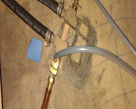

Matt,
Sorry I don't know you or your kit, but I have done my own Mod33 fuel drain for years.
About 5 aircraft have a simple 90 degree fitting epoxied to the floor of the aft floor behind the flaps so it is easy to drain.
Make a pair of holes in the aft baggage bay area beyond the flap. Hole should fit a 1/2 inch socket for the Safeair drain.
Attach the Safeair to a 1/8" NPT 90 degree fitting. Brass or aluminum is OK.
Grease your socket and insert into your sealed and prepared drain hole.
Place the 90 degree and drain assembly and glue in with Redux.
A variation is to make a ply plate for the 90 degree/drain assembly and redux the assembly to the plate then simply glue the plate into your prepped holes. Very neat. Simply remove the Safeair and screw in a plug during painting.

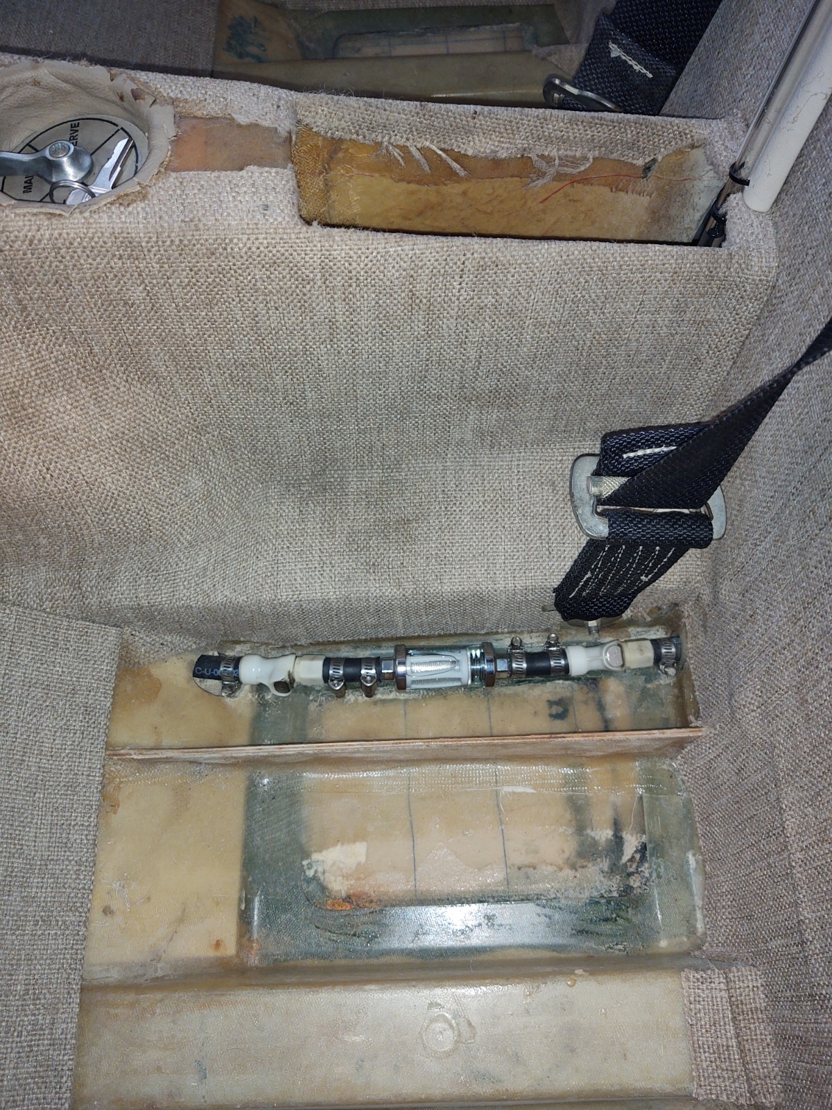

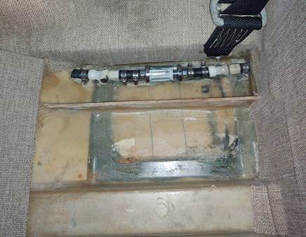

I have a street tee screwed into the two 90 degree brass fittings for my fuel quantity experiment pictured below.
The orangish tube is my sight gauge which was added after the original build. Today I pipe it into the Fuel Boss.
Most of my Trigear guys put the drains in the tank fuel boss.
Mono guys put them behind the wing.
Below is a typical under the belly fuel drain using a simple 1/8 NPT nipple and a tee to make a drain and sight gauge line.

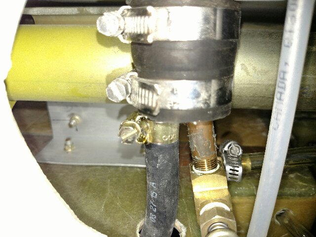

There are as many variations as there are airplanes.  Note I put my feed line through the back and into the seat well where I install fuel filters with quick disconnects.
I’m lazy. I have a fuel drain pan and drain hole just in case there is a leak.

I've never had a problem with mine. Not even the quick disconnects or those plastic filter elements.
As the dealer I kept mine stock for obvious reasons. I've never found that these were delicate or easily broken unless dropped.
I've grown to like them. There is a technique, and with the setup I have, are well protected.
My technique is to Loctite the fixed end of the tube, change the rubber rings, tighten the filters down, add the spring per the manual,
Wrench down the ends just snug to note compression. Allow to set while I do the other filter, then tighten one more time until I'm satisfied the glass is compressed into the rubber.
After install and full of fuel, I check them again after a few hours to be sure there are no leaks and press on.
Operationally, I check them after fueling for debris, (with a 914 I run a pump and let the fuel run through the filters on both sides to check for debris), then change them annually or when dirty (which is never).
$10 a year.
I use AvGas so, I get by longer than those using Jerry Cans and auto fuel.
I keep a spare in my cross country kit bag ready to go.
One of my clients put a metal polished camping mirror (piece of polished stainless) under his filters so he can see the bottom of the filter easier. Nice touch.

The gates hose was never the problem. The plastic filter was installed where the hose immediately bent after the barb. Heck of a way to install, especially with a plastic $2.00 filter. When he cranked down on the hose clamp he flexed the hose and the filter snaped. The Breezer was a ELSA and we think it may have been an owner operator installation issue as it was the first Breezer I had seen come through here. No plastic part should ever be held in bending. That was dumb.
As far as hose clamps go, we use what we call Breeze clamps rather than the garden hose type. They look the same but are more robust and the screw doesn't protrude into the hose. However, expediency sometimes dictates the automotive supply shop "only has this type", and on the smaller vent hoses the cheap Chinese knock off Breeze type clamps will get used when the client comes with them. You are right, the cheap knock off open cut clamps when over tightened can cut the hose, and the rubber can poke through the gap or they just break. Nasty. I have moved on hose exchanges to the newer style silicone hose lined clamps supplied by my hose vender. Easy to use, a bit heavy, protects the hose. The name on them is AC Delco but I also see Ideal. They work fine on 5/16 hose but not on 1/4 inch. Then the compression or Oetiker clamp comes in handy for those.
Why do I choose not to like compression style clamps? Because I do not like to use them in a low pressure carbureted system hose when it comes to removal. They get stuck on the hose and are a pain to get off when the client overtightens and the barb end gets buried in the hose. Especially when repositioning, which occurs during the learning phase. It's like the clamps on the 11mm crossover tube on the Rotax. Trying to find new hose that doesn't cost $10 a foot plus shipping is a pain over here. So, I prefer the Ideal or Dayco lined clamps for my main lines on a change out as I've gone to all 5/16 hose in the Europa so only one fuel line is in the plane. Easier to buy/replace come hose change time. I'm lazy.
Although many LSA manufacturers are going to the crimp type or Oetiker clamp in production. From a production point of view I can see them, but I'm not excited about the fact they are one time use. Probably because during fabrication you take it apart and put it together a couple times. I can see the point that if the clamp area is easily accessed, getting a tool in there is not a problem. I've never had a leak with an Oetiker clamp, but then again, I'm not going to use them on a fuel filter.
That is why I prefer to do my bosses now with all the joints on the end of the boss and minimize the clamps. We can do that in the US on our own. Others have to ask or get permission for a deviation. Shame.
On my filters I use the Colder products quick disconnects. I have a love/hate relationship with them, but for 20 years they only require new O rings on the male ends and have never leaked unless the O ring gets cut. That is why I also hate them. The stupid locking collar will cut the O ring if care is not taken. That way the hose clamps go on and stay on for 5 years on the quick disconnects.
Note, I'm on year 7 with the hoses in 12AY with the lined EPA lined R7 or better carb hose. It is really holding up very well. It is still supple, no cracking seen on the ends, and no checking at the clamps. So, the original 1997 Europa supplied Ideal clamps of steel will probably corrode off before the hose starts looking bad. Maybe next year I'll do a hose change. Maybe not?
