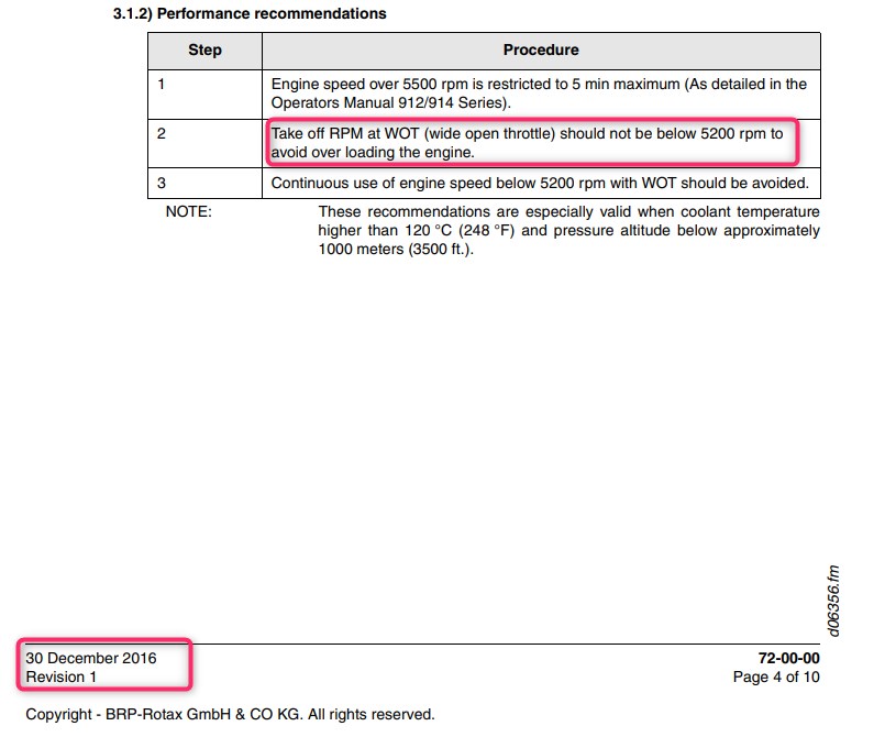

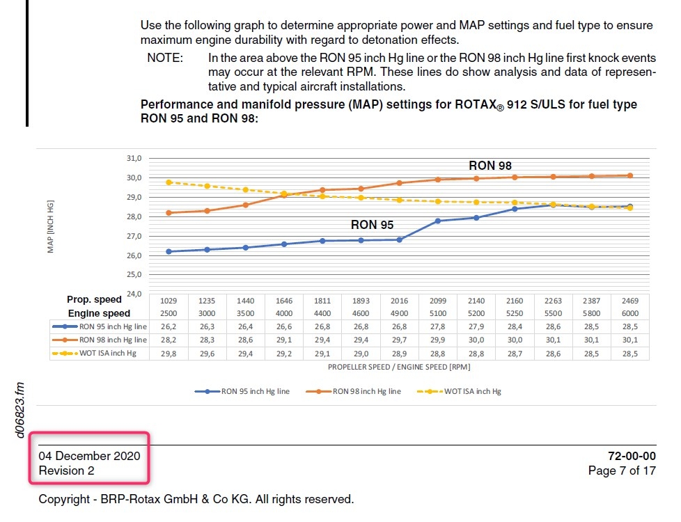

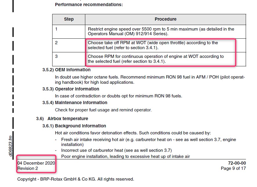

Duncan McFadyean wrote:
The SL (SL-912-016R1) doesn't say what is being reported in this thread. It says:
"Continuous use of engine speed below 5200 rpm must follow manifold pressure graph...."
<snip>
Duncan McF.
Actually, another part of SL-912-016R1 (and the original issue, page 4) says exactly what was reported, but R2 (4 Dec 2020) has now changed - it now refers you to an exciting RPM/MAP/RON graph.
HTH
Paul

Thanks Paul for backing me up.
I don't normally post on forums but was just trying to help people with the correct info from rotax.
R1 actually states that line you copied, and I posted, three times.

Soooo!
After all that, the advice remains;
For fixed pitch propellers (including ground adjust) - setting pitch to get a minimum 5200 rpm Static - will give you 5200 rpm on initiating take off (WOT) with the engine speed climbing as air speeds increases. Adjust climb angle to keep engine rpm below red line.
Cruise Climb & Cruise should be at a minimum of 5200 rpm.
In a nut shell - Rotax 91 engines thrive on /love rpm - you are not doing them any favours operating below the Rotax recommended engine speeds.

I want to thank all of you that participated in this discussion. I personally have to say I have learned a lot in the subject of operating a Europa with a GA prop.
I think that of particular value has been all the data received regarding RPM/MAP and speeds for the Europa monowheel.
The discovery of the latest Rotax SL-912-016 is of particular interest. I still need to read this SL in detail but the chart presented is a total departure from all the information presented in the past. If I interpret it correctly, with RON 95, you have to be at 5500 RPM to be 100% sure you will not have a detonation event at WOT. On the other hand, anything over 4000 RPM with RON 98 (at) WOT is safe.
In the usual Rotax way, it leaves you scratching your head but I welcome the change. For now I decided to switch to premium 93 octane (US) straight E10 fuel. I was using 50-50 ethanol free 90 and premium 93 but in light of this chart I think the gain is safety, while I experiment with my prop, is huge if using the higher grade gasoline.
But one set of data is of particular interest to me and would like to discuss further:
JohnFrance: Your claim of being able to cruise at 5100/28" at 135 kts (indicated?) while still climb 5200/WOT at 65 kts is amazing and want to learn more. I do have a DUC Swirl that makes similar claims and once I finish testing my Woodcomp (which is not looking very impressive so far) I will try the DUC. But would like to learn more about this EProps V20.
