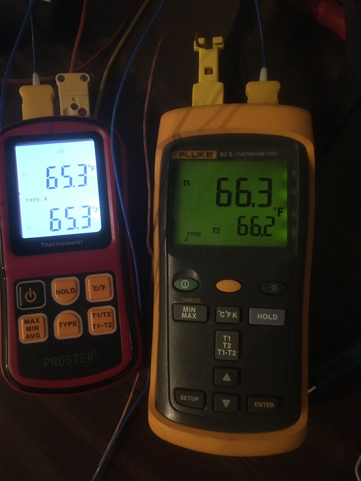

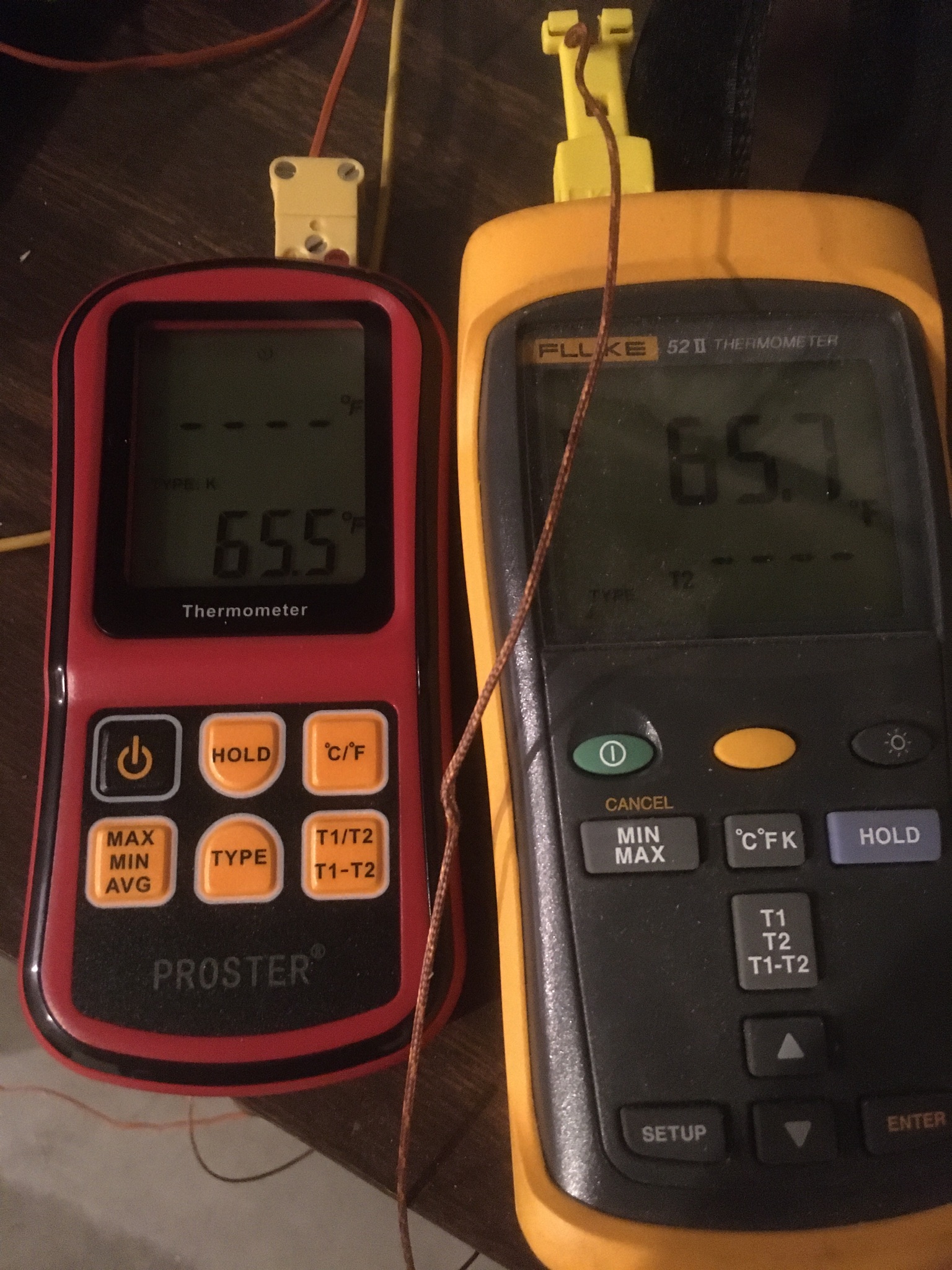

PostPosted: Thu Apr 08, 2021 4:57 am    Post subject: Re: Thermocouple Accuracy Reply with quote
I like Charlie’s suggestion of checking other calibration configurations on the MGL.
To respond to Mike’s first question, “is 10 degrees close enough?”
It probably depends on your expectations and willingness to accommodate a known error in your Temperatures. Knowing the source of the error and insuring it remains constant is probably as important.
Personally, I would not accept it as “good enough.”
A second method of measurement is often useful. I purchased a very low cost unit to compare to my trusted Fluke.
The attached photo shows a 1 degree difference in one photo but it is due to elevating the TC bulb at different heights from the floor.
I swapped the 4 TC probes I had between the two meters in various combinations and could not see any difference in response or value reported between the Fluke and the low cost alternative. Two of the probes came with the meter and two were from Omegs.
My conclusion on first sampling of the low cost TC meter is that it is quite adequate. No telling how well it will perform a year from now, for sure. Only time will tell.
Dan Theis
https://www.amazon.com/dp/B071V7T6TZ?psc=1&smid=A1L1WUWYKZGTBQ&ref_=chk_typ_imgToDp
