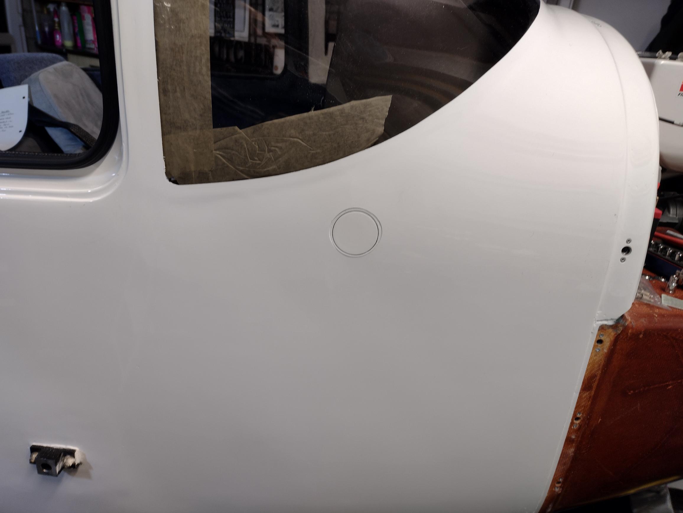

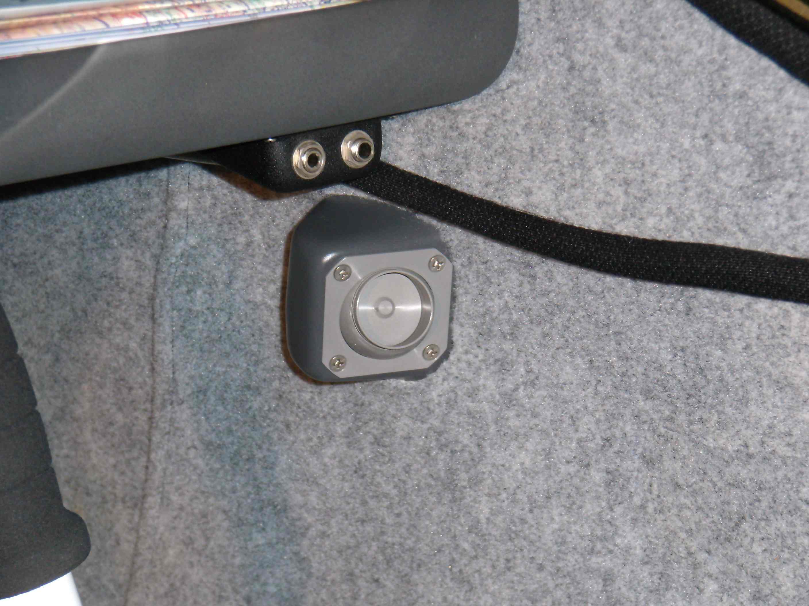

[img]cid:eacc0cb5-db05-4d42-8ccd-66159d19050b[/img]
Hi Patrick
I only fitted this last night. It took a lot of deliberation!!
The position is quite limited once you sit in and consider where your legs go.
I'm hoping to get the port side fitted tonight........... fingers crossed.

I am just in the process of installing the round style air o vents.
could i please get feedback on the best possible location and what worked well before i comit to the hole in the fuselage.
Images would really help.
Pat

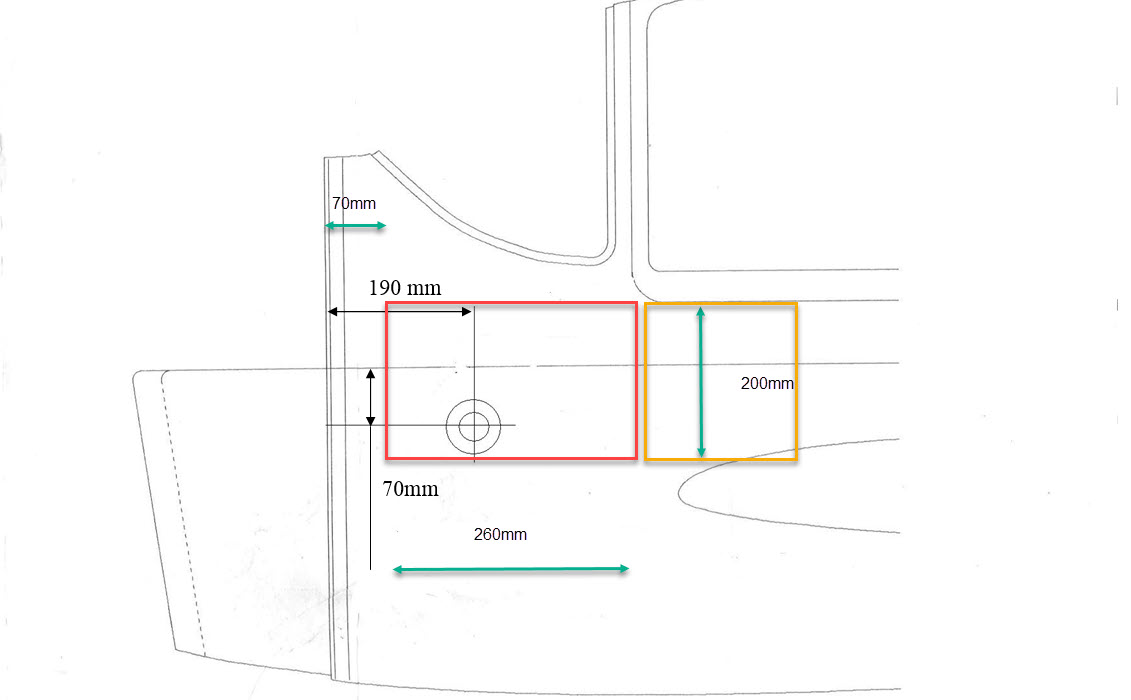

PostPosted: Mon Mar 29, 2021 11:59 pm    Post subject: Re: Vents Reply with quote
This is the sketch of the vent position.
The red boundary is the recommended zone.
The yellow boundary is generally considered too far back.

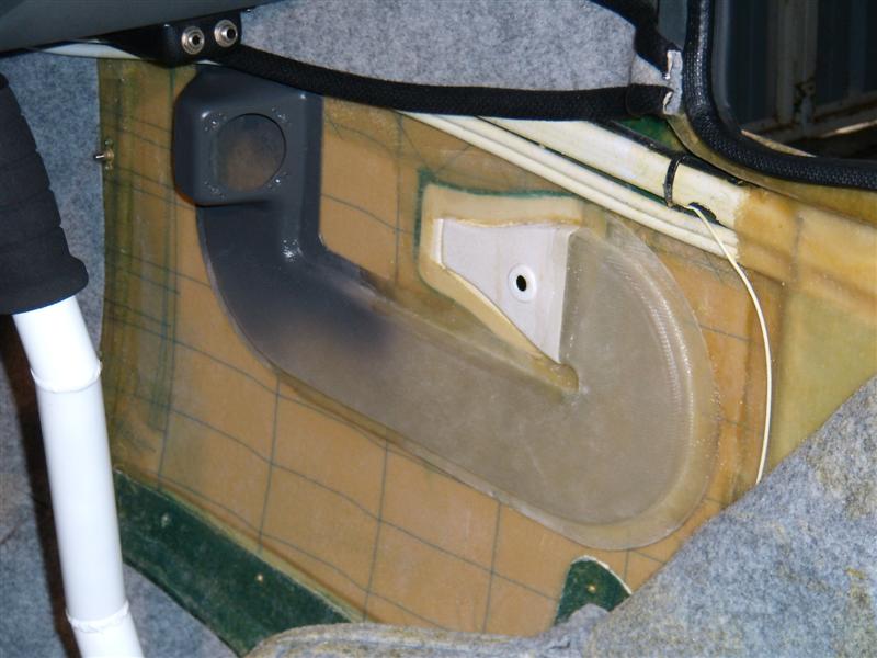

PostPosted: Tue Mar 30, 2021 7:39 am    Post subject: Re: Vents Reply with quote
The attached pictures illustrates what I did to improve the original Naca vents on my Europa. Works very well. For details read my article in EF84.
Remi

Many thanks Steve
The location is pretty much in line with my thinking and also comments from other owners i have spoke to that felt the vents needed to be higher than the europa reference position.
Pat

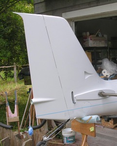

PostPosted: Wed Mar 31, 2021 1:55 pm    Post subject: vents Reply with quote

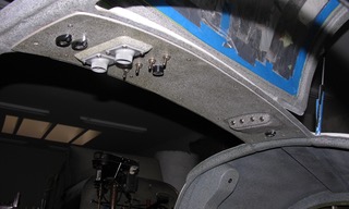

NACA vent in vertical fin leads to adjustable overhead outlets…feeds thru overhead plenum...very effective; one can feel the fresh air at the outlet even during engine idle…kudos for idea from Jeff Behrnes.

PostPosted: Wed Mar 31, 2021 2:24 pm    Post subject: vents Reply with quote
Thanks, Fred. The official Baby Blue A/C system... Smile
Jeff

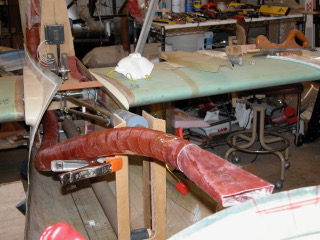

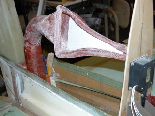

PostPosted: Wed Mar 31, 2021 9:32 pm    Post subject: Vents Reply with quote

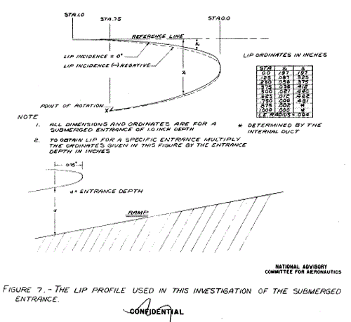

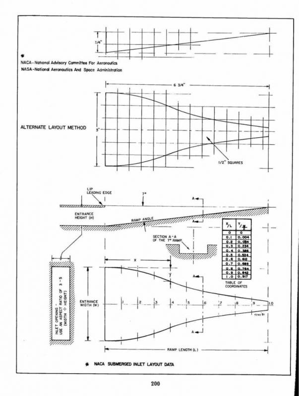

For design of "NACA Submerged Inlets" (search this) - lots of reports
and drawings etc.
However the attached should be enough. Not the corners on the duct must
be sharp to force th eair stream to trip.
Graeme
