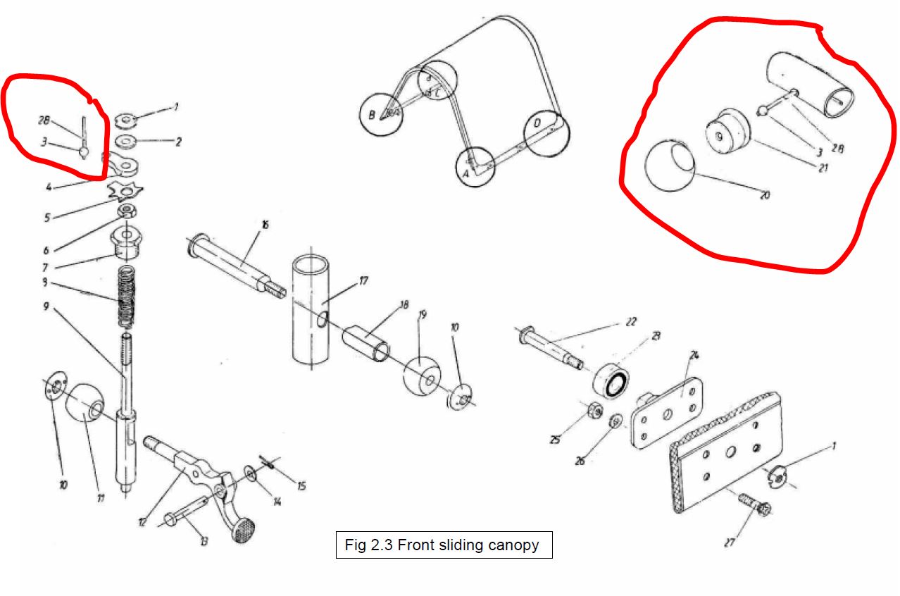

OK,
Need to replace the ball and cable on front canopy of Yak 52.
Need parts and advice on procedure.
See circled items in the IPB.
THXs
YAK 52 IPB

Not a Yak replacement I know!!, BUT I just redid both mine on the CJ. I had the canopies apart for replacement so it was worth while doing while it was all in pieces. Can't say it would be impossible to do without taking the canopy apart but it will be harder.
I replaced the wire with 3/16" wire cable from the local hardware store. I then crimped new ends on and trimmed them. While I had the latch apart I readjusted the tension and the overhead ball pull now lifts the latch pin nicely. I'll see if I have some pictures on my phone I can let you see the end result.
