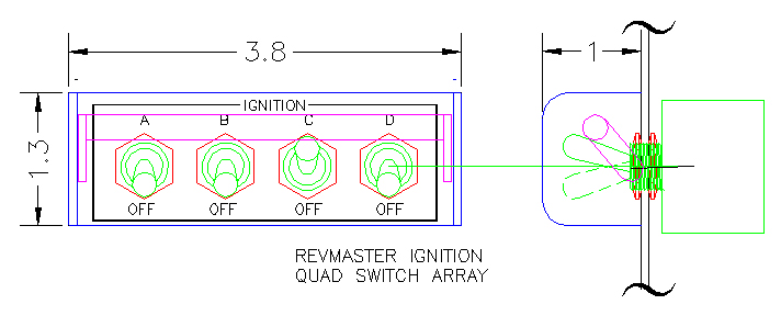

PostPosted: Sun Apr 12, 2020 5:01 pm    Post subject: Revmaster R2300 Ignition Reply with quote
I've been pondering this topic for a few days. The
ignition system on this engine is really rather clever . . .
manipulation of 4 switches in pattern gives you
a 100% check on condition of ignition components!
I think I'd try to avoid adding to the complexity
of this already 'optimized' switching philosophy.
If it were my airplane, I'd craft a shield and
gang bar (magenta and blue) to give me single-stroke
shutdown of all switches. Mounting the switches
on 0.8" centers makes for a compact cluster that
goes to choreographing the toggle-switch-tap-
dance during preflight run up.
 Filesize:  88.23 KB
 Viewed:  12983 Time(s)

PostPosted: Sun Apr 12, 2020 6:59 pm    Post subject: Re: Revmaster R2300 Ignition Reply with quote
[quote]>I think I'd try to avoid adding to the complexity
>dance during preflight run up[/quote]
It's hard to argue common sense. Thanks for all the feedback and above all, thanks for serious consideration of my excursion into unnecessary complexity. I think it's safe to say I've been "talked back from the ledge" and will be installing 4 switches.
