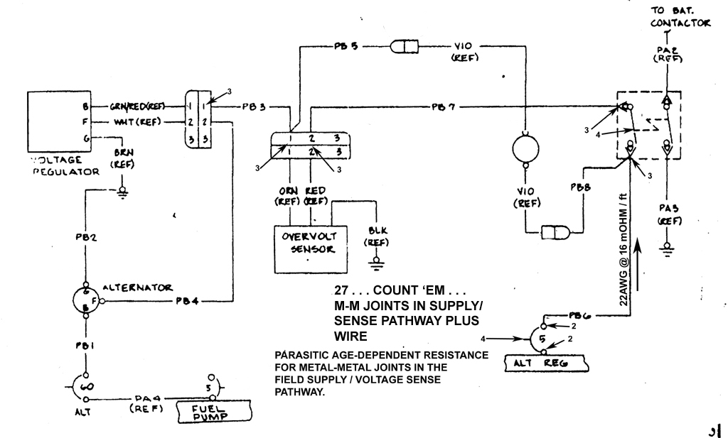

The attached drawing is an excerpt from a Cessna
drawing for alternator installation. I've counted
all the metal-to-metal joints which ADD to the
resistance of the wire (22AWG at 16 milliOhms
per foot) . . . all of which are in series with
the FIELD SUPPLY path of a 3-terminal voltage
regulator. This same pathway doubles as the
VOLTAGE SENSE lead for the regulator.
As long as that total resistance is low (factory
fresh), all is right with the universe. 30 year
old airplanes are another matter. The "galloping
ammeter" phenomenon manifests when total path
resistance rises above a threshold for regulation
stability. We might be talking about a few
hundred milliohms . . . a characteristic you
cannot detect/measure with your ohmmeter.
In some cases, replacing the split rocker switch
'cured' the problem . . . but it is only one of
many contributors to rise in path resistance.
In a relatively short period of time compared to
airplane age, the problem returns because rise
in path resistance has multiple contributors.
This is why I suggested the short-lead, test-regulator
experiment. It gets bypasses all ship's wiring and
accessories. It serves to confirm that root
cause galloping ammeter is too high resistance
in the field-supply/voltage-sense pathway.
