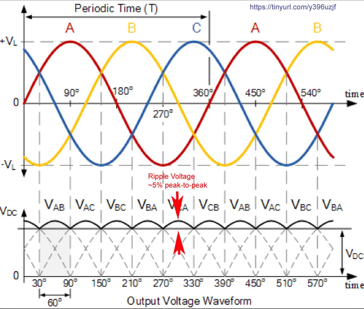

The output from an alternator is trashy. 3-phase, rectified
power has a built-in peak to peak ripple on the order of
13%. So a 14vdc machine can be expected to come with ~2
volts peak-to-peak ripple. There are test tools intended to
diagnose an abnormal increase in this value as a result
of rectifier failure. An open or shorted diode in a
rectifier will produce a marked increase in ripple
voltage.

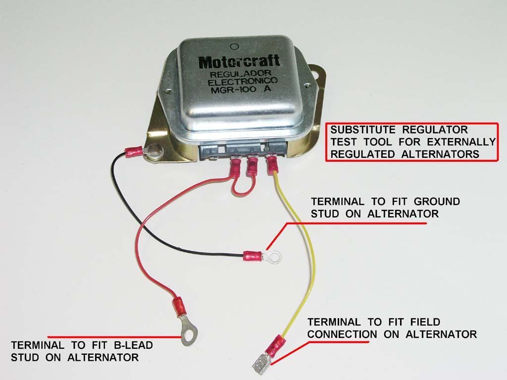

To rule out a regulator failure, you can
use a known good regulator to fabricate
the test-tool shown and wire it to the back
of your alternator for a test fun.
voltage.
