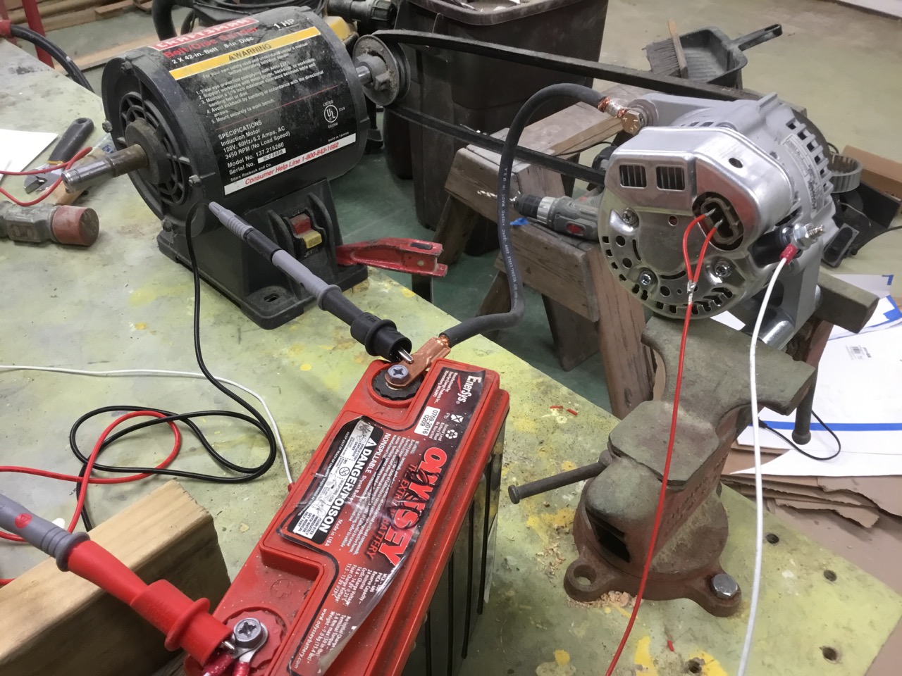

During Covid hibernation I had some time to bench-test a couple of alternators and I found that some were sensitive to low RPM. In other words, some alternators need to spin pretty fast to work properly.
I used a test fixture (picture attached) and used a 3/4 horsepower motor from my shop sander to drive it.  That motor spins at 3450 RPM and I had a pulley configuration of about 1.2:1. So I'm guestimating that the alternator was turning somewhere around 2800 RPM.
Some alternator/regulator combinations that I tested would not self-start at that low RPM. If I momentarily jumped the field, it would generate electricity and regulate normally. When I changed the pulley arrangement to get higher alternator RPM, it would self-start.
Some regulators have a self-starting feature where they won't turn-on until they reach some minimum RPM. It is designed to keep power off the field when the engine is not turning. I have no idea about how the Plane Power devices are supposed to work. (I was testing automotive alternators & regulators)
What I learned:
1. Some alternator/regulator combinations won't work properly until they hit some minimum RPM
2. Manually jumping the field to get it started can be valuable 'cuz it showed the regulator could regulate (was not DOA)
However, Jumping the field may be more challenging on an internal regulator unit???
My test fixture is UGLY. But it worked well and was fast & cheap to build. The 3/4 HP motor mounts to the right on the 2 studs that are sticking up. I would have preferred to use a more powerful motor, at least 1 HP, but none was available, so I went with what I had.  The motor would bog-down with about 25 Amps of load on the alternator.
-Jeff

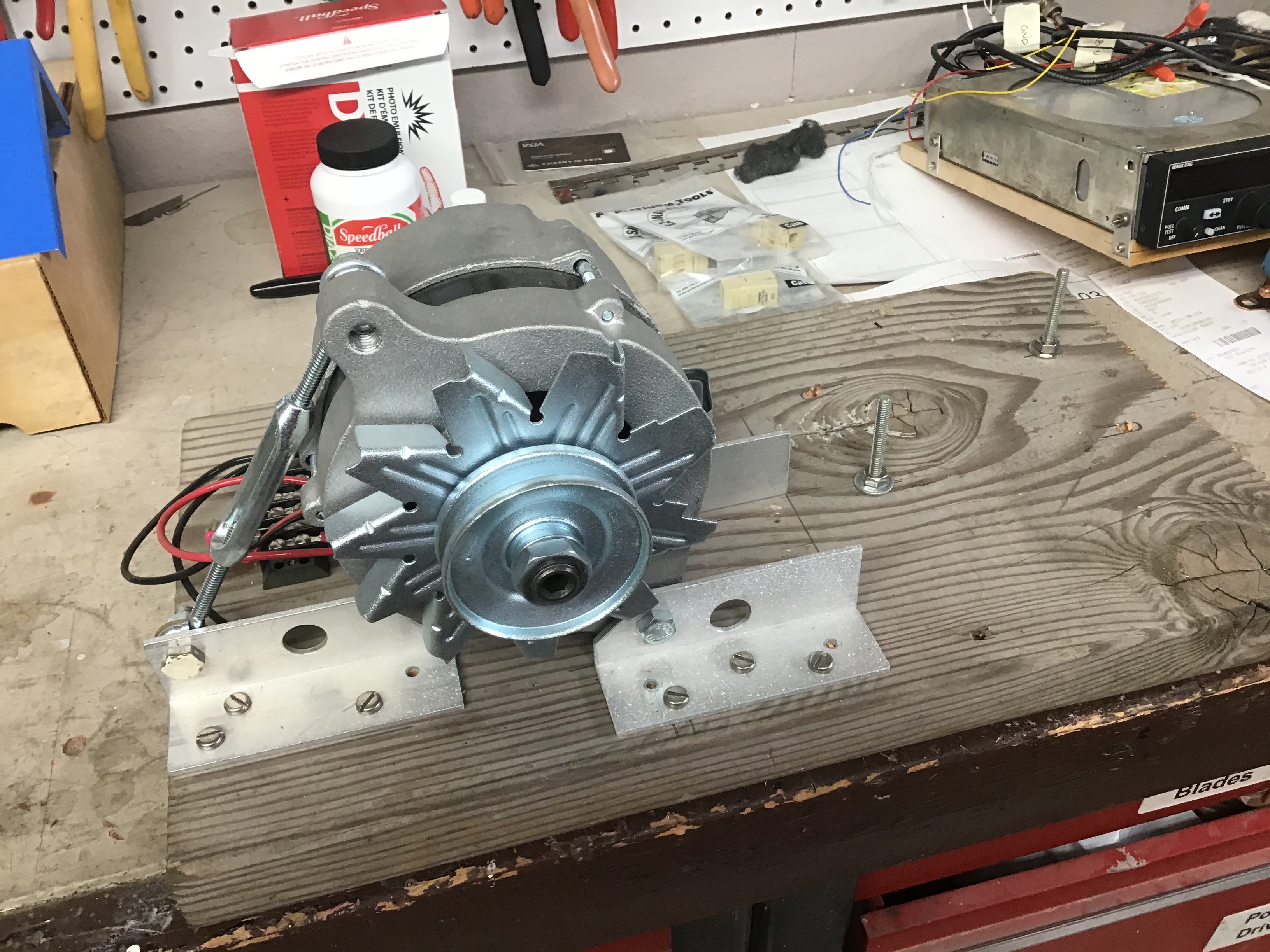

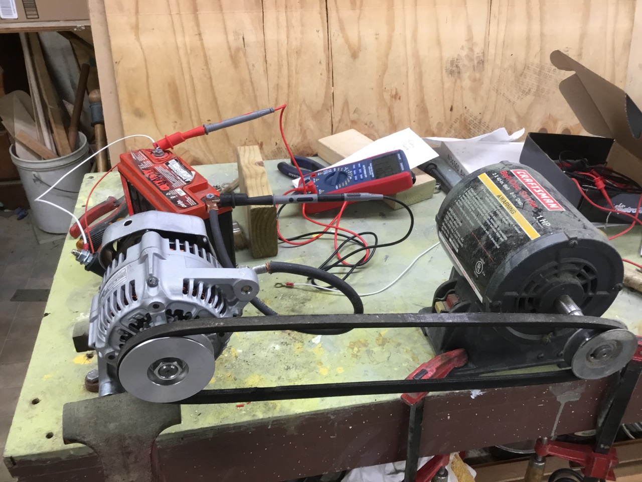

PostPosted: Wed Jan 13, 2021 12:00 pm    Post subject: Alternator bench test Reply with quote
Sounds familiar - I used a belt sander motor also…The question posed is schematically should it work?
Here’s what I had:

PostPosted: Wed Jan 13, 2021 12:42 pm    Post subject: Alternator bench test Reply with quote
David,
I don't know the Plane Power device, so I can't determine if it is wired correctly.
But, based on your pulley configuration, the alternator is turning slower than the motor. So if the Plane Power setup has a minimum RPM, it is very likely turning too slowly in your test fixture.
Wish I could be or more help. There are lots of Listers who know more about the Plane Power equipment.
-Jeff
-Jeff
 Filesize:  296.99 KB
 Viewed:  8327 Time(s)
 Filesize:  333.33 KB
Here’s what I had:
On Jan <alt-setup1.jpeg>
<alt-setup2.jpeg>
13, 2021, at 1:47 PM, Jeff Luckey <jluckey(at)pacbell.net (jluckey(at)pacbell.net)> wrote:
David,
What I learned:
-Jeff
Here’s what I had:
<alt-setup2.jpeg>
David,
What I learned:
-Jeff
 Filesize:  70.21 KB
 Viewed:  8326 Time(s)
