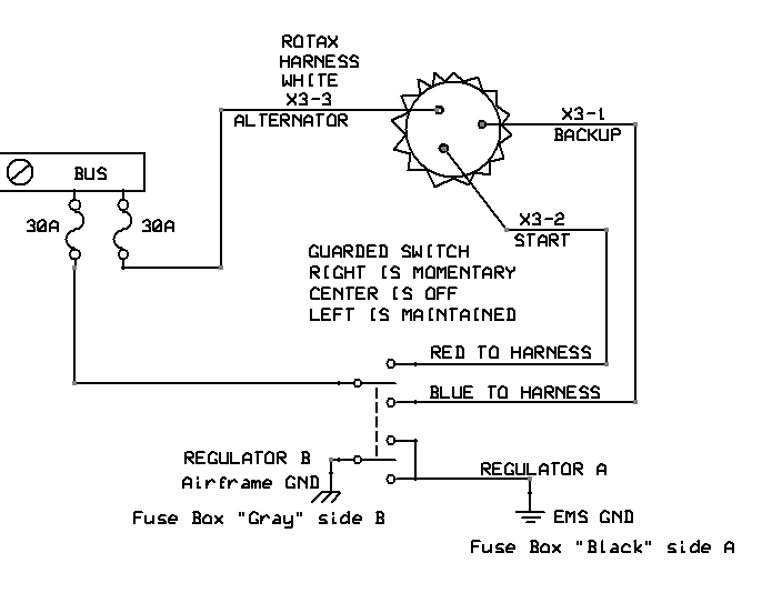

PostPosted: Thu Nov 05, 2020 6:14 am    Post subject: Two Fuse Option Reply with quote
Attached is a schematic using only two fuses.

yellowduckduo(at)gmail.co
PostPosted: Thu Nov 05, 2020 10:02 am    Post subject: Engine compartment fuse? Reply with quote
thanks Joe
It's tough for me but as a new rotax guy I'm trying to just assimilate
into the rotax culture and follow their advice rather than fight it and
do what seems logical since we don't really know what failures or
situations they are trying to cater to.  One possible drawback for
eliminating one of those fuses is that if the start power fuse pops
after the engine has cranked just enough to keep going (rare but not
unknown) it would disable backup power for the flight so I thought I'd
keep all three 30 amp fuses.
I do plane to  use a start power relay similar to the rotax blessed
rs-flight system which at least means the start power won't have to go
to a switch on the instrument panel.
I will add over voltage protection since despite verbal claims otherwise
the current install manual actually says "5. Attention: In failure
conditions the output voltage can exceed the specified limits"
thanks and keep the ideas coming
Ken

PostPosted: Thu Nov 05, 2020 10:19 am    Post subject: Re: Engine compartment fuse? Reply with quote
Having a momentary start enable switch could be advantageous by making it
more difficult for unauthorized people (kids) to start the engine.
