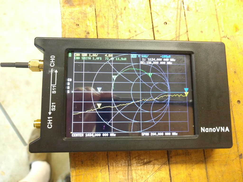

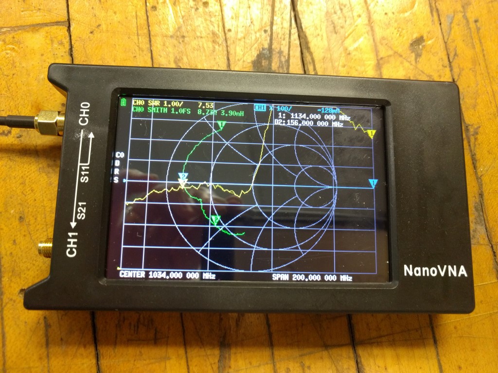

Hello group,
Andrew sent me a couple of the antennas he mentioned, above, to play with (Thanks, Andy), which got me motivated to take my 1st dive into using a nanoVNA.
I promised Andrew I'd share results of testing the two antennas. Let me remind everyone that while I consider myself reasonably adept at electronics troubleshooting (3 or 4 'lives' in electronics maintenance), I'm not formally educated in the field nor am I a HAM operator. I hope the attached images will be viewed more as an invitation to teach me more about how to use the nanoVNA than an actual analysis of the antennas.
Starting from a knowledge level of near zero, here we go: Since Andrew is splitting the signal using one antenna to feed two SDRs that are tuned to 978MHz & 1090MHz,  I set the center frequency on the VNA at the midpoint between the two freqs (1034MHz), & span to 200MHz. On the *very* slim chance that I set up the VNA correctly, It looks like the dipole has a worst case SWR of around 4.6 & the Slim Jim was basically off the chart at 1090MHz.Measurements were taken with the antennas hanging on the 6" long cable that came with the nanoVNA.
Even if I did the tests correctly, I'm not sure if the above has any real meaning for a receive-only antenna. If there's a better test that can be accomplished with the nanoVNA and someone is willing to walk me through the setup, I'll be happy to run the test(s), or I can forward the antennas to someone with more RF-foo. Shoot me a direct email if you're interested.

PostPosted: Fri Oct 30, 2020 2:39 pm    Post subject: ADS-B and Transponder antenna... Reply with quote
On Fri, Oct 30, 2020 at 4:33 PM andymeyer <meyerkc135(at)gmail.com (meyerkc135(at)gmail.com)> wrote:
--> AeroElectric-List message posted by: "andymeyer" <meyerkc135(at)gmail.com (meyerkc135(at)gmail.com)>
Charlie,
I saw the plots, but I don't know what I'm looking at... Am I way out on frequency, other issues? Any thoughts tyet?
Unfortunately, I'm not sure what I'm seeing, either. I suspect that it has little meaning when for a receive-only antenna, as indicated in the conversation at this site:
https://ham.stackexchange.com/questions/382/what-is-the-relationship-between-swr-and-receive-performance#:~:text=Simplified%20answer%3A,between%20SWR%20and%20receive%20performance.&text=SWR%20is%20a%20measure%20of,between%20the%20transceiver%20and%20antenna.
*IF* I set up the nanoVNA correctly, the graphs indicate a worst case SWR for the dipole of around 4, where the pointer is on the right side of the screen. The J antenna SWR went 'off the chart' at minimal deviation above the center frequency I used,  which was the numeric midpoint between 978MHz & 1090MHz. It should also be noted that getting my hand, or anything else, anywhere near either antenna had significant effects on the SWR. While the SWR looks awful, it probably has no real effect on the antennas' performances when used only to receive a signal, as would be the case with ADSB-in.
I'm afraid that to get any valid numbers on receive quality, we'd have to find someone that can measure the actual signal strength on the two frequencies of interest, when using these antennas.
As I said, I'll be happy to pass them on to someone else, if they can do a better job in testing them.
Sorry that I haven't been able to produce more useful data.
Charlie
