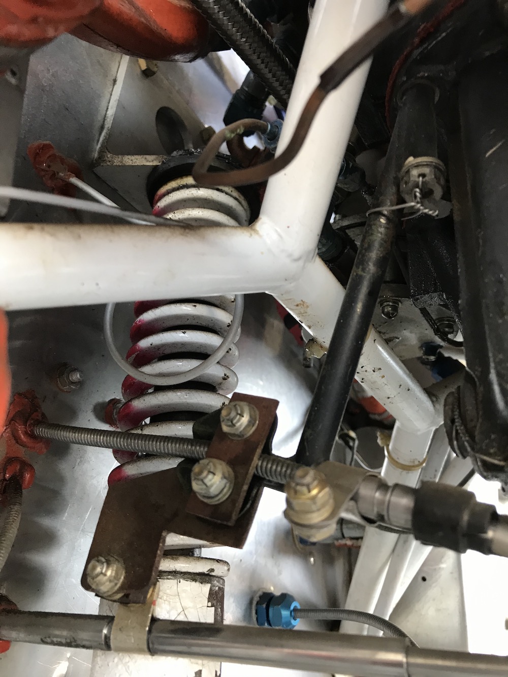

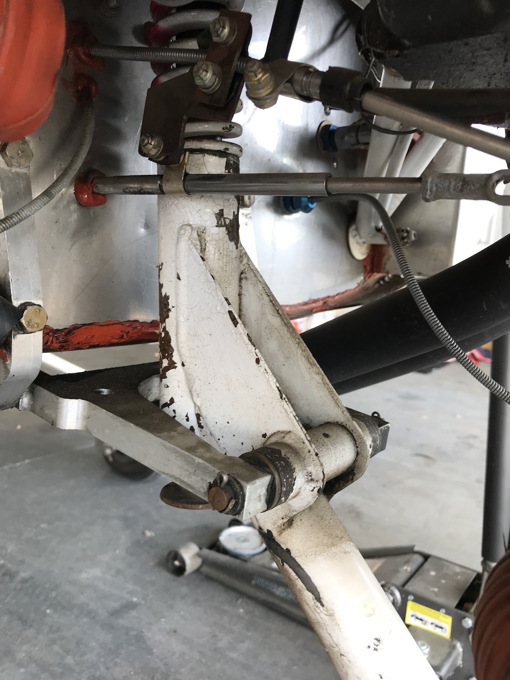

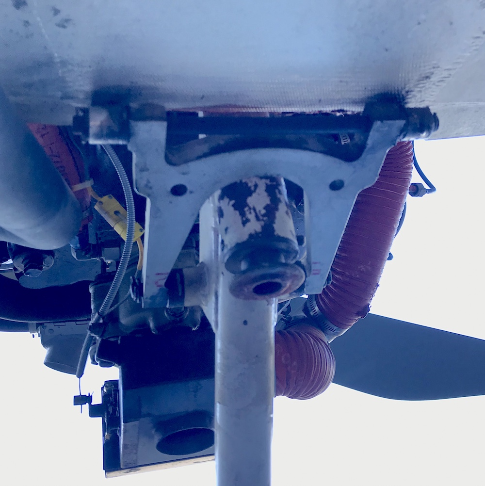

Hi all, I'm in the midst of a pre-buy inspection for a TR-1, and have a couple of questions, that hopefully you can help me answer:

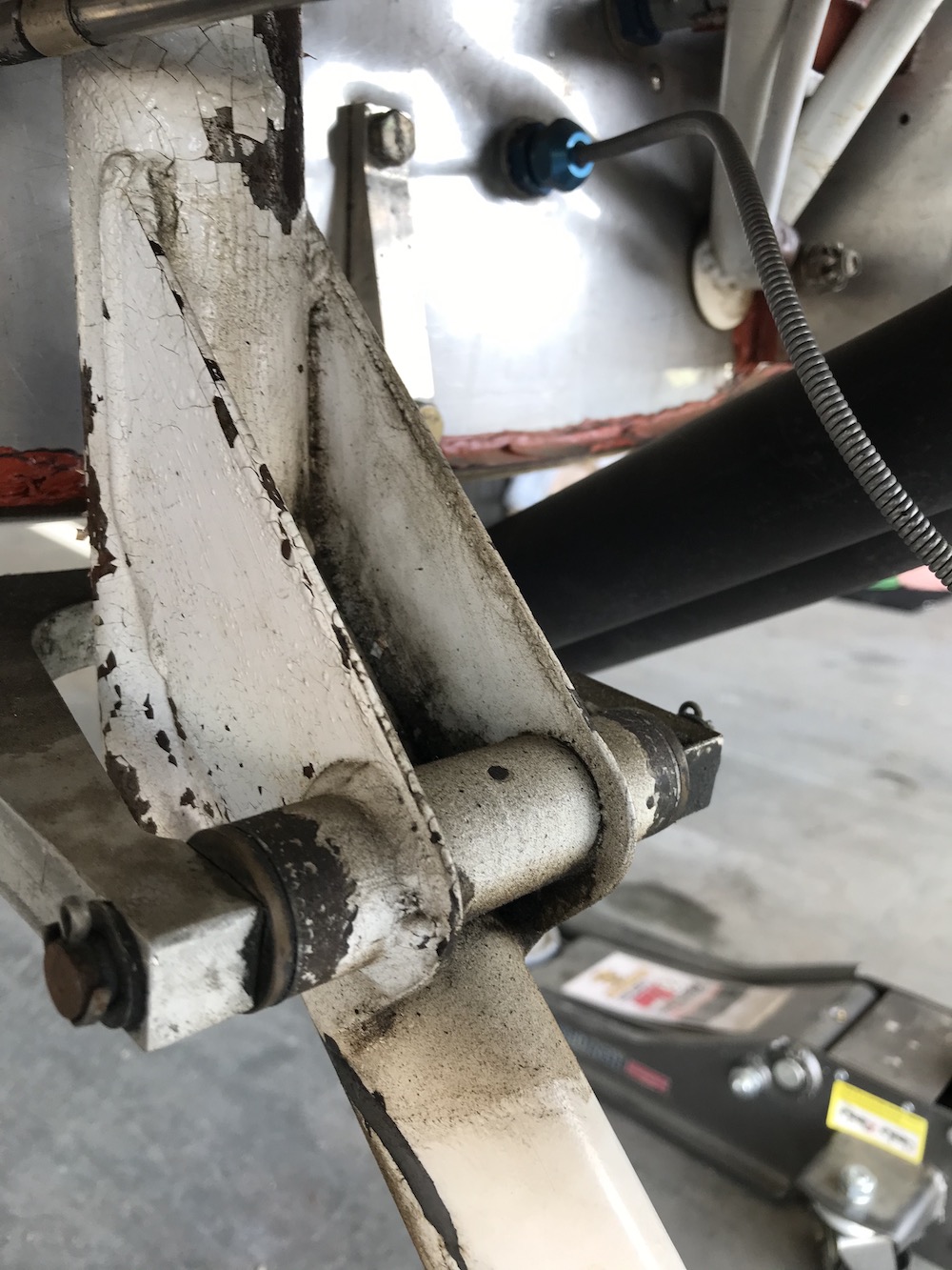

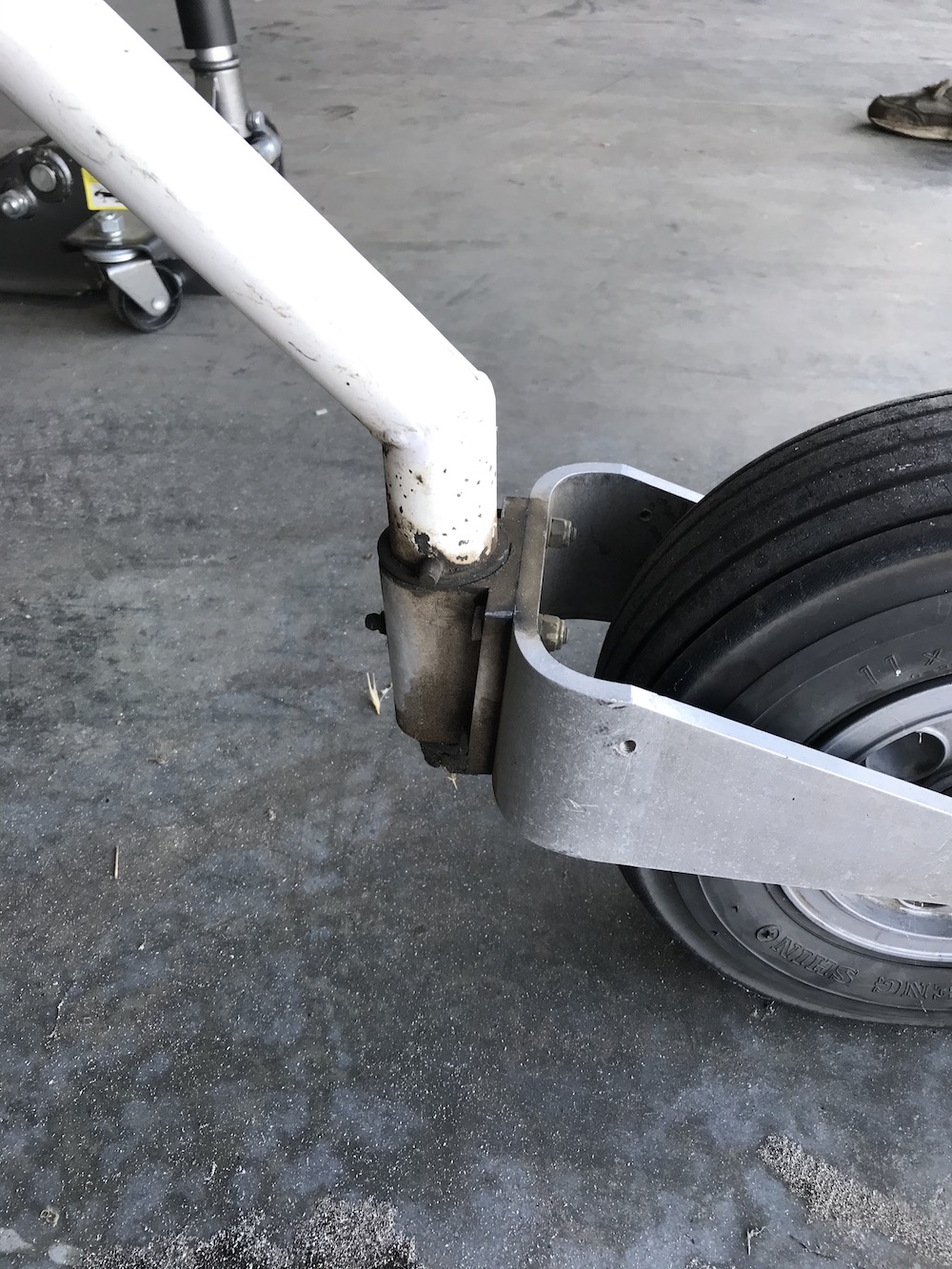

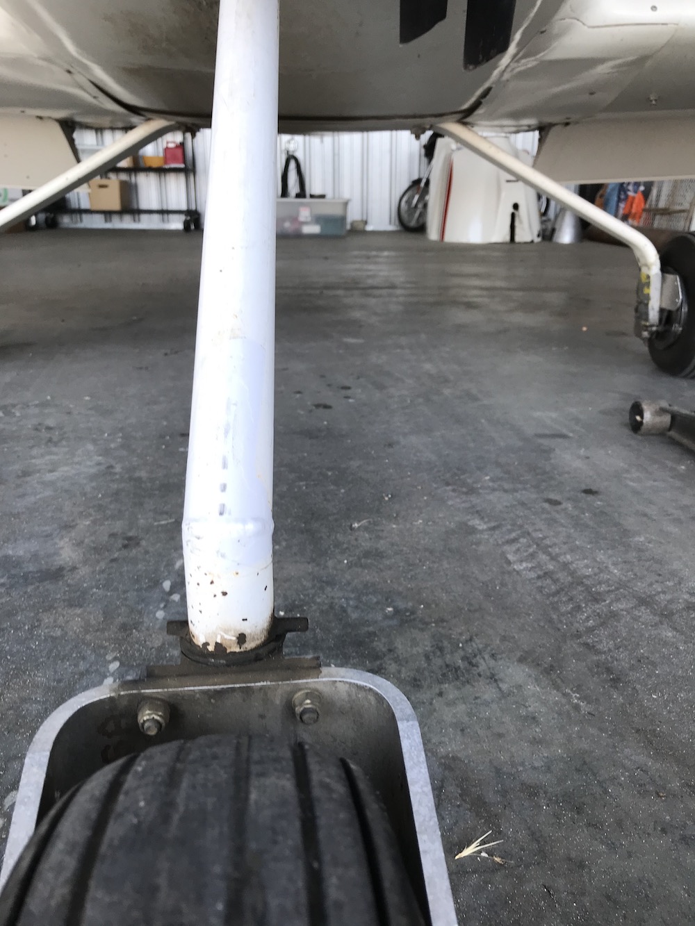

1. Posted below are pics of the nose gear assembly, from these pics can you determine if this is an original model nose gear or a more hardened version?

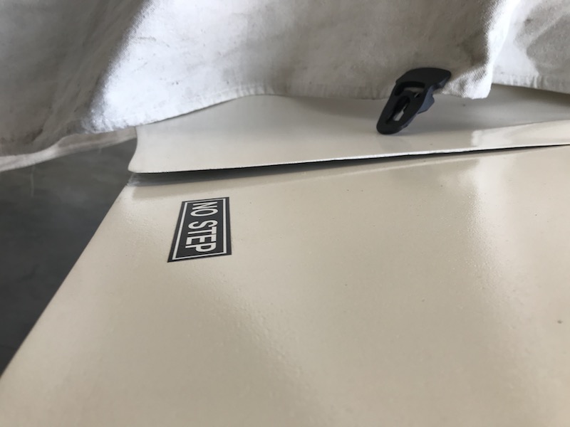

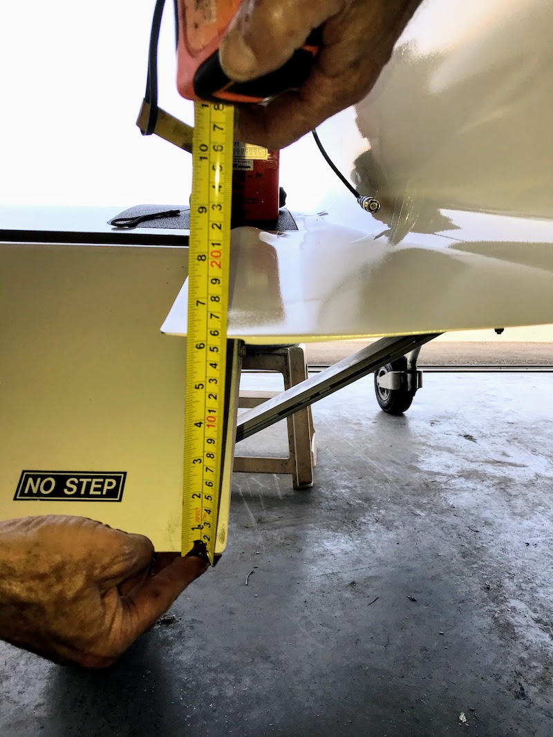

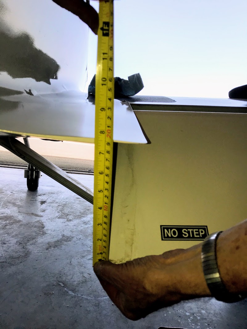

2. Regarding the flaps, the left flap extends down 1.5" lower than the right. Is this an adjustment issue or could there be some intentional purpose to it?
My apology is I've posted too many pics, I wasn't sure which pics are relevant to question 1 above.

I don’t have an answer for you about the TR-1 but your photos look like the gear on the TR-4. The original gear for the TR-4 was linked to rudder pedals and provided nose wheel steering. Those were replaced early on with free castering version.

Hi Jeff,
I fly a TR1 .. Your Nose Gear Leg appears to the Good ... and
appears to be the most recent Hendricks version . I know of 4 versions .
First version was round ( approx 1 inch Dia) formed/shaped .. not strong ...
next 2 versions were 'Airfoil Tube' construction .. and lastly the strongest
Round larger Diameter unit u photo'd .
Regarding Flap extension being 1 and a Half inch different ... that would
alarm me ... a suggest investigate why this is so . !!?? ( they should be
rigged to deploy uniformly together ... and so fly straight and true and
controllable ... departure from 'in unison' Flap Deployment ... introduces
controllability issues/concerns )

Keep in mind the problem with the nose gear was actually the main gear placement. The nose gear should have between 10% and 25% of the weight of the aircraft from the aft CG to forward CG limits. The main gear in the original location would put well over 35% onto the main gear. The main gear so far behind the CG would not only put more static load on the nose gear but would also put a huge dynamic load when the nose would slam down on landing.
If you correct the main gear location by canting the gear forward any of the nose gears are acceptable.

I concur with the others , you are looking at the most recent nose gear assembly from Lyle, this was the heaviest version and the strongest . but one thing missing, is the stop pin that prevents the nose wheel pivoting all the way around , its an easy fix and a worthwhile addition . Marks suggestion about tilting the main gear forward was performed by quite a few  TR1 owners ( including myself ) so it would be worthwhile doing if, it has not been done already. ( again its a simple fix )
The flaps definitely were not designed to be asymmetric, so that does require some investigation , and i would not recommend deploying them until the issue is fully understood .

Keith, thanks for the details, this is really helpful. Here are the two pics taken regarding the flap extension issue. As you'll see there is nothing scientific about how the measurement was done but it was intended to get general guage of the uniformity of the flaps. Essentially I locked the ailerons at a neutral position and the flaps fully extended. I then measured from the flap edge to the aileron edge. Hopefully my measurements are flawed to the extent that no real issue exists with the flaps.
Jeff

aeromomentum(at)yahoo.com
PostPosted: Mon Sep 21, 2020 7:34 am    Post subject: Can you identify this TR-1 nose gear? Reply with quote
Jeff,
I suggest pulling up on the flaps to simulate a wind load while you measure the deployment. I also suggest measureing the angle. Most smart phone will do this with an app like "Clinometer".
Mark

PostPosted: Mon Sep 21, 2020 10:41 am    Post subject: Can you identify this TR-1 nose gear? Reply with quote
The flaps issue is concerning. I built a TR-4, and the flaps used a nylon block sliding in a "U" channel at the flap root. Adjustment to the flaps was by drilling the block offcenter, then rotating it to get the desired setting. This did not allow for fine adjustments if needed, so I designed a 'split flap' by splitting the torque tube and using two arms in the center of the plane. This allowed VERY SMALL adjustments to be made. Details are on Bob Reeds website.
1.5 inches when extended is huge -- what is the difference when retracted?
PostPosted: Mon Sep 21, 2020 11:04 am    Post subject: Can you identify this TR-1 nose gear? Reply with quote
The TR1 flaps have a different linkage than the TR4 with each side having a push rod with adjustable rod ends on both ends so adjustment is fairly easy.

jeffbudner
Joined: 20 Aug 2020
Posts: 18
Location: Rio Vista airport
PostPosted: Tue Sep 22, 2020 12:36 pm    Post subject: Re: Can you identify this TR-1 nose gear? Reply with quote
So it appears that the right flap has some kind of slack issue. In the pick below the right flap is fully retracted but is not flush. The left flap is flush. At the trailing edge it appears to be hanging down about 1/2" - 3/4". Took the pick at the end of day and was too tired to think about measuring.
Jeff
