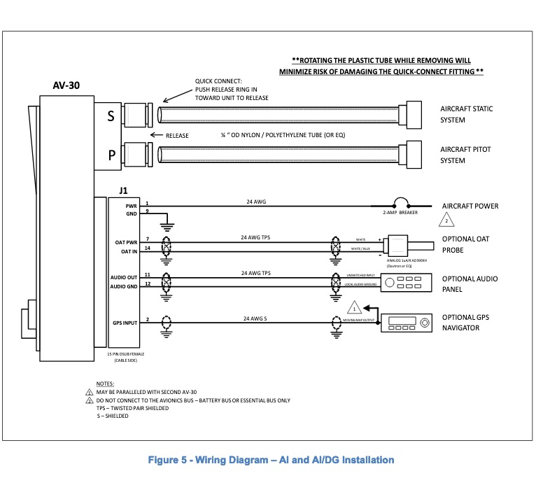

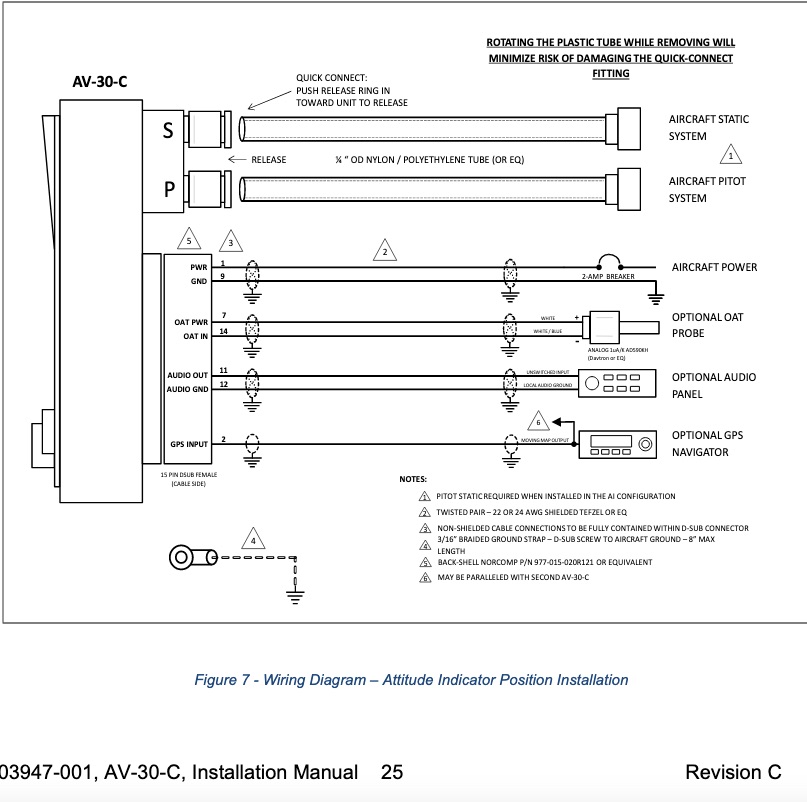

Now that the AV 30 has STC approval for certificated airplanes I have some questions on the wiring differences.
The experimental say power is to be from the battery or essential bus only, the "approved" manual says power is from the avionics bus or main master relay. Can the experimental version also be powered from the avionics bus?
The certified calls for a 3/16" braided ground strap from the of the d-sub back shell, maximum of 8". What would be a similar sized stranded wire, and would the also be a good idea for the experimental version?
On the wiring diagrams some of the shielded wire symbols have an X in them. Does this indicate twisted pair?

Bump, primarily to re-ask the question about the diagrams with the "X" in the shield symbol. Thanks, John

PostPosted: Wed Sep 09, 2020 1:28 pm    Post subject: Re: AV 30 Wiring Reply with quote
I would agree. On the second drawing, the only place TPS is shown is on those wires with the "X".
Although it does appear the shields are grounded in two places. I thought the idea was to always ground the shield at one end.
PostPosted: Thu Sep 10, 2020 7:32 am    Post subject: AV 30 Wiring Reply with quote
At 04:28 PM 9/9/2020, you wrote:
--> AeroElectric-List message posted by: "donjohnston" <don(at)velocity-xl.com>
Yes . . . but.
If the design goal for shielding wires
is to BREAK and electro-static coupling
mode between potential antagonist/victim
wires, then yes . . . connect shield to
one ground only.
SOME installations exploit the shield as
part of the energy management goal. One
example can be seen in the Z-figures where
I recommend GROUNDING a p-lead shield at
the magneto end then using the shield
to provide a GROUND PATH for the switch
at the other end. Some authors have
suggested that p-leads need to be shield
grounded at BOTH ends which has no foundation
in physics and raises risks for some ground
loop issues.
I've also used the shield as a return
path for incandescent bulbs illuminating
a whisky compass. Providing a coaxially
concentric out-and-back path for bulb
currents cancels magnetic fields around
the wire and prevents illumination induced
heading errors.
The best thing to do is follow the
manufacturer's installation instructions.
I cannot assert they are always 'golden'
but there just might be a good reason
for doubling up shield terminations.
