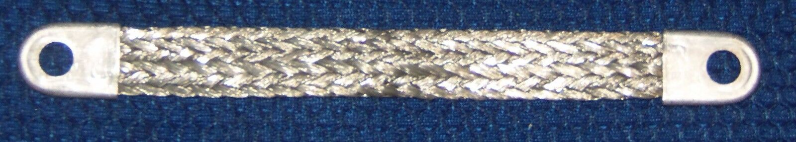

This is the CRANKCASE GROUND . . . usually
a very critical wire in the system.
We normally try to make that connection
with super flexible conductors that are
(1) resistance to flexure failures, (2)
does not impart strong flexure forces to the
terminal.
Alternatively, consider using welding cable.
Again, were looking for a bazillion strands
of copper cat-hair for conductors and flexible-
friendly installation. This article suggests
a method for soldering terminals onto fat
wires
https://tinyurl.com/ct36xen
. . . I need to upgrade that article to
suggest welding cable with double-wall
heat shrink as opposed to the stiff-stuff.
https://tinyurl.com/yysahtcf
Recommend you consider upgrading the two
strands of fat-wire that come off the back
of your engine. Welding cable with heat shrink
dressing won't require additional mechanical
support and you'll enjoy working with this
stuff.
