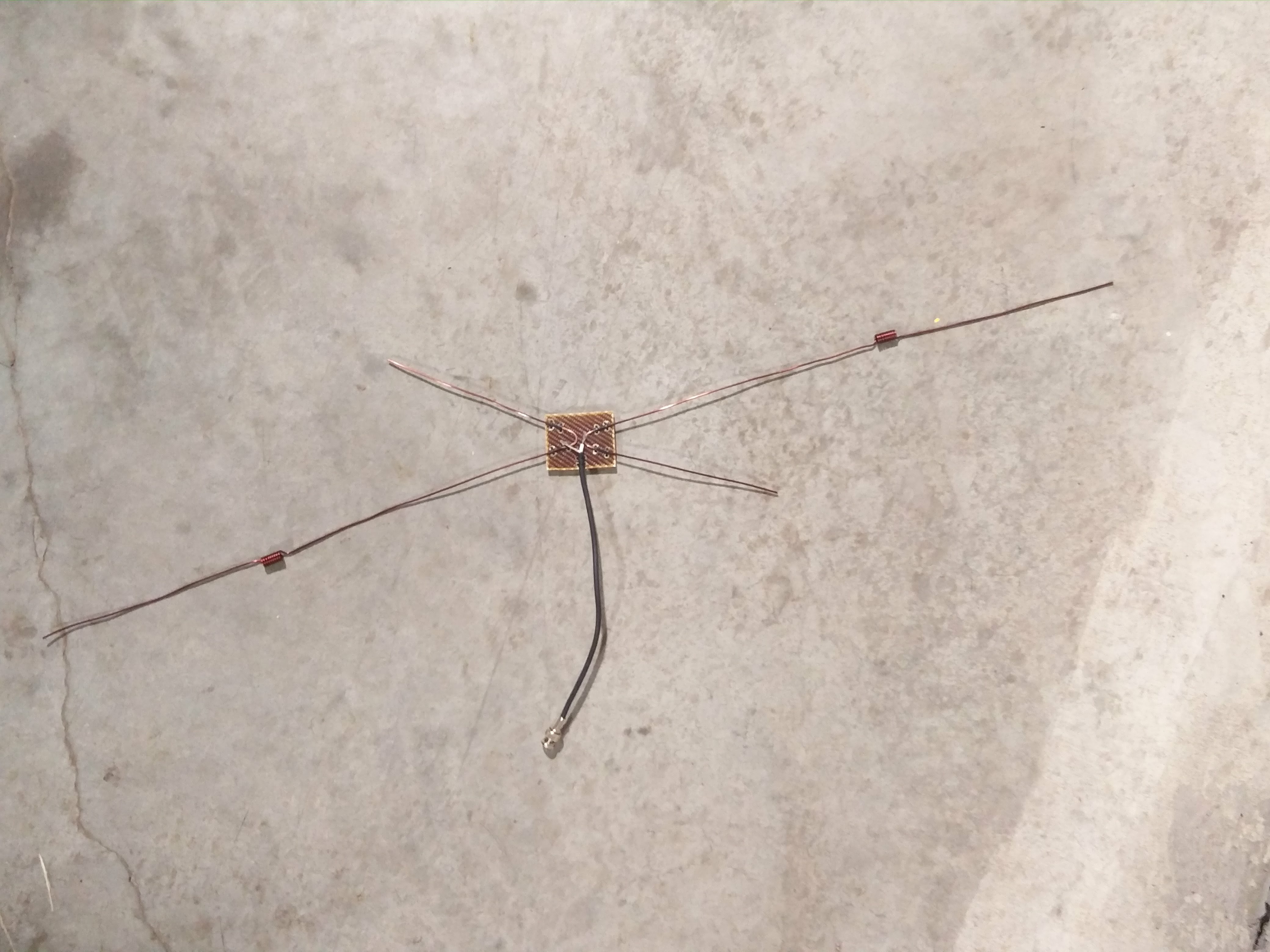

Bob,
Just took a couple photos of my antenna. I did two calibrations, one for Glide slope and one for Localizer.
Not sure how the photos will come out. These are attached.
I don't remember the length I initially used for antenna. I bench tested and it looked OK. After install the freqs changed, most likely due to frame proximity. There are some wire and and ferrites between the connector and the foil. This will take up some length. I had to cut the foil to get in the freq range.
Interesting. I'm wondering if the 'short' elements
are not really functioning as resonant radiators, rather
reactive elements that influence the uhf characteristics
of the overall assembly.

I'm thinking that if you removed the little
'stubs' from the array, your swr plots over
the two band widths of interest would not
be significantly different . . . indeed
both acceptable for the task at hand.
Given the VHF antenna's propensity for acceptable
performance at third harmonic, it is almost a
certainty that the observably 'too small' size
of these stubs is of no benefit to the antenna's
performance.

I agree the VHF antenna (without the GS antenna ears) will work very well for receiving the GS freqs.
I wanted to see how the performance could be enhanced with the antenna tuned to the different bands. The only verifiable method to prove this would be testing the antenna with and without the GS elements. I just don't have the time to do this at the moment. A future test.
I am going crazy getting the Tailwind ready for it's first flight this weekend. Everytime I try something another problem arises. Guess that is why this is experimental aviation.
I do know that trimming the GS elements adjusted the antenna VSWR to the freq range I wanted. I did this in real time by watching my NANOVNA output while trimming. So the ears do have a major impact on the freq band.
