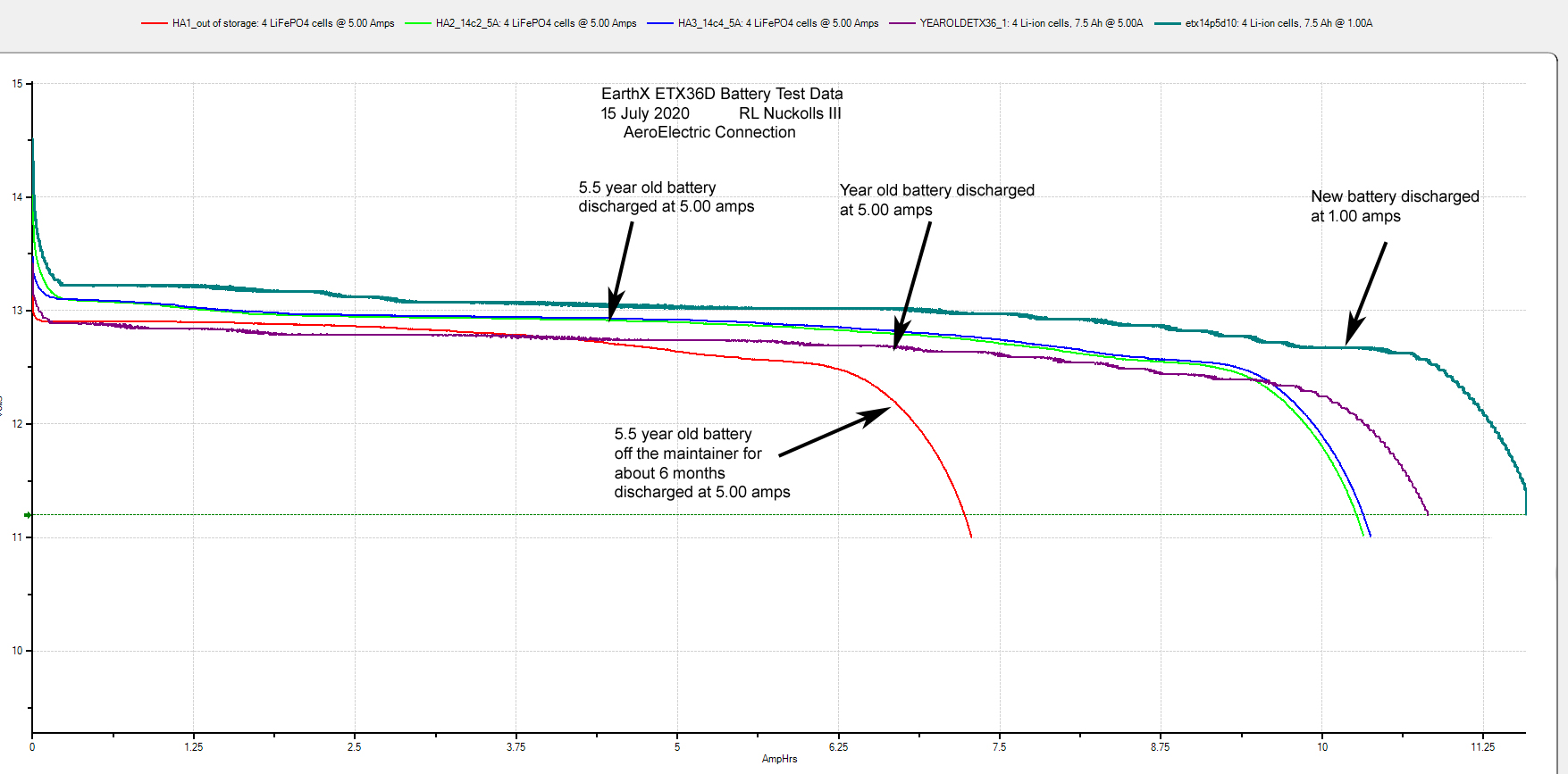

I mentioned last week that I'm gathering
some performance info on some LiFePO4
products.
I've got an EarthX ETX36D that was donated
to 'the cause' by EarthX about 5 years ago.
I've attached a plot of that battery's
condition at new, 1 year and 5.5 years
as a 'bench' battery. It has been used
to jump-start numerous vehicles . . . and
has spent probably 20% of its life on
BatteryTender Jr. maintenance. It's been
off-maintenance for about 6 months and
I plotted it's condition as-stored before
deep cycling it a few times.
I'll see if I can dig up the old load-test
data to compare with a retest this weekend.
