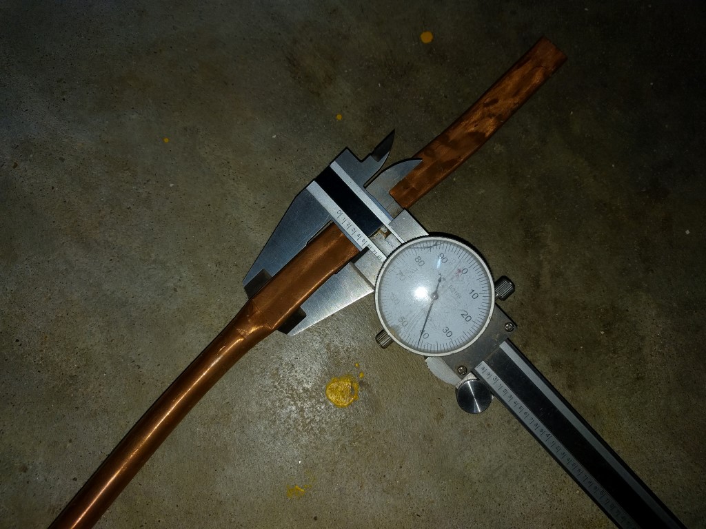

Art makes a good point.
But directly to your question, #4 wire area is 0.03268...sq in. .5 x .025= 0.0125 sq in. Brass conductivity is quite a bit worse than copper. So you'd have roughly 1/3 the area, and brass has 28% of the conductivity of copper, if the area was the same.
[url=https://www.bluesea.com/resources/108/Electrical_Conductivity_of_Materials#:~:text=Brass%20is%20only%2028%25%20as,7%25%20as%20conductive%20as%20copper!&text=The%20higher%20the%20%25%20IACS%2C%20the,C%20(68%C2%B0F).]https://www.bluesea.com/resources/108/Electrical_Conductivity_of_Materials#:~:text=Brass%20is%20only%2028%25%20as,7%25%20as%20conductive%20as%20copper!&text=The%20higher%20the%20%25%20IACS%2C%20the,C%20(68%C2%B0F).[/url]
Offsetting that is the very short distance for a bus bar (minimal total resistance).
However, a thickness of 0.065" would give you the same area, and a piece of 3/8" copper tubing (available at your local hardware store), when flattened, would give you a 0.54" x 0.095" bar.
Charlie

There are a couple more offsetting features of the bus bar. First, it is mounted away from everything else, so that air can circulate freely around it, helping dissipate heat. Second, it is an uninsulated piece of metal. It can get hot without damaging anything, in particular, it can get hot without melting insulation.
This is kind of a fun thought experiment but, unless you are going to crank and crank and crank your engine through that ground power jack and a set of jumper cables, I kind of doubt that the choice of a bus bar vs a #4 cable or even vs a piece of AWG 18 wire will make any practical difference.
Art and Charlie make excellent points. Another
possibility is to fabricate a 4AWG welding
cable jumper that's a 'bit too long' so that
it simply makes a graceful curve between the
studs.
The copper tube idea has been floated and
incorporated in projects here on the list
for decades. Copper is the bus bar material
of choice and you only need to flatten the ends
to facilitate joining at the studs. This
technique calls for attention to keeping
the two flats planar to each other.
My personal choice would be the welding
cable jumper. Easy to build, soft and
easy to work with. Does not conduct
mechanical forces between the studs.

I do try to put some variation of an 'S' curve in the flattened copper tubing, when I use that trick. Helps relieve flex stress in one direction, anyway...
Charlie
