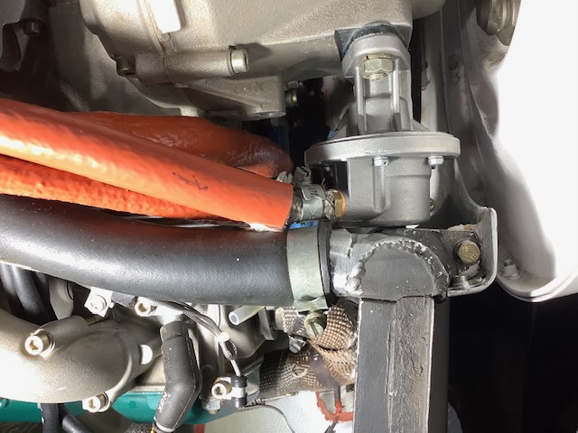

I think it is about time to change the mechanical petrol pump on my classic Europa. It looks like the new design Rotax pump will foul the right radiator. Does anyone have experience with this and if so what is the best solution?

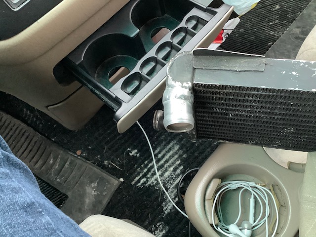

Indeed it does. I took mine to a local welder and had him put a 20-ish degree outboard angle on the outlet (?) to clear the new pump. The welding may have resulted in a fin leak, to which i had rectify using JB-weld epoxy, which is working effectively for now until i can source a new custom radiator.
Cheers and good luck!
