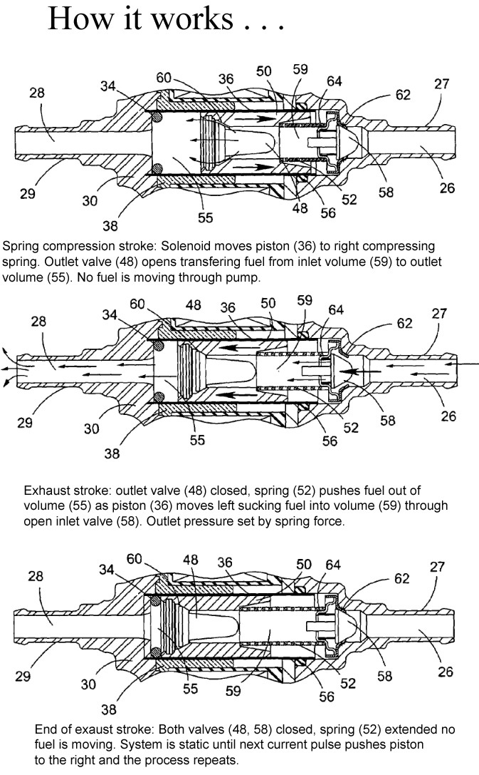

Does anyone know the power rating (or current consumption) of a Facet 40105 fuel pump when operating at the low pressure end of its range (3 psi)?
Thanks, Peter

The fundamental idea was to have a linear
solenoid compress a spring that pushed
a piston toward the pump's outlet port.
A pair of check valves would (1) allow
the piston to 'suck' fuel on the magnetic
stroke while compressing the spring and
(2) allowing spring force on the
piston to 'push' fuel through the outlet
port. There's an illustrated narrative
of this process attached.

PostPosted: Wed Jun 24, 2020 1:40 pm    Post subject: Current consumption of Facet cube fuel pump Reply with quote
Thanks All, I looked all over the interweb for quite a while and couldn’t find the answer!
Peter
