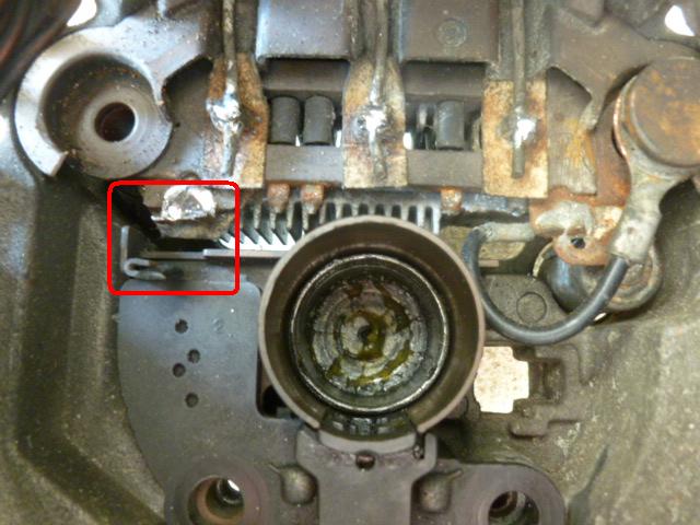

I modified the RX-7 Mitsubishi alternator (reman 14910?) to require external field voltage.
[img]cid:part1.C444B6EB.DBFCBAE3(at)verizon.net[/img]
Connection between three small rectifier diodes and the internal regulator unsoldered, regulator tab bent up and covered with heat shrink, just for good measure.
Very, very simple modification and the internal regulator is still used.

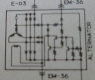

[img]cid:part2.35048761.458E805A(at)verizon.net[/img]
Sorry for they very poor picture from the Haynes RV-7 manual.
So, I feed the field winding from main bus, via a 5A alternator pull-breaker to the EM-36 spade terminal on the alternator.
After my OV crowbar blew up, I took a closer look and am now wondering if I should add a diode from ground to the EM-36 field winding terminal to curb any negative spike.
Normally, without the mod, any negative spike resulting from powering the field winding would be absorbed by the three small diodes and rectifier diodes going to ground.
And perhaps I should also a diode in series with the wire from the breaker to the alternator field terminal so a positive spike from the field winding won't trigger the OV module?
[img]cid:part1.5B93539B.AA7D8CFD(at)verizon.net[/img]
[img]cid:part2.2B2A573F.52F1A1E1(at)verizon.net[/img]
