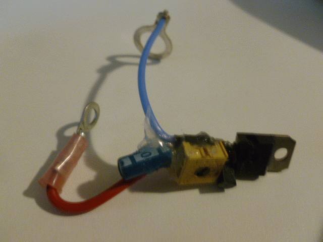

Happened to turn on master switch (relay) and saw smoke coming from the
OV circuit. (Made from the AEC9003-14A schematic more than two decades ago.)
I thought that was rather rude of it.
The SCR is the one that fried.
No problems many times before. Must have seen a spike from alternator
field winding.
But very worrisome that it did NOT pop the 5 amp W23-X1A1G-5 pull breaker.
The schematic specifies 20 AWG wires, and I used thicker -- perhaps 12
or 14, and very short, about three inches total for ground and + wires.
Maybe that was the problem?
Finn

Yeah, it probably opened the chip
bonds on the SCR before the breaker
could even respond.
The schematic specifies 20 AWG wires, and I used thicker -- perhaps 12 or 14, and very short, about three inches total for ground and + wires.
Yup. You'll notice that the z-figures
show crowbar ov modules at the end of the
feeder to the alternator field switch . . .
and wire sized more to the task of
supplying a 3A alternator field. 20AWG.
The W23 breakers are slower than the
miniature devices but this isn't a
show stopper if you limit the fault
current with judicious wire sizes and
lengths.
This limits trip current to some value
within limits for the SCR. I've had
customers install their AEC fabricated
modules right at the breaker on a legacy
bus bar . . . they even shortened the
factory supplied leads. Their modules
suffered the same fate the first time
they tripped.

PostPosted: Tue May 26, 2020 3:09 pm    Post subject: Crowbar let the smoke out Reply with quote
Exactly what I did. zip-tied (and siliconed) it to top of breaker, with very short thick wires to ground (ring around breaker mounting neck) and to breaker terminal screw.
[img]cid:part1.4C74E486.CF8A9B92(at)verizon.net[/img]
So, shorter and thicker wires is not always better Sad
This is a 60 - 70 amp alternator, so I figured would need at least 5 amps or approx 10% for field winding?
Not expecting to ever use that much current, but didn't want to pop the breaker in case of a nearly discharged battery.
So use 22 awg the 30" from breaker to alternator? And a bigger SCR?
Finn
