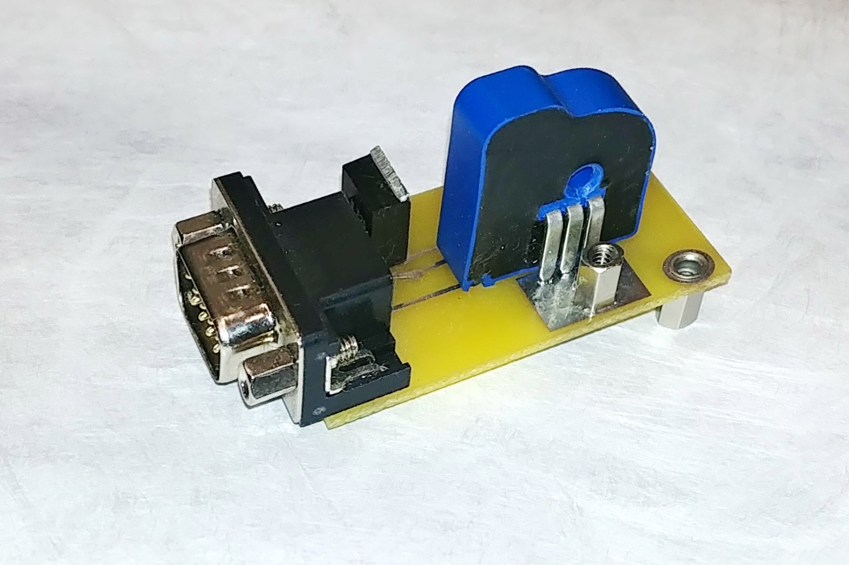

I have all but abandoned metallic shunts for current
measurement - especially when the millivolt data
is to processed in low level digital electronics.
We can revisit your shunt questions but I'll
suggest you consider this product:
https://tinyurl.com/yaxv58ax
These are closed loop, hall-effect sensors priced
about the same as the metallic shunts. Beauty
of these critters is total isolation, very
good linearity, repeatability and accuracy.
Best yet, one device can measure a huge
range of currents.
I stock the 6A version for about all applications.
I can run 5 passes of 22AWG wire through the
aperture and get plus/minus 1.2A full scale.
Alternatively, a single pass of 22AWG 1 foot
long through the aperture spliced in parallel
with 10AWG 1 foot long outside the aperture
gives me approx 10x multiplier for plus/minus
60A full scale.
You can situate the sensor local to the stimulus
of interest and extend the leads on a shielded,
twisted pair for direct interface with your
a/d converter. You don't need those high common
mode gain chips to do achieve an interface.
You WILL need some a/d ports to process your
hall sensor data.
I've acquired high quality data at the ends
of 40' leads in all manner of noisy environments.
The attached photo is one example of one
application. This board includes a 5v, 3-terminal
regulator enabling me to use the device
'barefoot' with a digital VOM at the observation-
end of the leads. For applications such as yours,
I'd probably solder a shielded pair directly to
the module pins and 'pot' the connections with
E-6000.

LONG time no hear my friend! Pleased to know
that you're still alive, kicking and curious!
