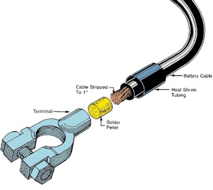

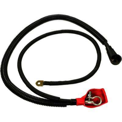

By the way, while surfing for a picture
of a two-wire battery cable, I found what
appears to be an aftermarket product for
replacing battery-post terminal-ends with
. . . who wuda thunk it . . . SOLDERED
attachement.
