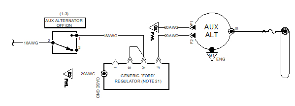

PostPosted: Sun Apr 26, 2020 11:51 am    Post subject: Alternator Mod to External Control Reply with quote
To: Roger&Jean <rnjcurtis(at)charter.net>
Subject: Re: Re: Alternator Mod to External Control
X-Attachments: C:\Users\User\Downloads\2 wire field.jpg;
At 08:19 AM 4/22/2020, you wrote:
Bob,
I didn't see any electrical diagram to show how the 2 new wires are connected to the system.
Roger
This particular mod converts the stock alternator
into a 'universal' field configuration and is
wired like this:
