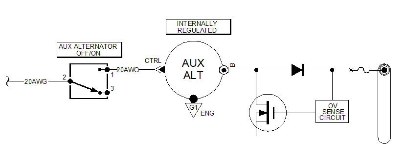

But FOR SURE . . . a fat-FET and diode would
be a piece of cake because there's no timing
to worry about and the b-lead never rises very
far given that it's loaded down by the ship's
battery. Best yet, no concerns for keeping your
contacts out of the fire.
For an AUX alternator in the 20-30A class,
the diode/fet crowbar need not be very
beefy. Maybe not so attractive for MAIN
alternators in the 60A+ class. Voltage
drop across the diode becomes an energy
management issue.

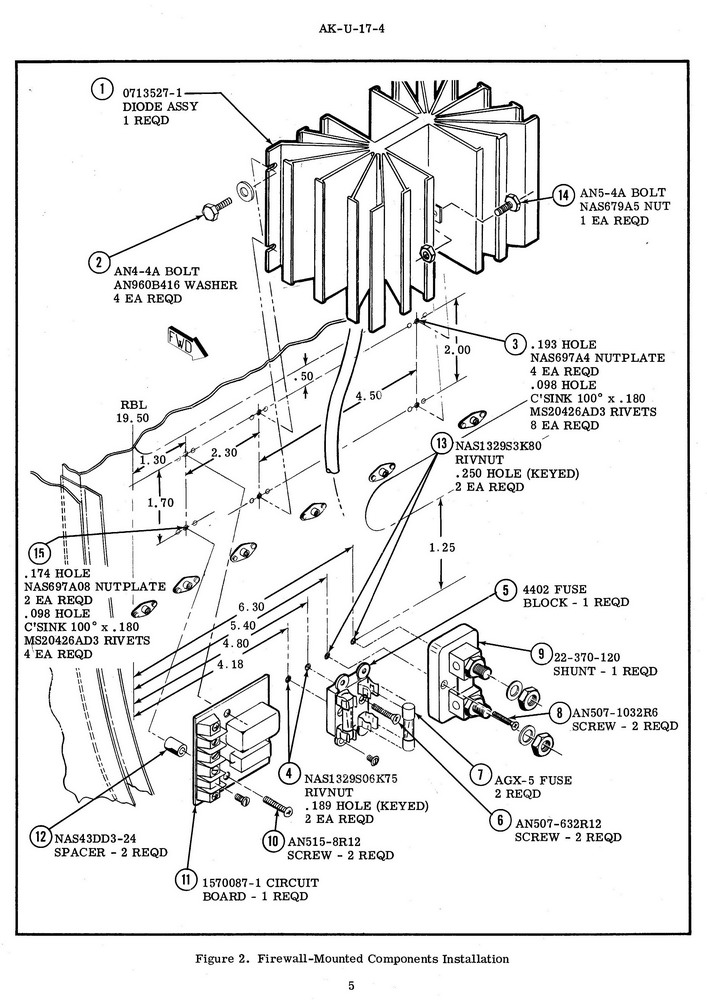

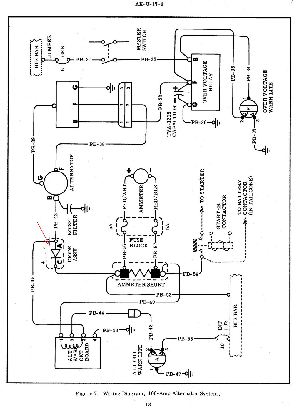

Here are some excerpts from a kit I wrote to
put a 100A alternator on a USAF U17. That
diode dropped about 0.9V at 100A for a
dissipation the order of 90W. Needless
to say, the heatsink was impressive. I
seem to recall we did a similar thing
on the C337. Had to dig pretty deep into
the archives for those images. Wrote that
kit in 1968!
A Schottky b-lead diode for a 30A alternator
would be much more manageable.

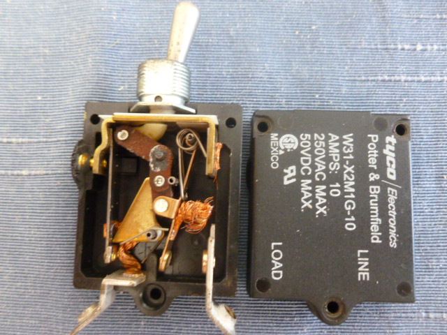

designing to electrical system accordingly. The manufacturer (RWS) of
the engine controller recommends engine-essential item be powered
directly from battery (via one switch/breaker). However, having
dissected a failed (open) W31- breaker/switch, I'll double that with a
pull-breaker, and have changed from switch/breakers to a fuse block.and
switches for pumps, injectors, coils, etc.

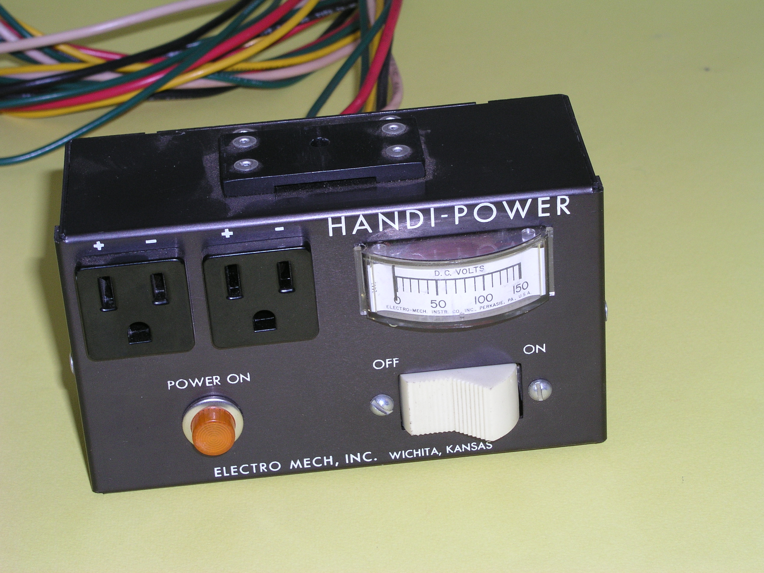

me consider putting a 80A "cube" relay in that path.
Waaayyy back in the dark ages, during the adolescent
years of automotive alternators, the rectifiers were
no so robust. I first hired into Electro-Mech about
1975. One of our products was a device you could add
to your alternator-fitted automobile to convert it
to a 100V dc power source to run lights and universal
appliances 'in the field'.
Worked okay most of the time but two many installations
on Chrysler products were popping alternator diodes
as a result of this installation. Had to do a messy
recall. 30 years later, after inheriting a house from
my father, I found one of these critters new in the box
out in his shop. It never got installed.
I suspect you could make this thing work
on any modern alternator. The diodes have "come
along way baby!"

failed (open) W31- breaker/switch, I'll double that with a pull-breaker,
Why any breaker at all? Yeah, I worked on the team
that wrestled with that same failure in nearly
the entire fleet of Bonanzas and Barons.
and have changed from switch/breakers to a fuse block.and switches for pumps,
Yup, they ALL want you to tie right to the battery.

  This is the special condition that might be
  handled nicely with a fat-FET and relay.
  . . . I'd want to do some studies on the
  alternator test stand before running very far down
  that rabbit hole.
  management issue.
  There was a time that Cessna was using
  some fat diodes in the alternator b-leads
  to orchestrate an alternator failure
  sensor some guy at Cessna dreamed up . . .
  not me!
  kit in 1968!

You need to wait until the contacts
were first break so that the FET wasn't trying
to crowbar BOTH the alternator and battery. This
is what makes the FAT diode isolator electrically
more attractive. OV sense and reaction becomes
a lot easier.

Is this the correct order for protecting the relay contacts? I would have thought that the FET should sit between the B terminal and relay, and fire *1st*, so that there isn't a high energy arc at the relay contacts. I'd expect the FET to be much faster than the relay, if the protection circuit could fire the LED at the same instant that it crowbars the CB feeding the relay (even without a microcontroller to do the timing).  Did I misunderstand the goal, or circuit arrangement?
  a lot easier.
Ah...yes. Forgot that the battery would try to drive the short.
Thanks for clearing my head. Smile
