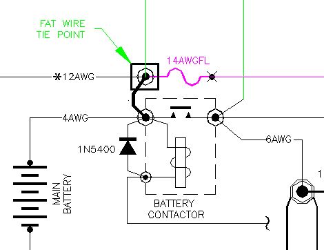

The attached figure is an excerpt from the
work-in-progress, Z01 architecture study.
In that drawing I have suggest an yet-to-be-
defined device for expanding the number of
wires that can be gathered together at
one contactor fat-wire stud.
I encourage exploration of modern options
for replacing legacy practices . . . that's
what Z01 is all about. But it's a good thing
to run new ideas up a very tall flagpole
before incorporating it into flying hardware
. . . especially for things that can have
a system-wide failure impact if not a risk
for fire if suffering a high-energy self
destruct event. Whisky-barrel contactors
are all metal . . . few modern designs
are so well confined.
