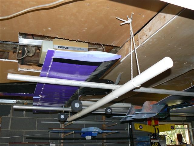

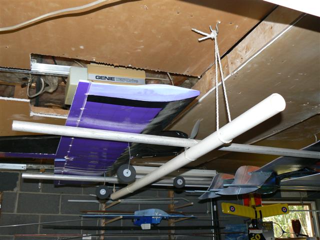

Richard,
Could you send some pics of your ceiling racks? I built some this weekend out of pulleys and 2x4's... it sort of works but it requires 2 peeps to oporate....
Mike
Nothing special, right now it just supports a bunch of RC planes. But since you asked... Each wing lays on two lengths of PVC pipe, on at the root, one close to the tip. For the one close to the tip, one end is tied to a hook in the ceiling, the other end is stuck through a loop of rope. Lift the loop to the side, and let the PVC hang straight down. The wife and I carry the wing into the garage, raise the wing up high, and I lift the root end up over and lay it on one piece of PVC.
Then I go to her end and raise/swing the PVC up, raising the wing out of her hands, and slip the loop of rope over the end of the PVC. Caution: don't slide the PVC along the wing, it will heat from friction and scuff the Stits.
Disregard the aluminum tubes and model airplanes in the attachment, all we care about is the white PVC pipe & rope. See? Nothing special.
