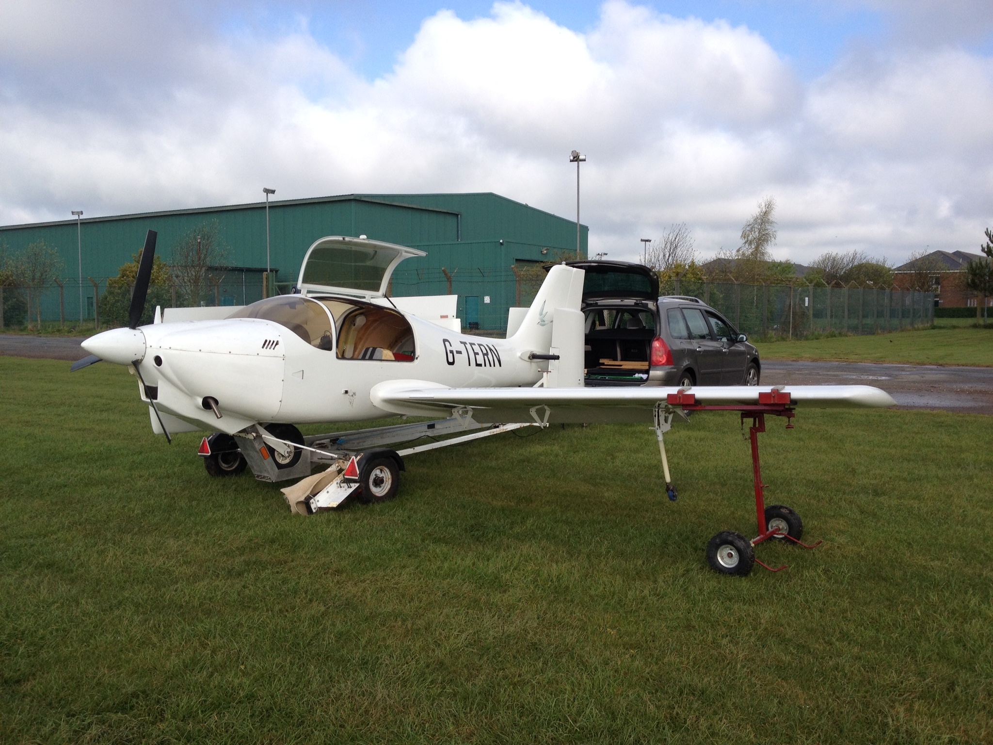

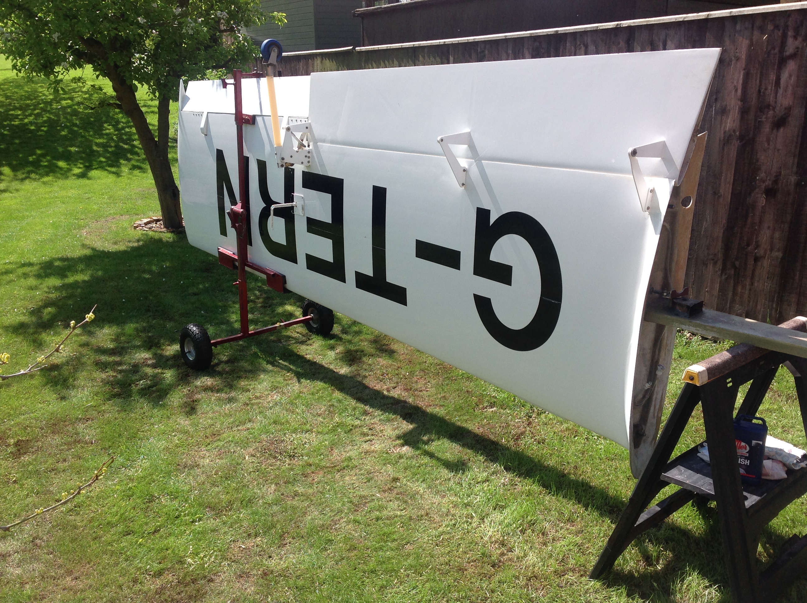

Hi Italian Jon, UK Jon here...! I solo-rig mine every time from a standard factory open trailer using a glider-style rigging aid/ trolley. The wing carrier on the trolley is pivoted to rotate the wing from the vertical to horizontal & VV. I lift the wing tip out of the trailer cradle into the trolley then wheel the wing around holding the spar end. When the wing is horizontal I stand to the rear of the spar and hold it with one hand on the spar and the other hand on the rear edge of the flap. Nice and stable to manage. I slide the spar into the fuselage using the spar guides for it to run along. I move the wing in as far as possible then go to the tip to push it fully home.

Another pic...

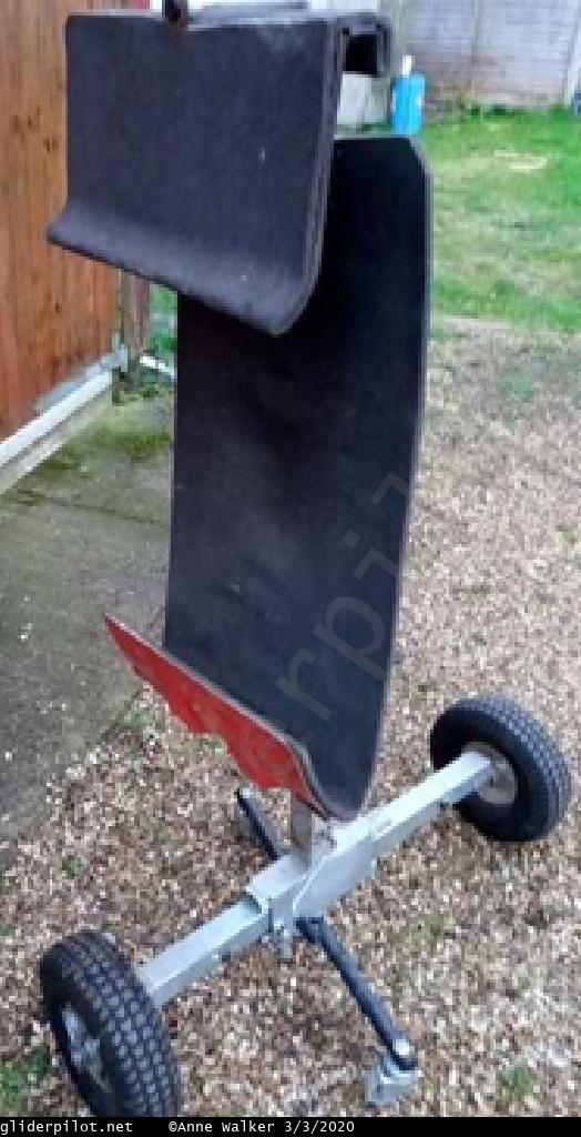

Hi ItaloBritJon! Sorry, I don’t think mine is any recognised make, it has a very “home made” look about it. I bought it about 17 years ago from a gliding friend who’d hurt his back and he’d bought it to help him rig his glider. His back got better and he didn’t need it any more.
However, historically many people do use such devices in gliding (I’m not involved in that any more) and also I’m think that there are probably a few other Europa owners who have similar arrangements. There may be gliding suppliers who sell them and they do occasionally crop up secondhand. As an example, below is a screenshot picture of one I saw advertised recently (dated Tuesday 3rd March) on the advert section of the gliding website www.gliderpilot.net.

Looks like this one https://www.cobratrailer.com/catalog/product_info.php?cPath=27&products_id=41&language=en&osCsid=a46rqh4feiuk14ji2f2a22sbe0 to me.
