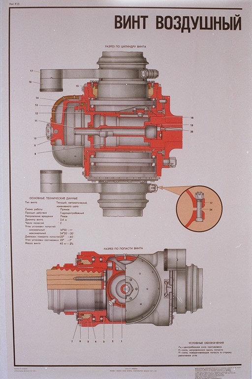

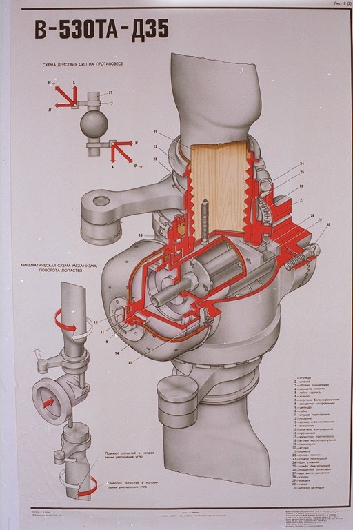

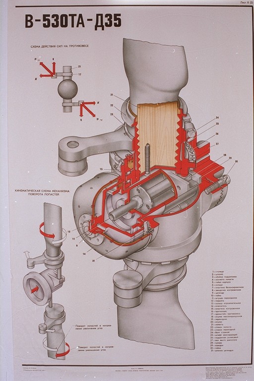

Anyone out there that might have a V530 prop hub manual with an exploded view of the hub they can send me. Purchased a Hub a while back and appearently, I'm missing some pretty important parts, but need to identify them first. Any help would be appreciated.
Thanks in advance

See if these will help Larry.
Dennis
| | - The Matronics Yak-List Email Forum - | | | Use the List Feature Navigator to browse the many List utilities available such as the Email Subscriptions page, Archive Search & Download, 7-Day Browse, Chat, FAQ, Photoshare, and much more:
http://www.matronics.com/Navigator?Yak-List |
| Description: |
| Filesize: |
98.48 KB |
| Viewed: |
770 Time(s) |
| Description: |
| Filesize: |
91.37 KB |
| Viewed: |
780 Time(s) |
