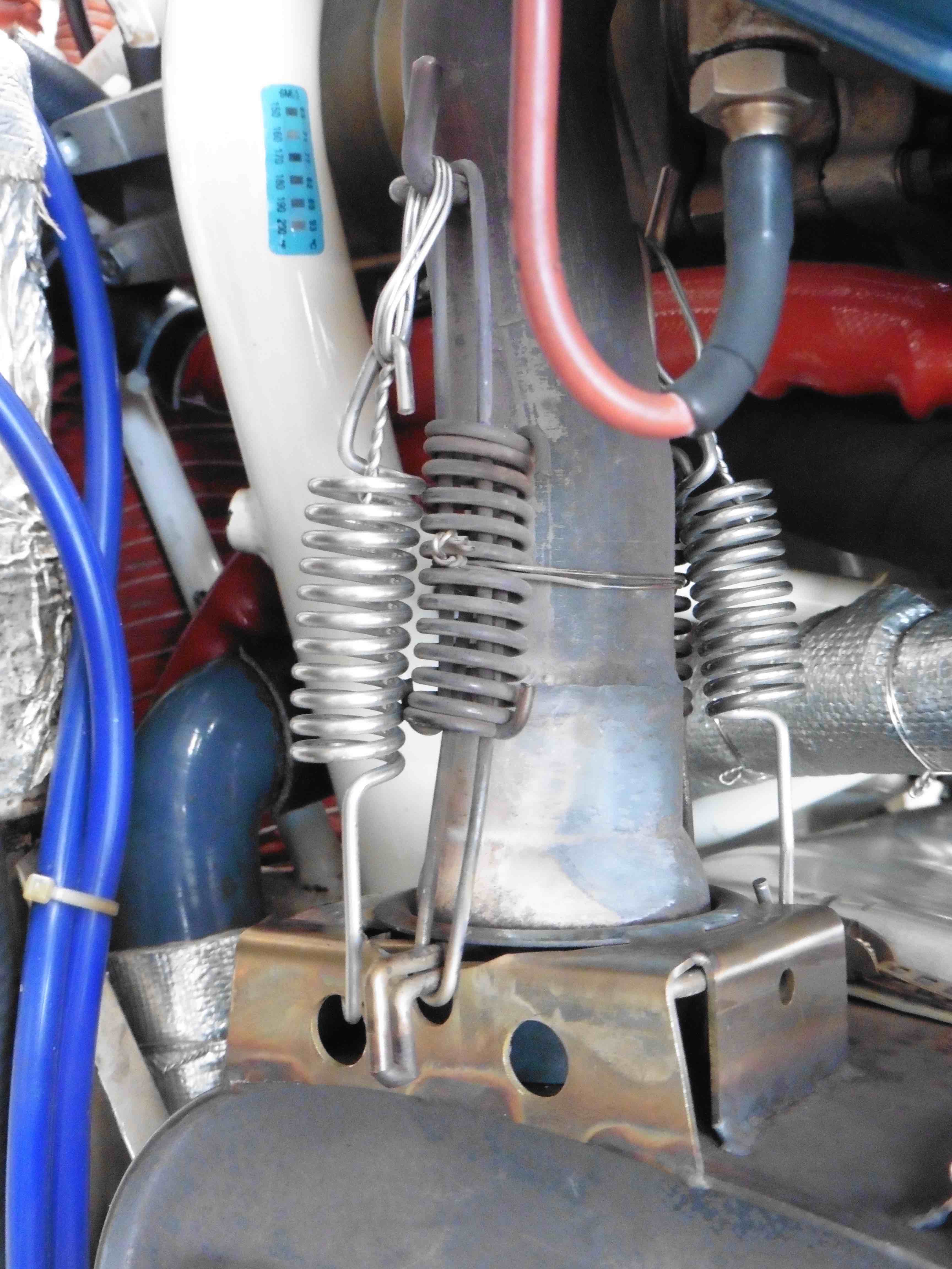

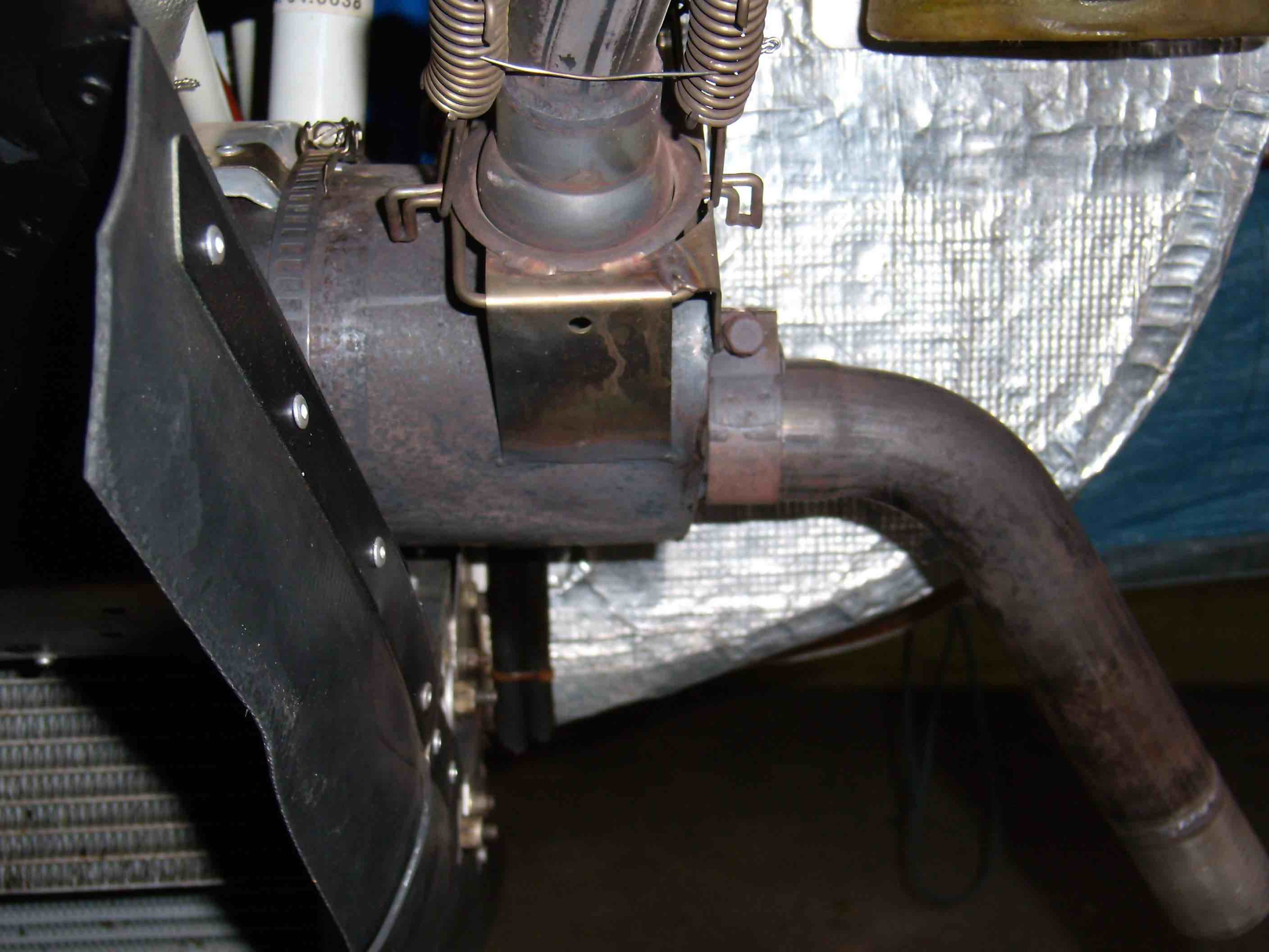

The CKT exhaust on my 912ULS has done 1300 hours without any spring failure so far. The springs are maintained by a safety wire loop which prevent them from vibrating, pic attached. However, I had a consistent leak at the spherical joint on cylinder 3 pipe. I solved that problem using 2 additional springs on that pipe to increase the pressure on the joint. The those two springs are attached using safety wire which allows to adjust the tension.
I believe that the use of 4 springs per pipe with properly adjusted tension could be a solution to also reduce the load per spring, therefore preventing breakage and increase redundancy.

Being inherently lazy and not wishing to try out all of your suggestions simultaneously, I'll start with Remi's suggestion which seems either to dampen resonant vibrations, or perhaps to divide each spring into two lengths with much higher resonant frequencies.
Many thanks to all of you.
