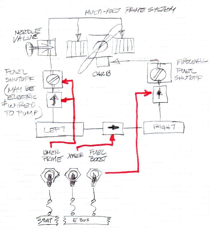

I suggested an alternative, no-valve,
all electric approach to fuel management
on canard-pusher aircraft.
[img]cid:.0[/img]
The suggestion also provided an alternative,
completely independent, fuel delivery system.
4-port primer systems were a functional possibility
for most Ez engines. I had recalled several
"I leaned about flying from that" stories
wherein a pilot brought his ship to a
comfortable landing using a primer pump
to keep the engine delivering useful power.
So why not install an on-purpose, primer/run
system? The pump driven, primer system would
feed from one tank, the main fuel supply from the
other tank. A third pump would transfer fuel
from the left tank to the right tank.
A needle valve in the primer line would be
used to calibrate primer fuel flow to approximate
that needed for 70% or so power.
Don't know how many of these system were
installed but I did get a report from
one reader that did a calibrated,
4-port installation and flight tested
it. He said it worked nicely. This arrangement
had a high probability of enabling a
graceful return to earth in case of
problems in the primary fuel delivery
system.
Light, cheap, low energy requirements and
completely independent of primary system.

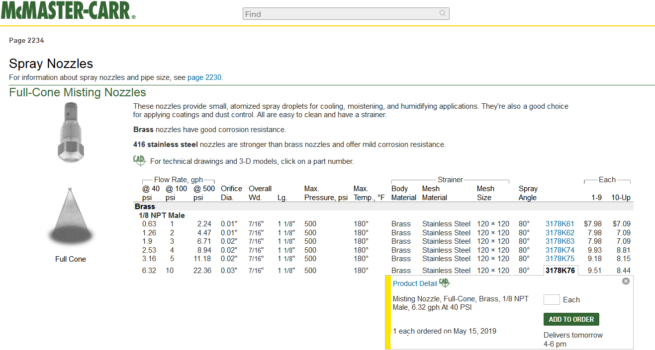

requiring a simultaneous failure of two alternators and battery failure, I've made my peace with the odds of losing both pumps to the nozzle (attached) mounted in intake plenum, teed into the recirc line,and controlled by a solenoid valve.
YMMV
