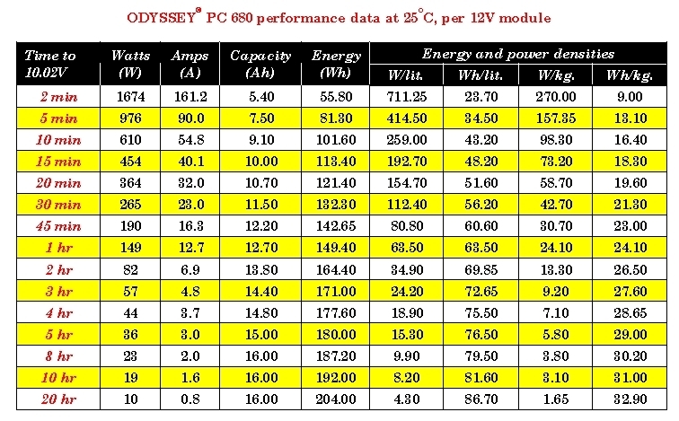

Here is an excerpt from an Enersys-Hawker engineering
data publication.
[img]cid:.0[/img]
No 'hat dancing' no undefined or vague terms. This chart
says that an off the shelf PC680 should deliver hard
values of stored energy depending on (1) discharge
rate or load and (2) condition of the battery [cap check].
In the course of our conversations, I sent a copy of this chart
to EarthX suggesting that until the aviation consumer
had this kind of data they were not serving their customer
well. CRANKING is one thing, ENDURANCE is quite another.
  data publication.
[img]cid:part1.4AE0F74C.B8F86A08(at)gmail.com[/img]
